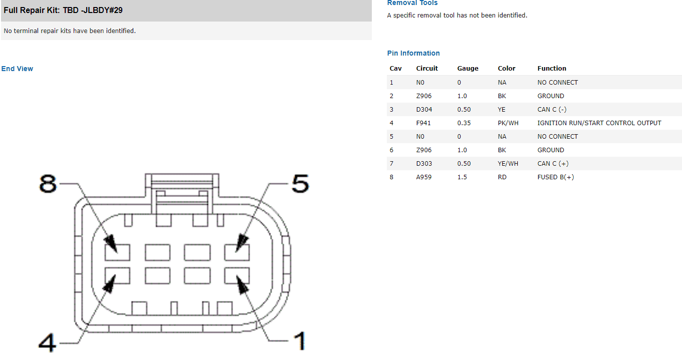

Interesting.. I read the Tazer manual and all the instructions are for "setting" parameters on how the sway bar disconnect operates.. I did not see any options to actually "disconnect" the electronic sway bar using the Tazer.. I have a 2018 JL Sport Unlimited and I recently bought a used electronic sway bar disconnect from a Gladiator model... I understand the complexity of getting the electronic sway bar to work on a basic JL Sport since the there is no provision on the menus to actuate the sway bar disconnect... nor there is a button to disconnect.. I am familiar with electronics and I see that the electronic sway bar is quite a complex device that can only be controlled via CAN Bus... there are few challenges in order to adapt an electronic sway bar disconnect to a basic Sport model:They will bolt in just the same, the challenge will be wiring but once wired, you can use a TazerJL to activate it on the dash and integrate it as though it were OEM. We make long travel links for Rubicon E-Disconnects that will allow you to stay fully connected and just use the push button to unlock the front end. http://rockkrawler.com/jl-rubicon-no-limits-sway-bar-links/
