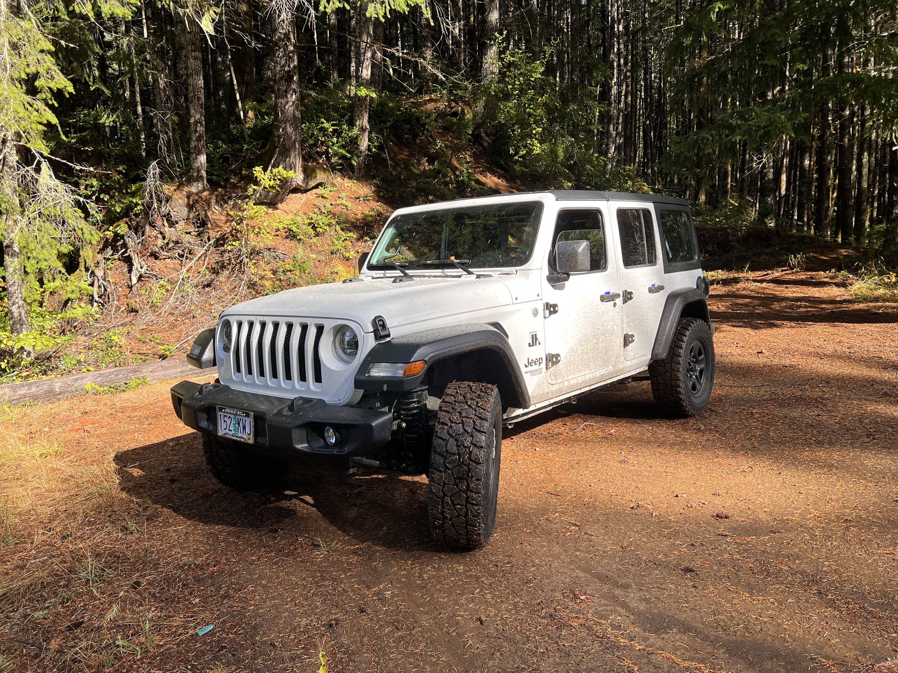

I was recommended to get the Rock Jock Sway Bar Kit which supposedly disconnects the sway bar “automatically” when needed so I guess my question is should I shell out the $700 (part alone) instead of getting one I can disconnect as needed?
I also have the 2.5” RC spacer lift and 2” wheel spacers installed. Other than that not much done to the suspension and it’s a sport unlimited. Really looking to increase flex so I’m not doing unexpected wheelies all the time ?
