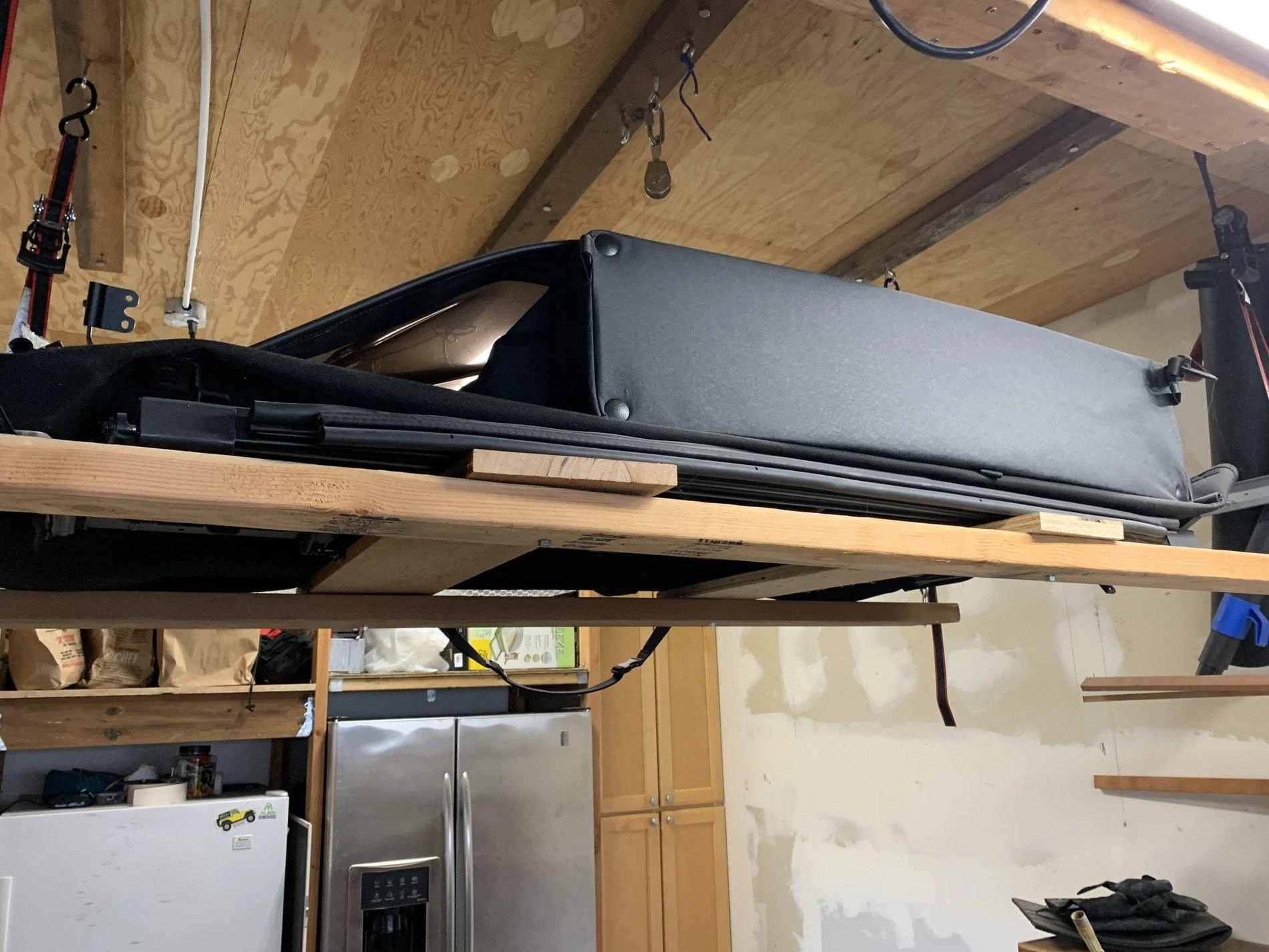

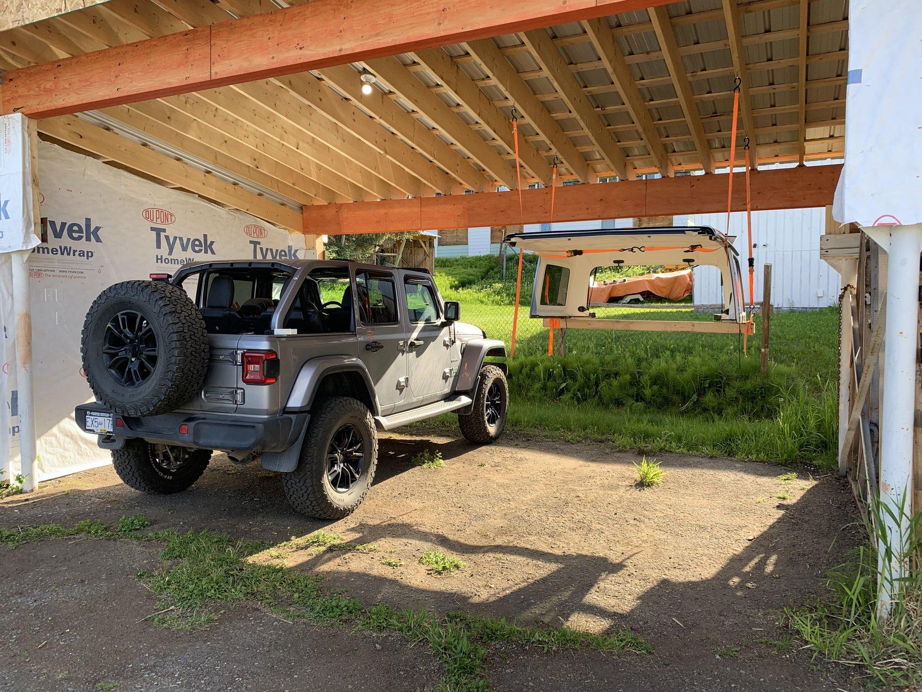

My solution for a small garage. Right now my Bestop Trektop is wintering over on my little rack. I have a Harken Hoist waiting for install. When it comes time to switch (soon I hope), the Bestop will come down to warm up in the sun, the wooden rack will be set aside, and the hardtop will be Harkened up. Then the rack will be ratcheted back up to take the weight of the top, and the freedom panels will sit inside, on the rack, in their bag. Everything up and out of the way. At least that’s how I see it now. LOL.

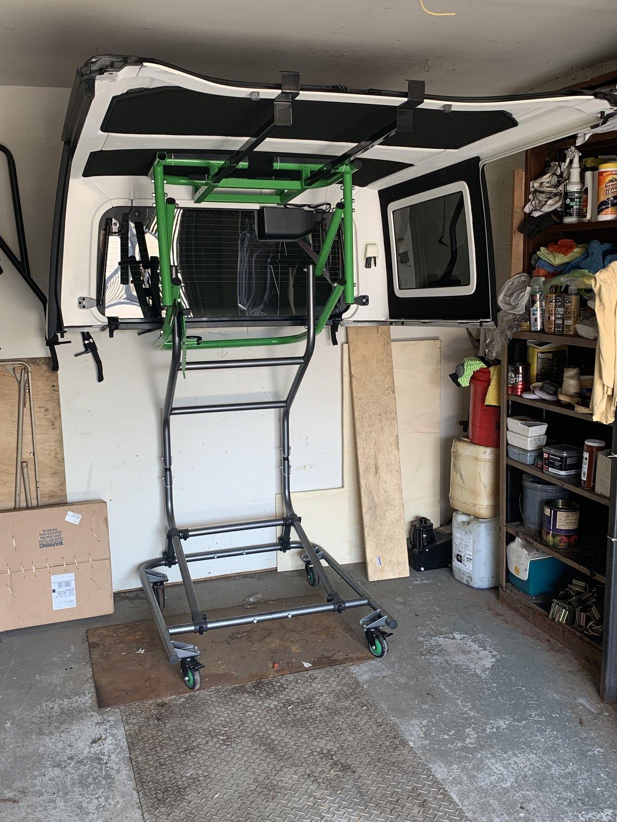

Here’s a pic of the Top Lift Pro in action if this helps.

If I get the gist of it, the only difference between the clearance of putting your JL into your garage with, or without the Top Lift Pro is about the outer diameter of the vertical section of the pipe between the back wall and front bumper--about an 1" or so...is that right?

Yes sir Andy, push the lift up to the wall, lock the wheels and you can pull your Jeep about 2” from the wall. You can also put your freedom panels in the bag and store them on your hard top.

How old is your top lift? My support rails have threaded support rail bumpers that I extend to support the front of the roof. Did you modify yours?

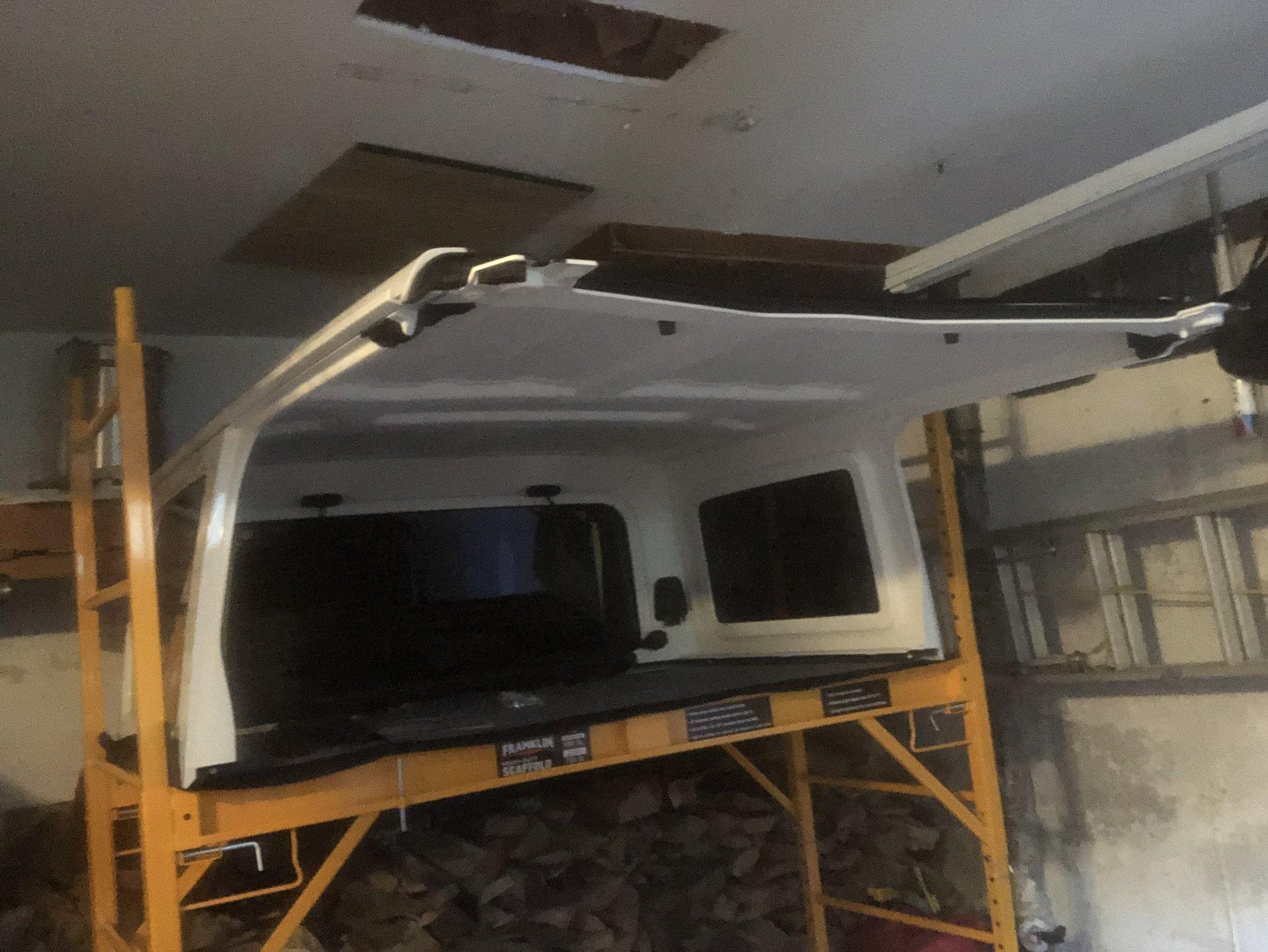

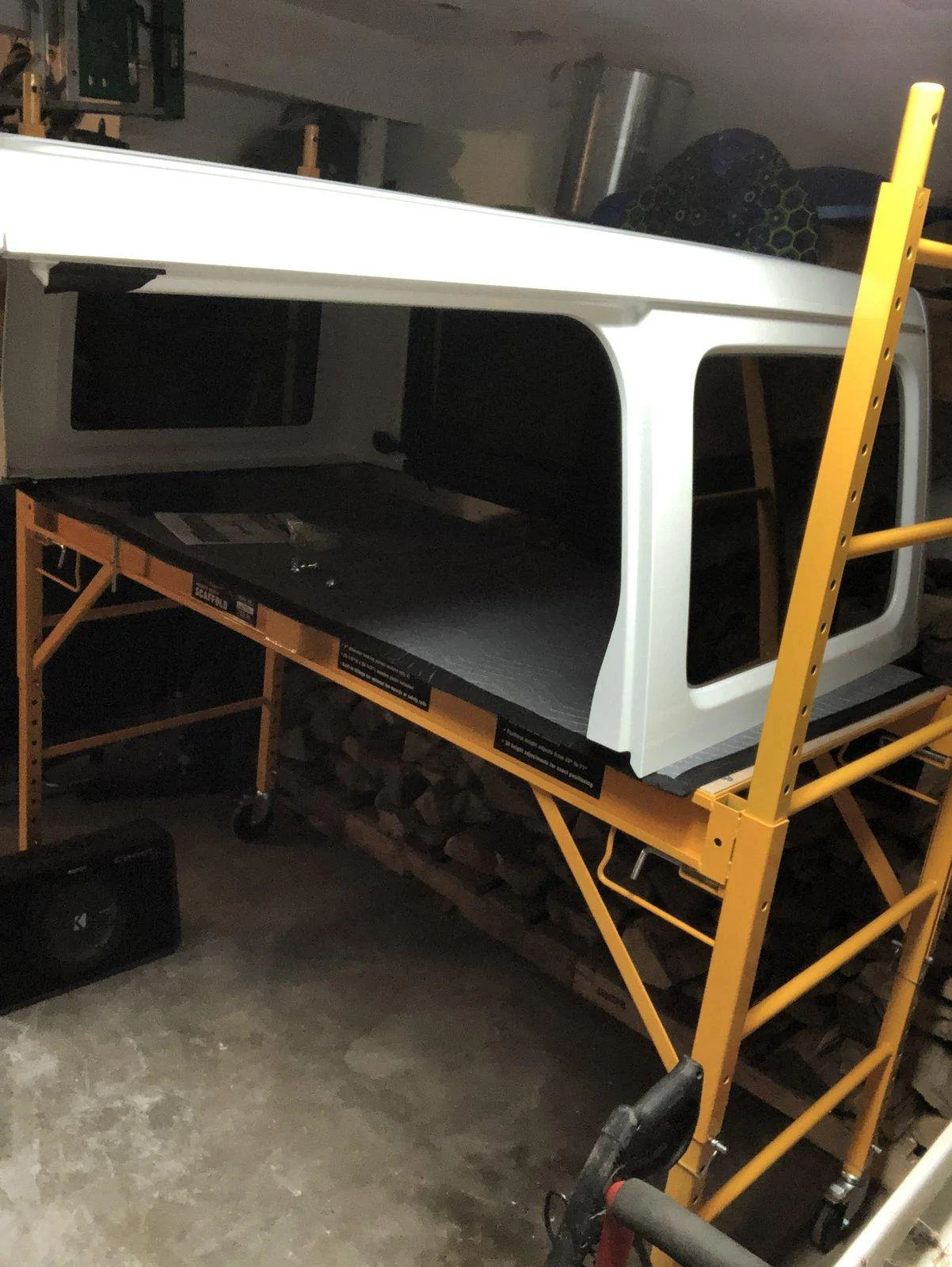

I just bought a 6ft scaffolding. I like how the top sits flat on its bottom instead of its back end also, and gives you more storage room for things under the top and under the shelf. It really depends on how much room you have. Our garage ceiling already has some overhead hanging shelves, and I didn't want to install a hoist up there too. However, it is a 2-person job to remove the top, unlike the hoist.
Seen here...
https://www.jlwranglerforums.com/fo...ardtop-storage-and-removal-works-great.29016/
I saw the same thing in another thread and happened to have three sets in my garage that I had purchased for a project at $150 each through Online Walmart. It's just wide enough to park the front end of my Porsche Boxster under it. Right now I have other stuff stored on it, but will be putting my hard to on it in another month or so when the weather is good enough to go topless for the rest of the spring/summer.

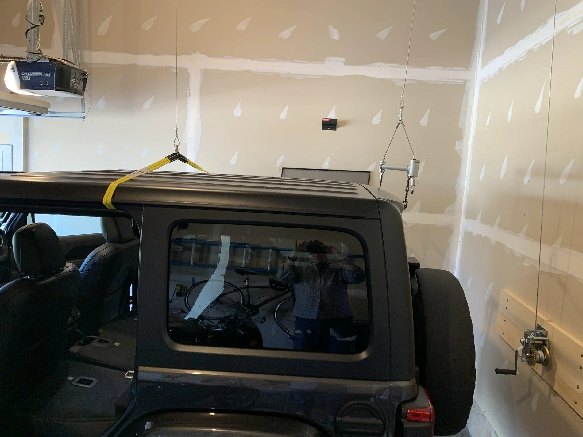

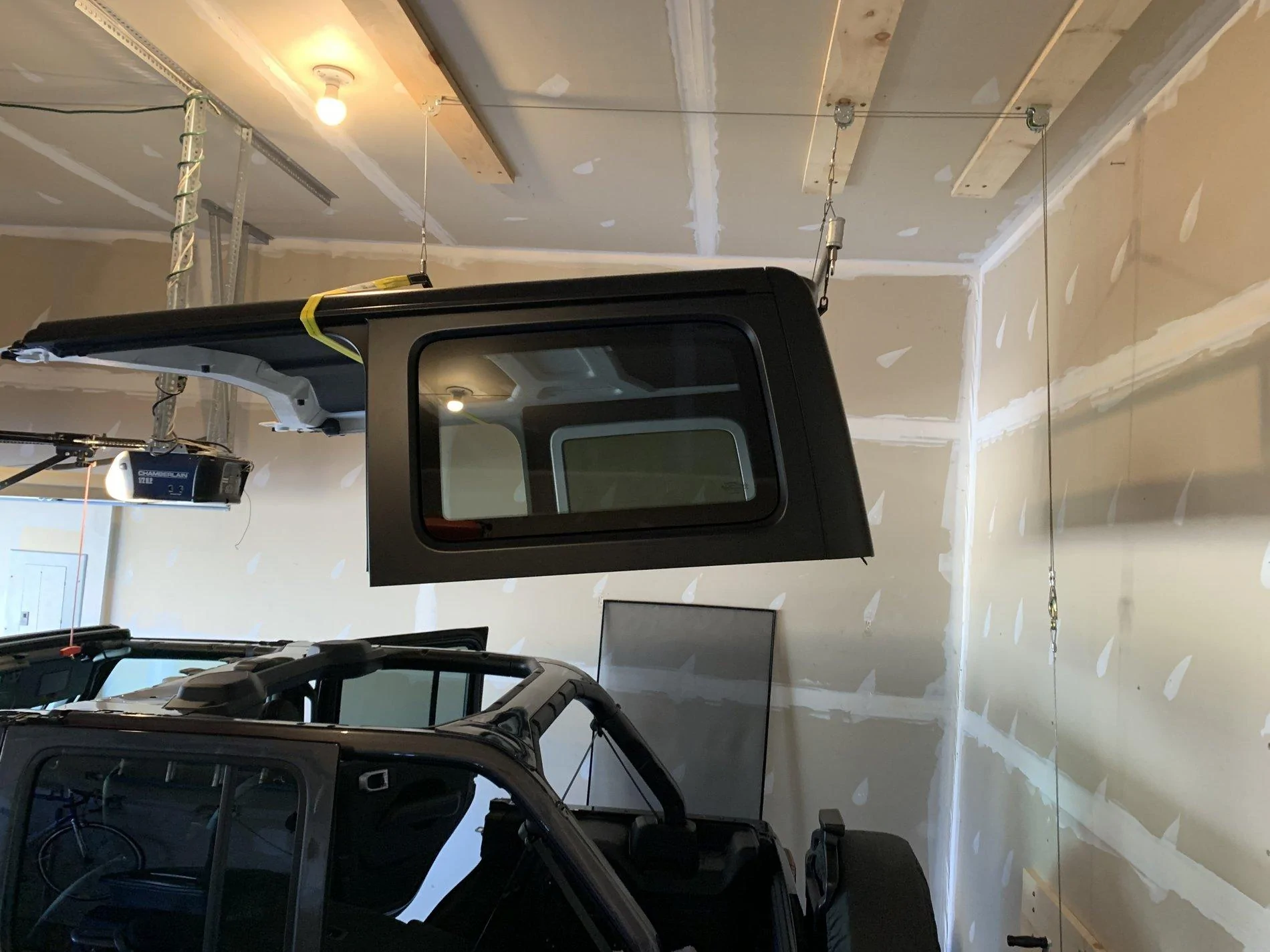

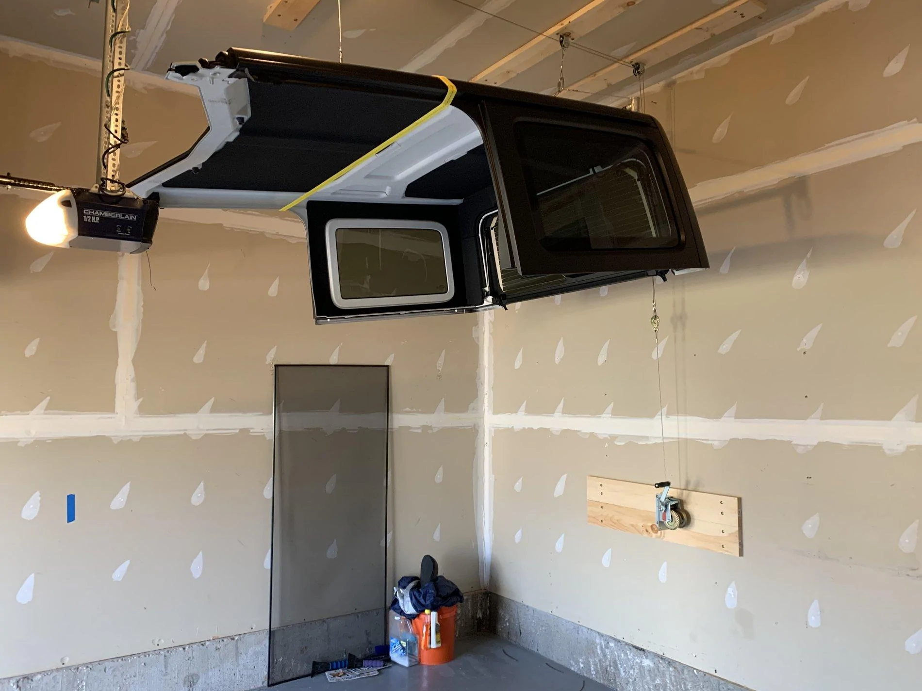

I built a hoist with a trailer winch, a lifting strap, steel cabling, and Topsy hooks. Whole thing was probably $120. Works great.

I do the same...... Take it off with my Top lift pro and leave it there until I'm ready to put it back. I haven't had any issues. It doesn't even leave marks in the headliner panels.

Scaffold works very well in the garage and Bride can park under it with zero issues. Wheels around smooth and top sits solid with minimal rocking unsecured.
I like this it could also work if you don't have a garage. We don't have a garage and store my hardtop on stacked pallets in the back yard but it's not as high as this.

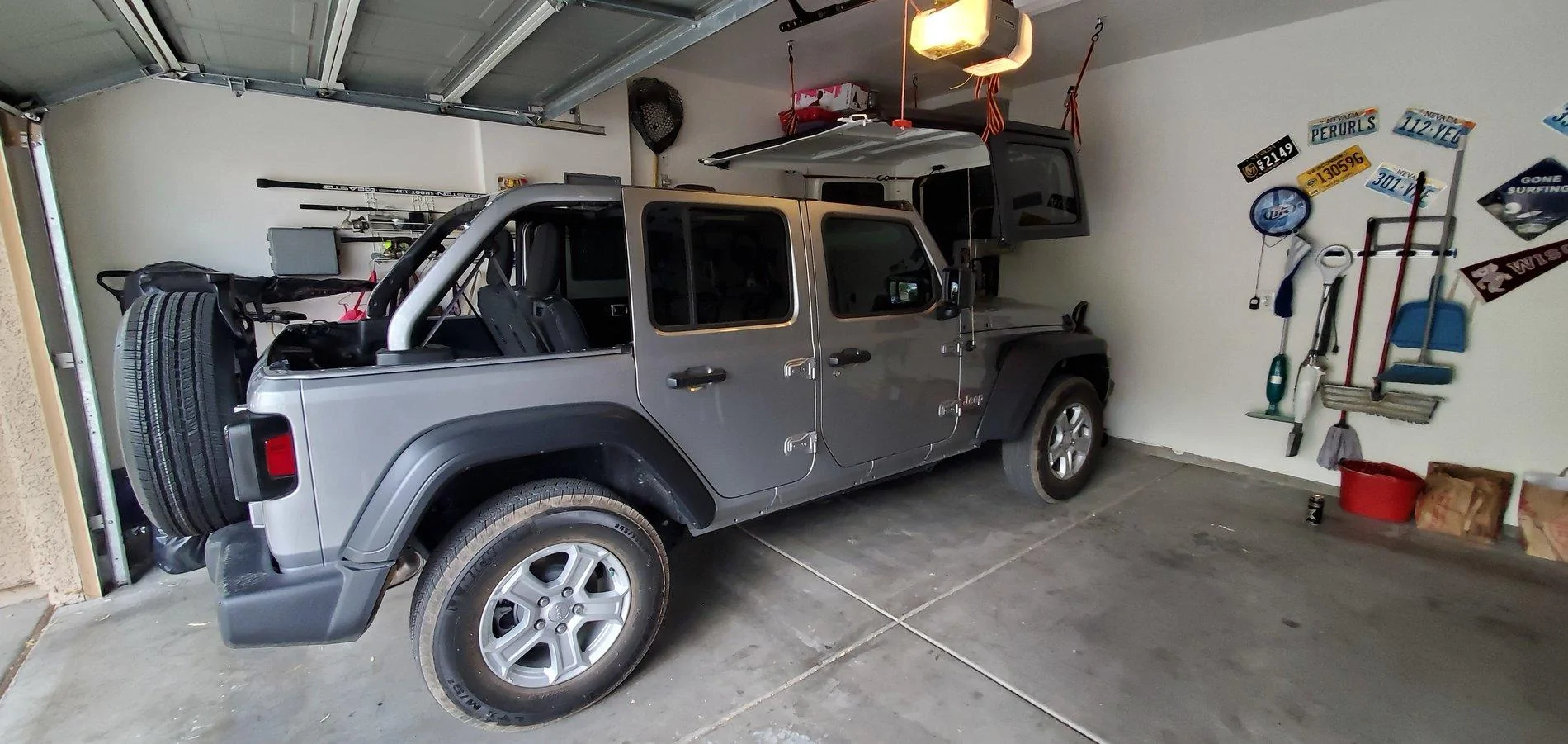

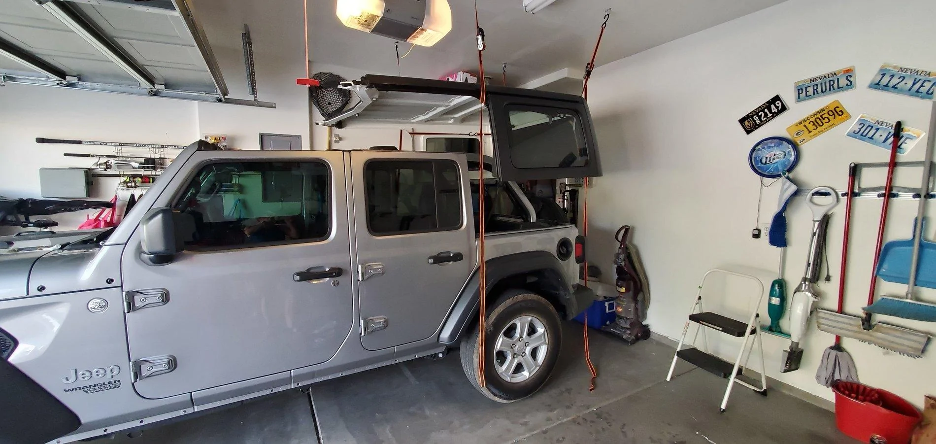

I just mounted d rings in the ceiling and used ratchet straps... works great. I do have topsy brackets for the back window to mount it to, but haven't installed them yet.
