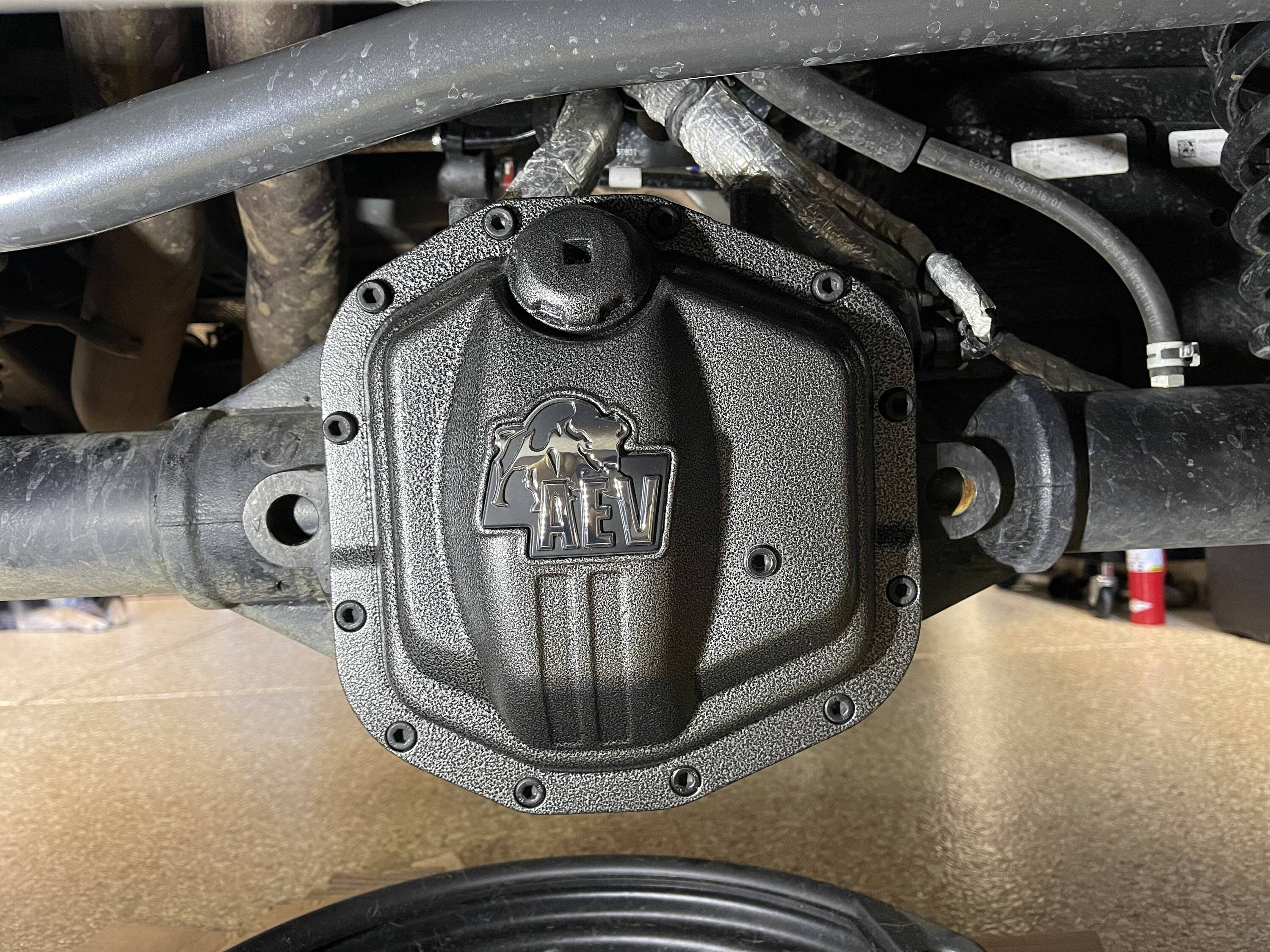

And yes, I have a fake made in China knock off fake clone Chinese 392 that has diff drains.
Mike, I can't tell if you are being sarcastic, funny, or truly have a different 392 Diff than we do. The problems with a forum I guess. You are showing pictures of an AEV cover....so funny? As Tank points out below we don't have drain plugs on the normal covers though.
Dude… there are NO covers with drains from the factory. That drain is IN the housing itself, not the cover.
Can you snap a quick picture of your diff? You may have a housing that didn’t have a drain machined into it.

Ok. So, you have no drain machined into the housing. It’s not the cover.
If you’re looking for a cover with a drain, again, it’s a terrible idea. Just take the cover off to service it. There’s no good solution to maintain a diff that doesn’t have a drain other than taking the cover off. For many years and for many customers, I would weld the drains shut. What you have is ideal. Drains are great, but not when the plugs back out offroad. Ask @mgroeger how that worked out for him. You’ll be putting your rig at risk if you buy any cover with a drain built into it.
If you really want a drain, just drill and tap that blank spot and add one. It would take 10-15 minutes to do and $10.
Thanks man but...you're an aviation mechanic. I'm not there. I can use a wrench just fine, but I am not drilling into a Diff. That's why I started this thread, because I want a plug and I wanted to know what other people used after-market. Sounds like ARB.
