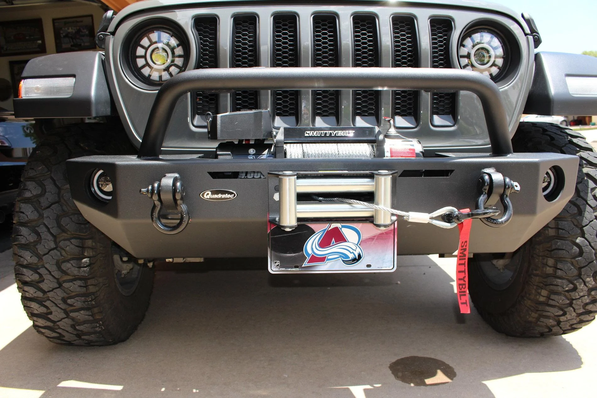

Quadratec QRC stubby~
Jeep Wrangler JL Stubby Bumper. Let's see them. IMG_0347
Jeep Wrangler JL Stubby Bumper. Let's see them. IMG_0352

How you liking this so far? Mine will be here Wednesday.
Love it! It's built very sturdy w/ thick plate steel and a nice finish, IMO about the best bang for the buck for a front stubby bumper. Those dinky fog light screws are a PITA to get in there though. I used some blue painters tape to keep the nut and washer together and then was able to get them both behind the bracket and thread the bolt in. After that it wasn't too bad, prior to that I was swearing like a drunken sailor :(
Look forward to your impressions.

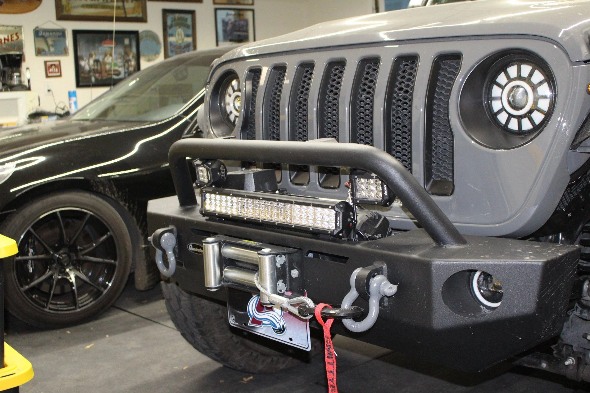

I drilled into the upper plate to mount this light bar, and used the lower tabs for the pods, worked out well & was able to keep a low profile mount for better air flow through the radiator.
Jeep Wrangler JL Stubby Bumper. Let's see them. IMG_0437

Did you try to remove the quadratec logo?
