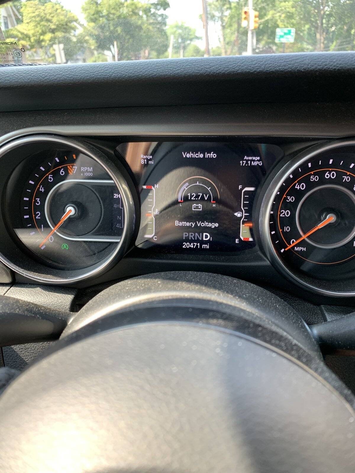

On this screen we can see the voltage display works just fine, and ESS is engaged.
Jeep Wrangler JL Stop/Start Screen BLANK - No Messages? IMG_3927.JPG

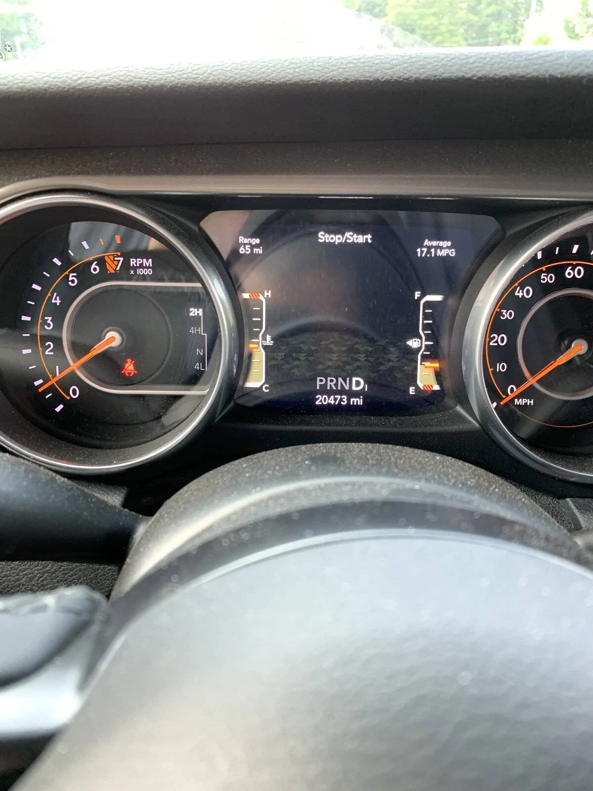

Here you can see it's in Drive, so I should have a message saying "Stop/Start Unavailable, Driver Seat Unbuckled" or something like that.
Jeep Wrangler JL Stop/Start Screen BLANK - No Messages? IMG_3928

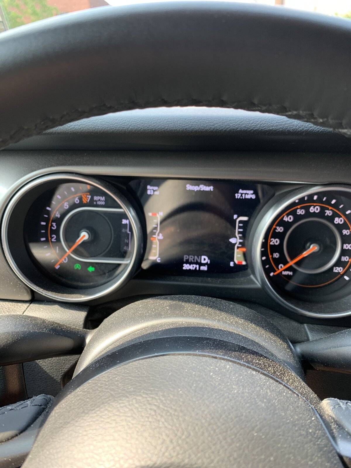

This one's a little blurry, but you can see ESS is engaged, and no message in the display.
Jeep Wrangler JL Stop/Start Screen BLANK - No Messages? IMG_3926.JPG

So far, the ESS system seems to operate as designed - it is activating at the proper times, restarting the engine without a hiccup, and the ESS override button also lights up and does its thing. The only thing we are not seeing are the messages related to the Start/Stop system in the display.
I know it used to display different messages - I had seen several times over the winter that it was too cold, another message for steering wheel turned too far, etc., but occasionally that screen would be blank like it is now.

So far, the Start/Stop display is still intermittent - sometimes messages will be there (all normal ones, like Active, Engine Temp Too Low, etc.), but on most drive cycles the screen is still blank. If anyone has a suggestion on where the Start/Stop screen gets its information from, I'd love to hear about it!
Battery voltage in the dash is showing 12.8v-13.0v steadily now. Previously, it was running in the 14.x range. From studying the various battery threads, I can assume this is because the OEM batteries were ready to be changed, and I'm glad we did them before we had trouble out on the road.
