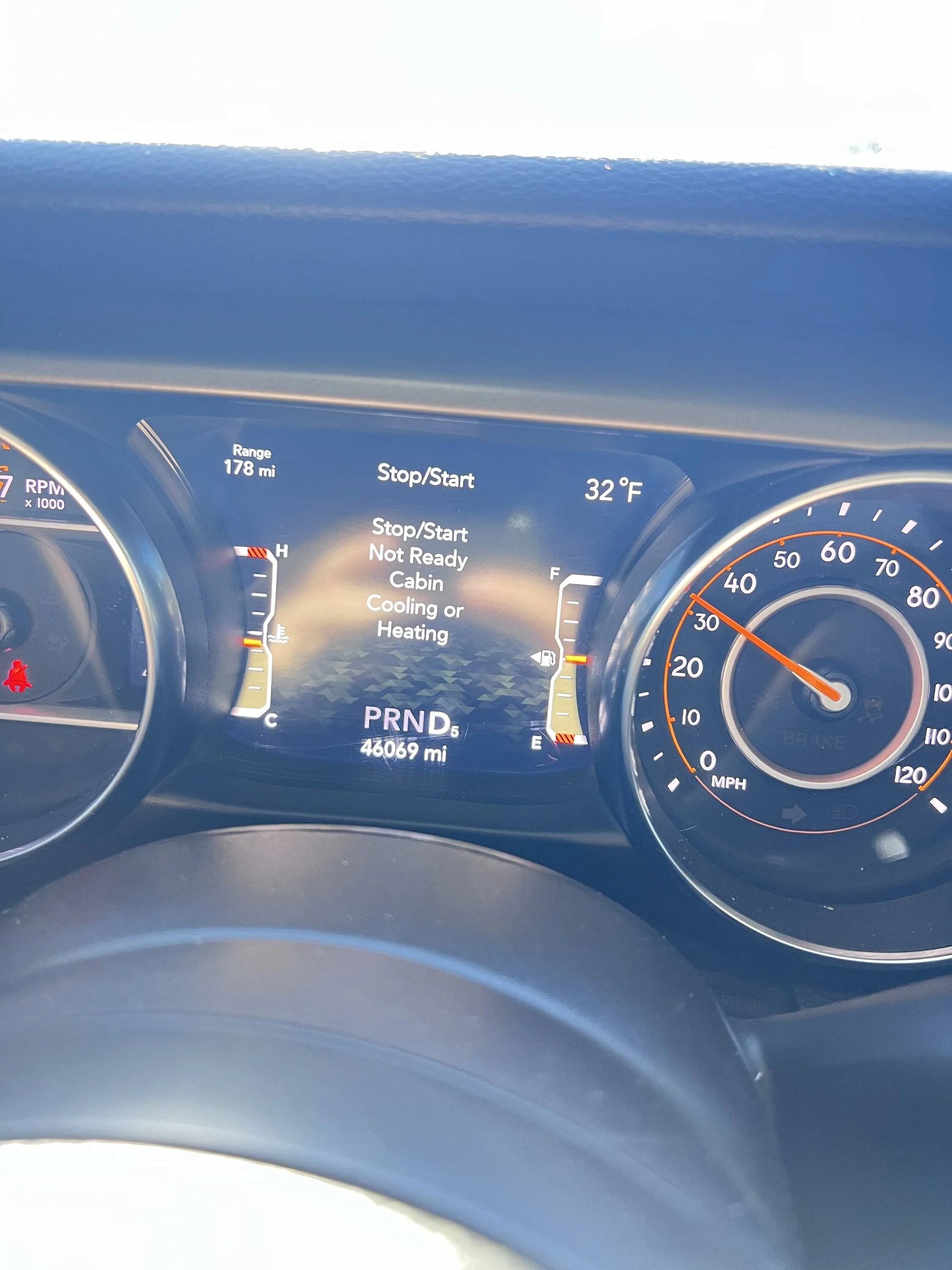

ESS defaults to ON after each start (light off), press button (light on) to disable ESS. Scroll through EVIC screens, should tell you why ESS is not working.

SBLACK502
Sep 21, 2021
267
386
Charlestown, IN
2021 Jeep Wrangler
It’s on screen 6
Light is off by default, but can push the button and it does light up as normal. Press it again and it turns off as normal. But the actual system never operates (had it for 5-6 weeks now and put a couple thousand miles on it). Never once has the Jeep shut off as it should. I'll have to check into what the EVIC screens are. First time hearing about this.
Jeep Wrangler JL Auto Stop / Start non-functional? IMG_5891
