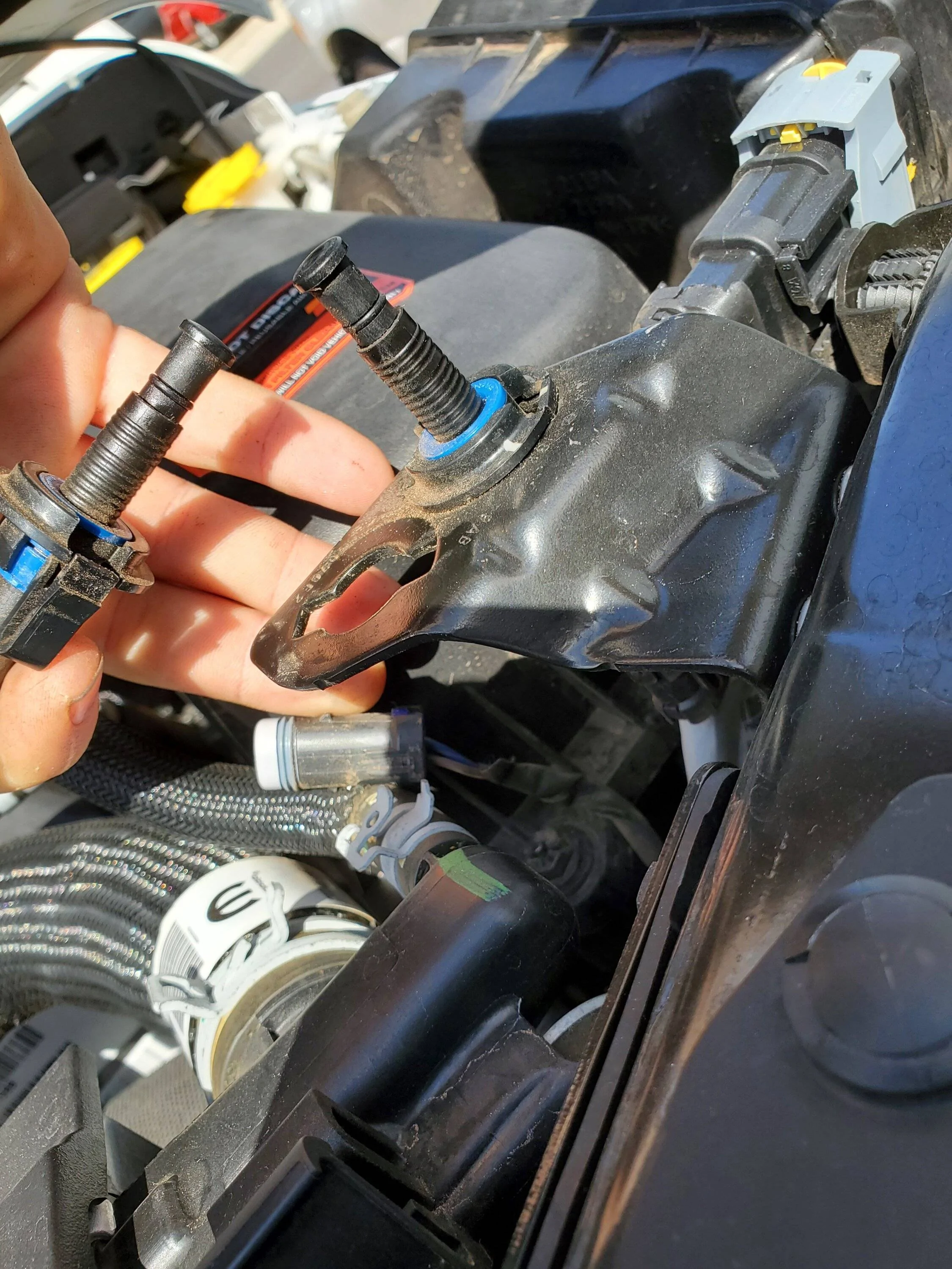

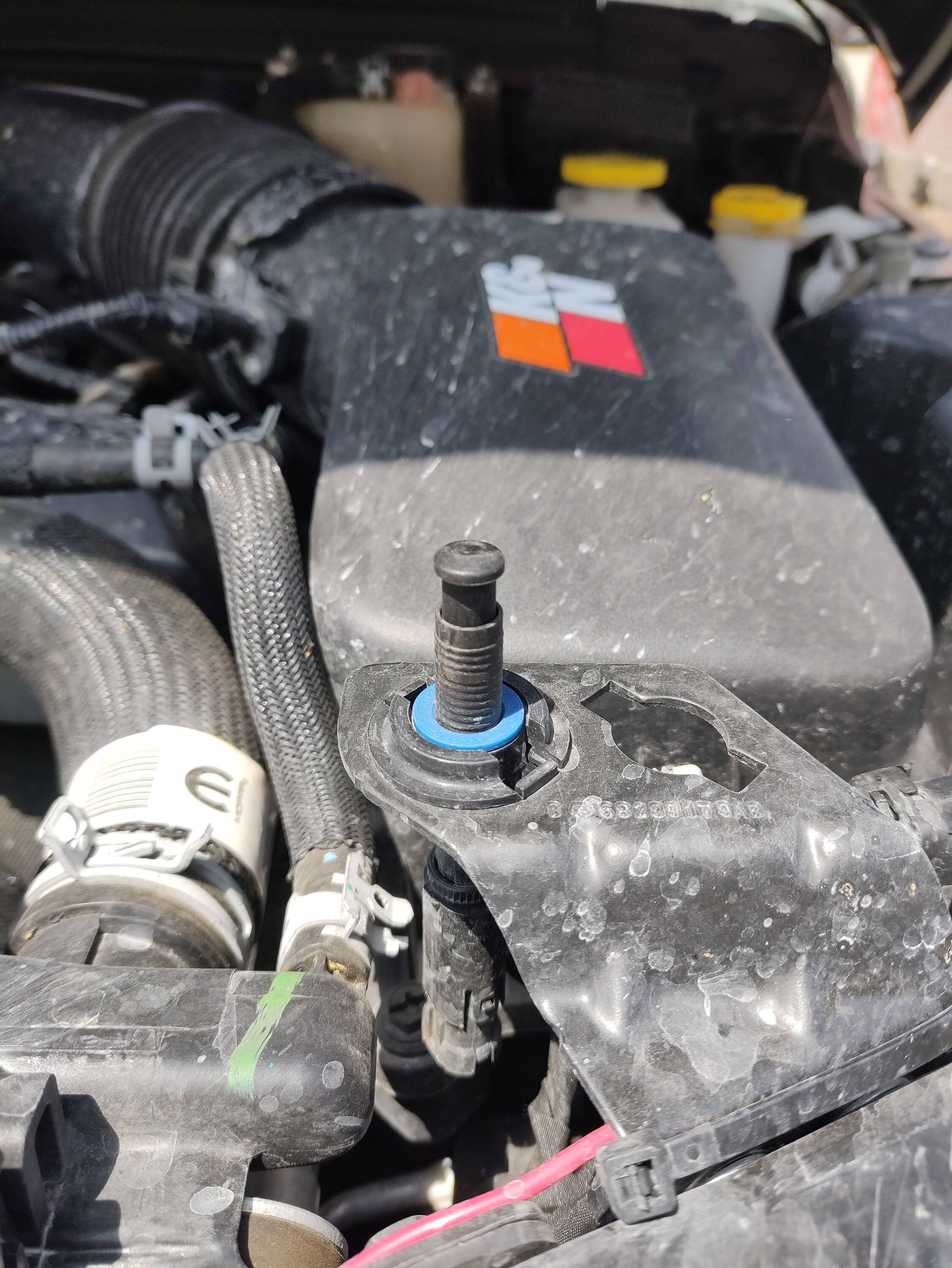

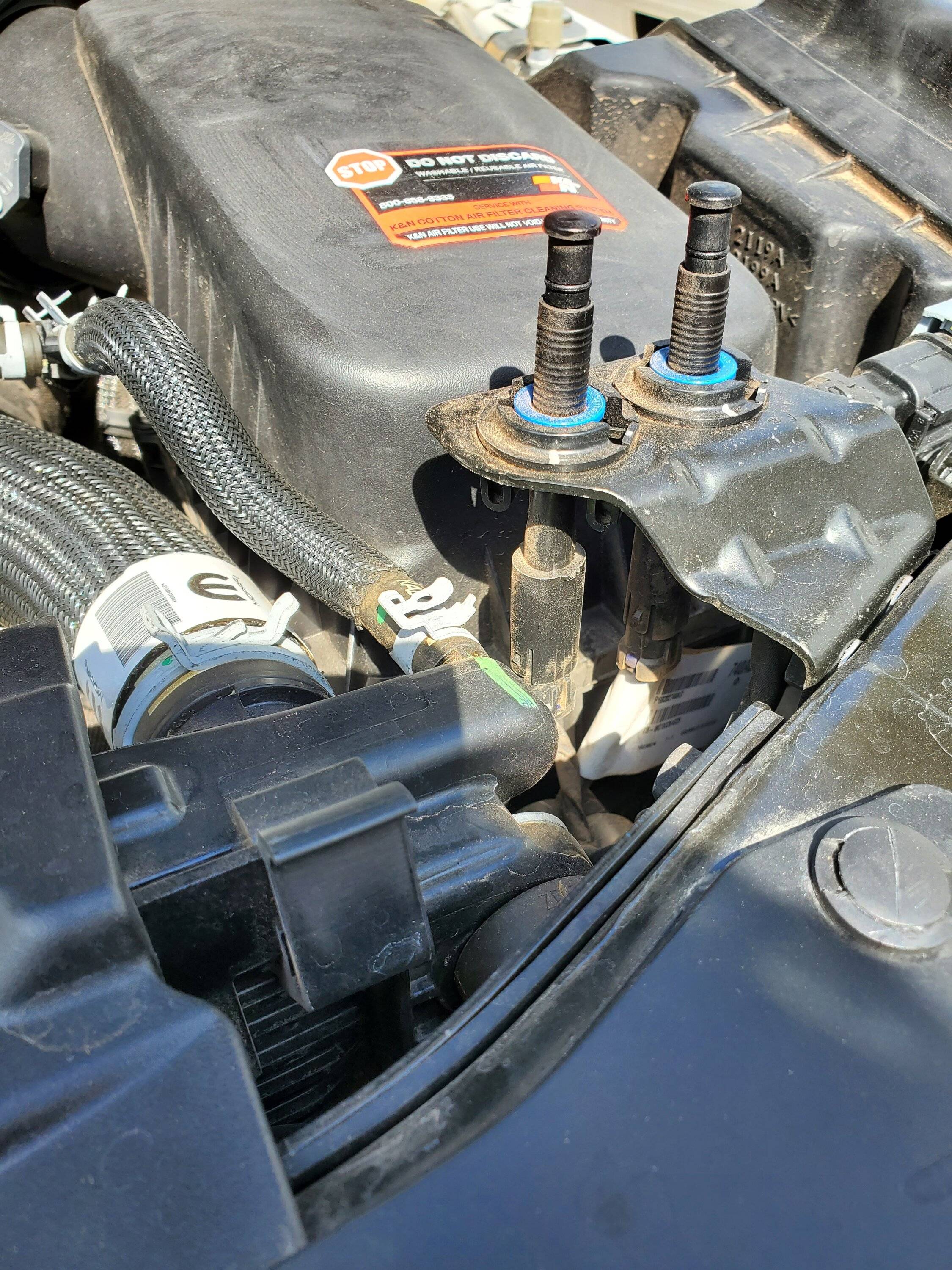

open the hood, there should be two push buttons near the front grill, both are black removing the bottom plug from one of the two will disable ASS until it is plugged back in. costs zero dollars

im unsure if this also disables remote start, because i don't have it in my jeep, just tape up the plug and go on with your day, i normally put the plug back in the hole so i don't lose it
Jeep Wrangler JL Auto start stop 20230506_100650
Jeep Wrangler JL Auto start stop 20230506_100700
Jeep Wrangler JL Auto start stop 20230506_100715
Jeep Wrangler JL Auto start stop 20230506_100744

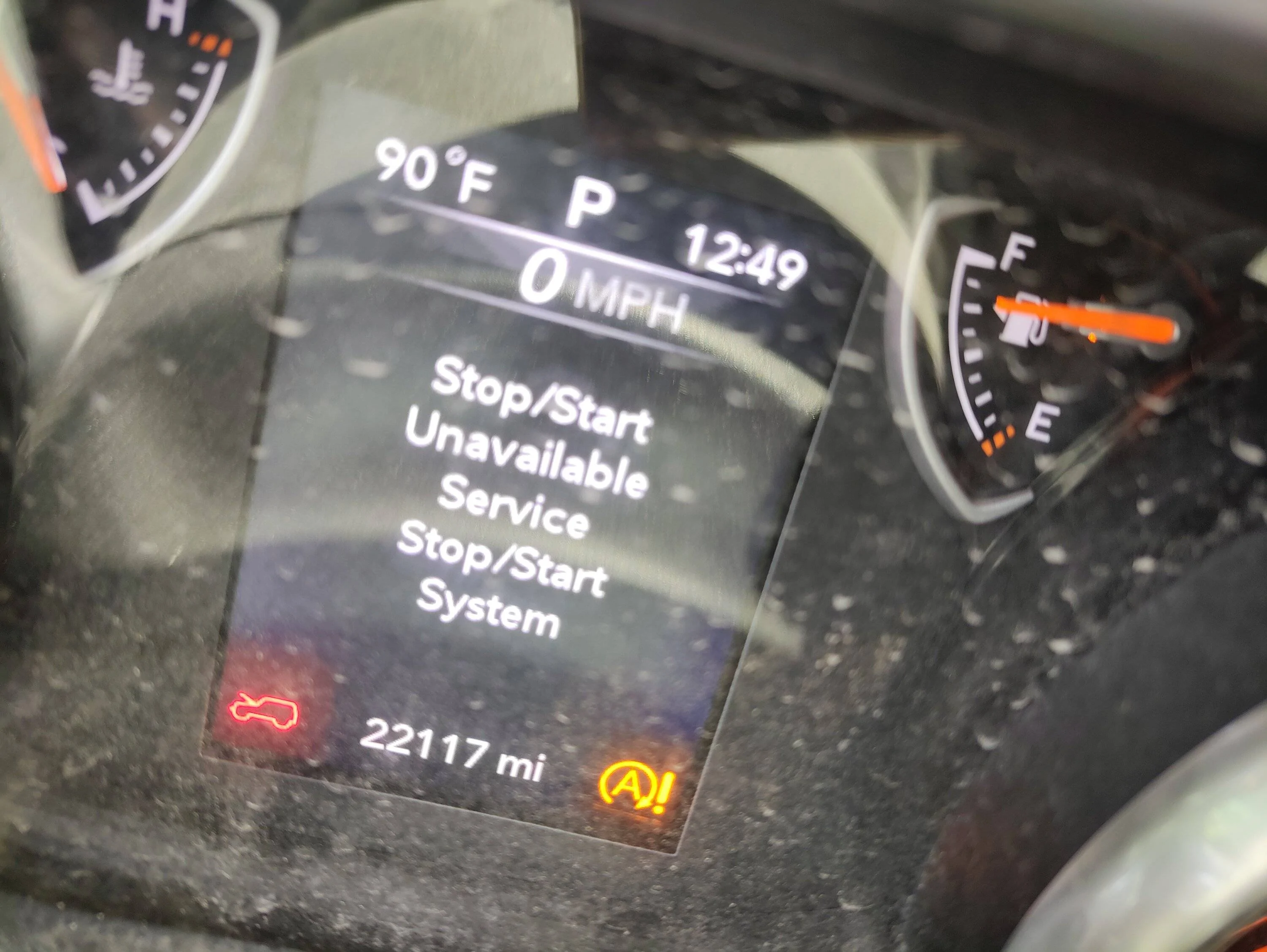

I took mine out second month of ownership. Had it out over a year now and the only thing that it does is every 10-15 minutes when you're driving it will ding and tell you your hood is open and start stop service is unavailable. Honestly I got used to that within the first 20 minutes of driving it. But if it's something that would bother you, you might want to look into a start stop memory connection or something like the tazer JL has a memory portion as well I believe.
