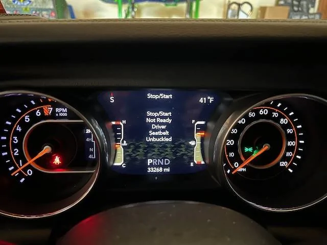

The wife recently picked up a 2022 JLU Sahara about 5-6 weeks ago. 29k miles, 2.0. One thing we've noticed is that the auto stop / start isn't functional (I'm not complaining, but it is odd). You can push the button and it lights up like normal, but it doesn't actually do anything and the Jeep never auto stops / starts at any point no matter whether the button is pushed or not. I've looked into several things (wearing seatbelt, sensor under hood, etc), but none check out. Anything else to check to make sure there isn't something physically wrong?
If no cel or message. I would think it has a stop start eliminator. Under your dash. Nothing wrong with this

2019JL. Mine recently stopped working and I get a alert on the dash saying it needs to be serviced.

Great summary. The only thing is AFTER the 1st jump, the ESS light on the dash came on. The NEXT jump, the Jeep started and the light stayed off. Never illuminated again. Stop start message is constant.
