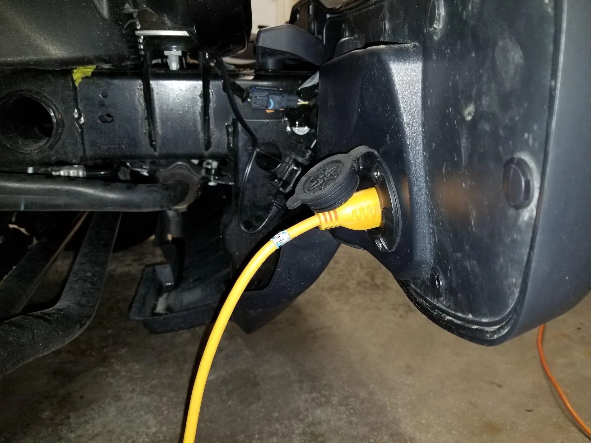

I had this issue until I put a trickle charger on my Jeep for a few hours, since I've done that I haven't had any issues.
There are so many very good inexpensive battery chargers on the market today,
