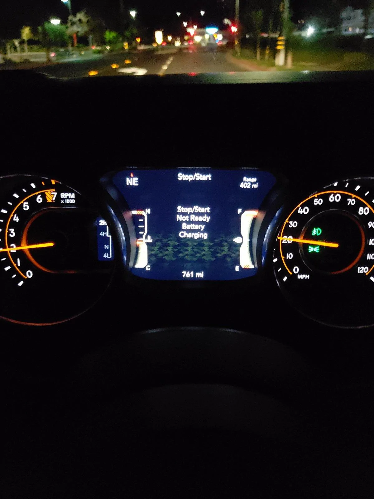

Perhaps Martin your (assuming 3.6L) JL has adequate ESS/Aux battery power to crank, just not enough to meet the threshold for your JL to allow you to enter into an ESS start stop event when your foot is on the brake and in Drive (automatic) when all other conditions (e.g. warm engine) have been met for an ESS even to take place.
I'd have the JL's ESS battery looked at and consider placing the vehicle on a trickle charger when it is as rest to see if this condition goes away. You can place the charger's leads on the main battery. Both batteries are connected in parallel when the 3.6L is parked so both batteries will feel the effects of the charger.

It seems like some emissions BS, on the freeway with right foot to the floor the voltage hovers at 12.7, them goes up to 14v when i coast. Trickle charging makes no difference, tried it at least 6 times prior to road trips.
