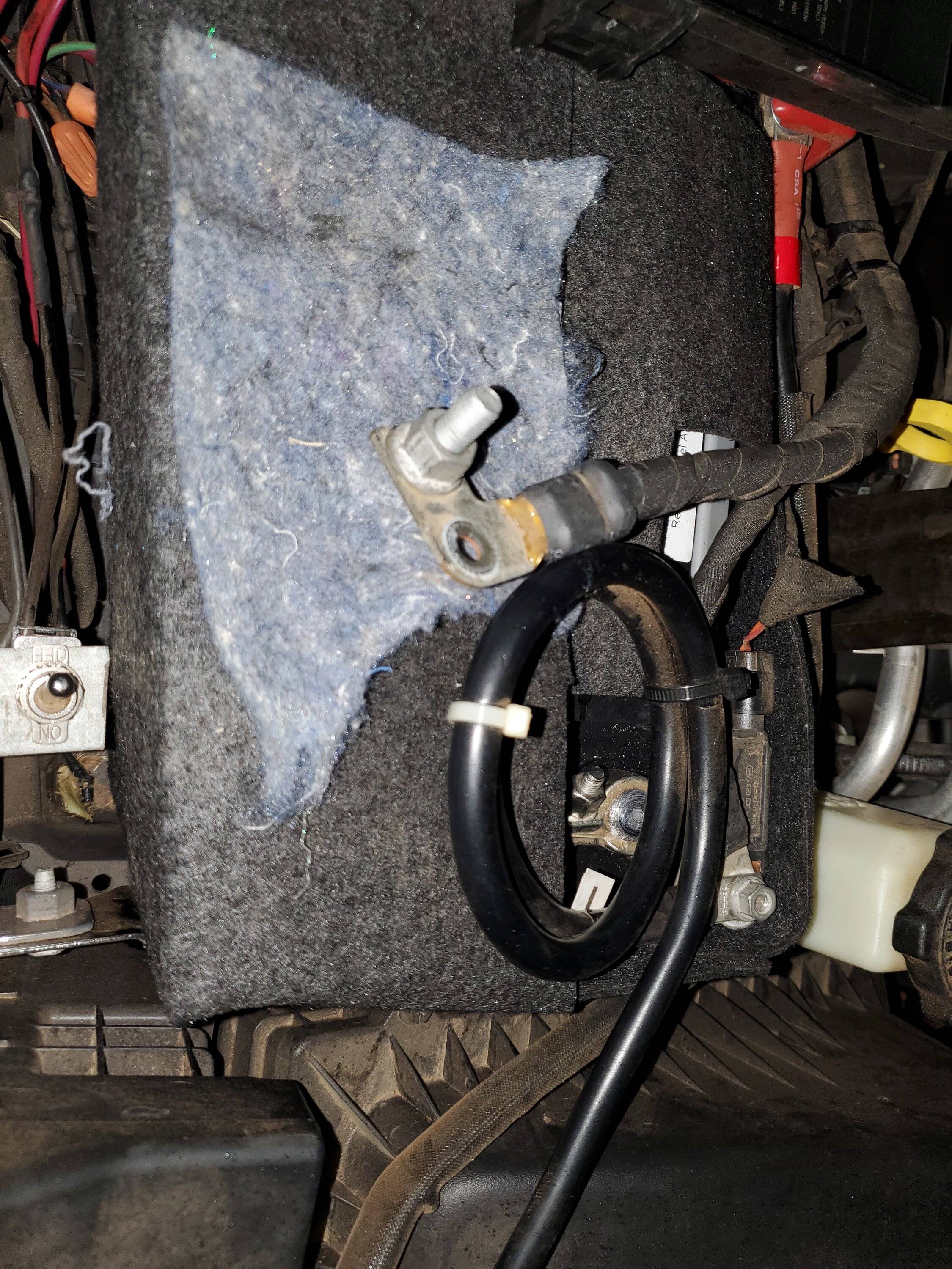

How to get rid of it other than pull.
I did the aux cable remove and pul f42 iitc and getting headlights power flickering
