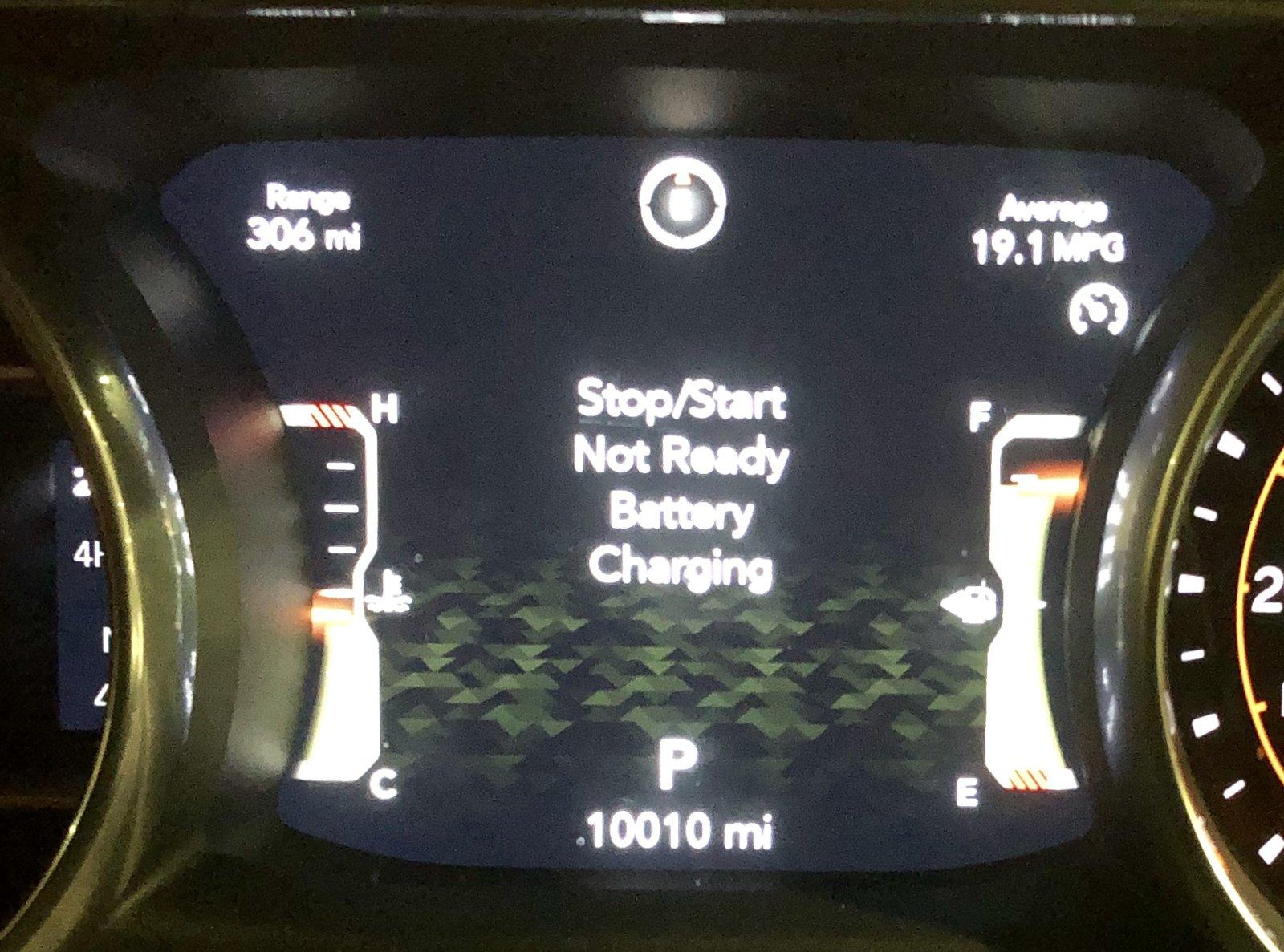

@Jeepney18 my ESS was in fault and displayed these messages
The first pic show ESS not ready due to battery charging and as you can see the voltage displayed was running 14+ volts and after running tests with a GR8 tester the dealaer found the main battery bad

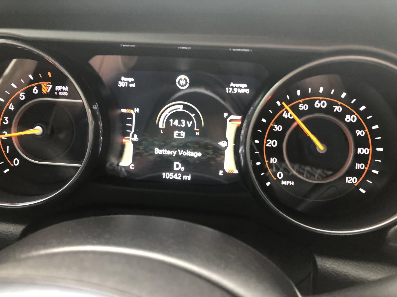

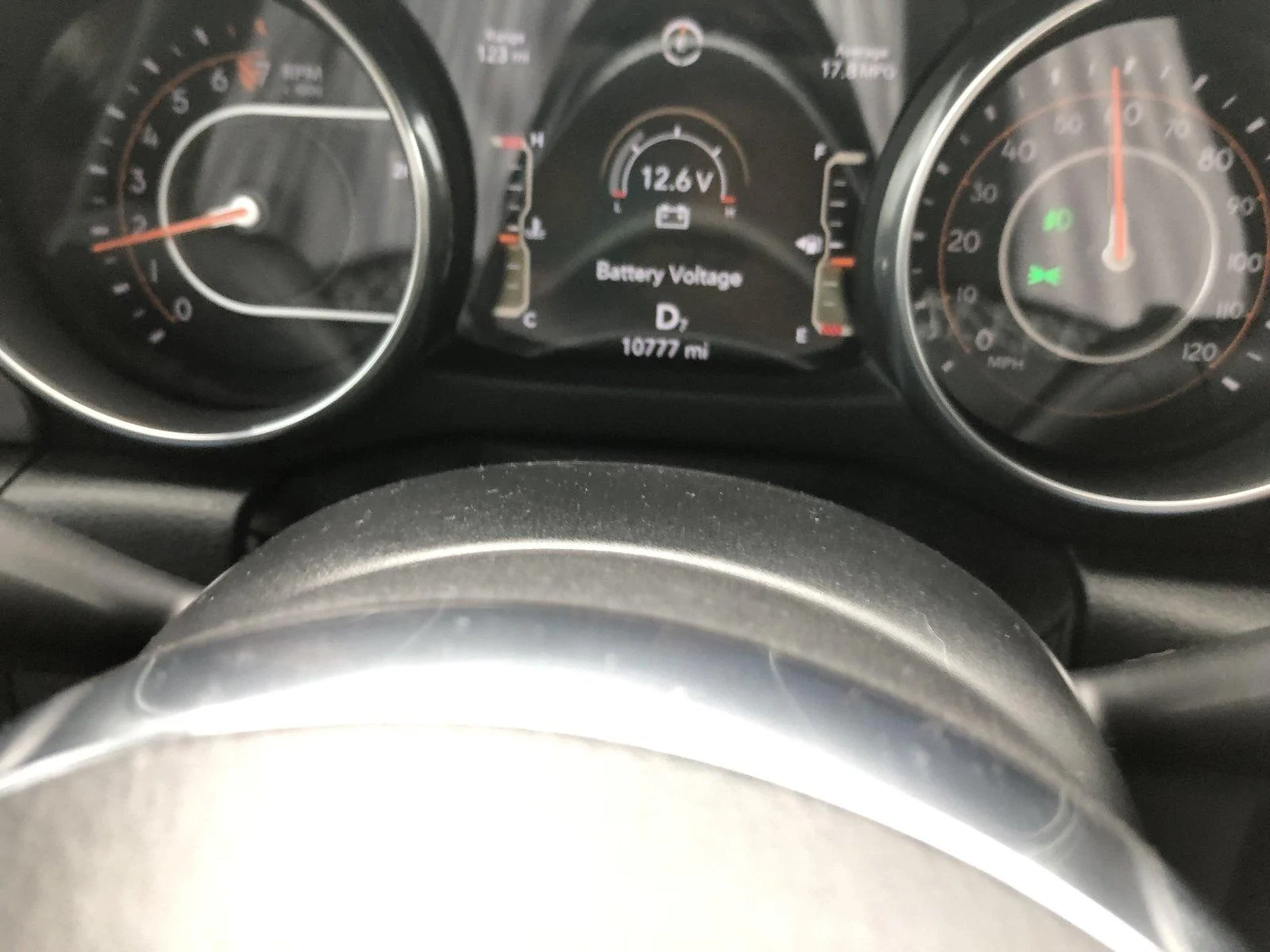

Here is my current voltage while idle, I thought this was odd but dealer advised this is a normal for a charged battery and the alternator only charges when needed
Jeep Wrangler JL Stop start in battery protection mode DE0079A0-BFBE-48FD-8ABA-CBA9597A475C
And here is a vid f me rolling down the road and as you can see the voltage ramps up to ver 14 when slowing down and then once stopped it drops back down to the 12.6-12.8 range but if it sits for several days not started the voltage initially starts off in the 13.5 range and drops back down after some driving

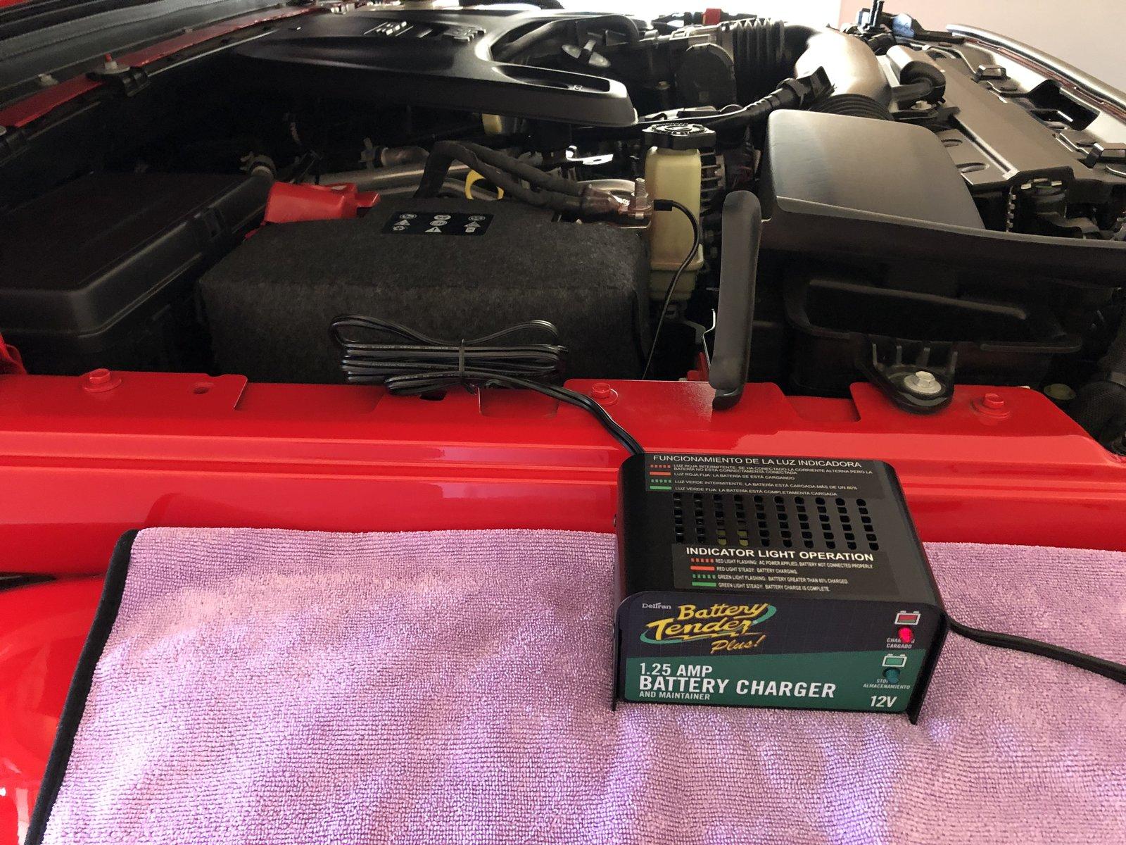

In regard to your question on a trickle charger I purchased a Deltran Tender Plus and have used it a few times when my JL stays parked for several days, @Rhinebeck01 is the one who suggested I put my JL on a tender when it stays parked for days at a time, I also installed the quick connect so it a real simple hookup and solid connection over the clips.
I’m still amazed that my voltage floats from 12.6 to over 14+ but the Service folks told me it’s not supposed to show the 14+ all the time, a tech told me normally the voltage will be in the 12.7-13.5 range

I still do not understand all this, My JL has sat many times for over 10 days with out any battery issues and start stop works with out any issues. I feel no one should need to use a tender to let a jeep sit a few days.
When I stopped in at the dealer to have them look at something under the hood after I had it serviced and the new battery installed the tech that looked at the item I was concerned about saw that I had a tender quick disconnect installed and ask if I ran a tender on it often and I answered to him if I leave it parked for 3-4 days I just hook it up and he said that doing that was pretty smart as using a tender can and has increased battery life on most vehicles
