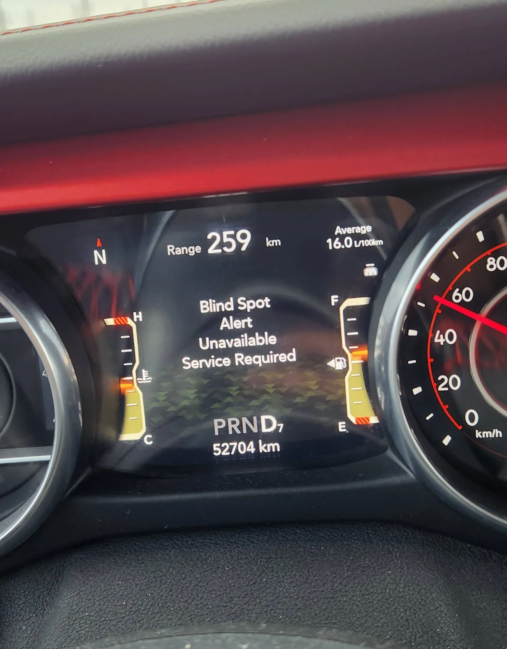

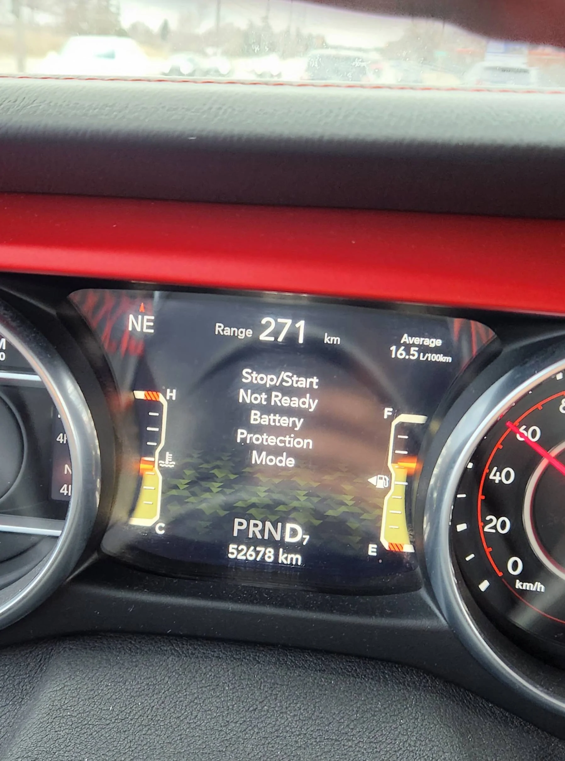

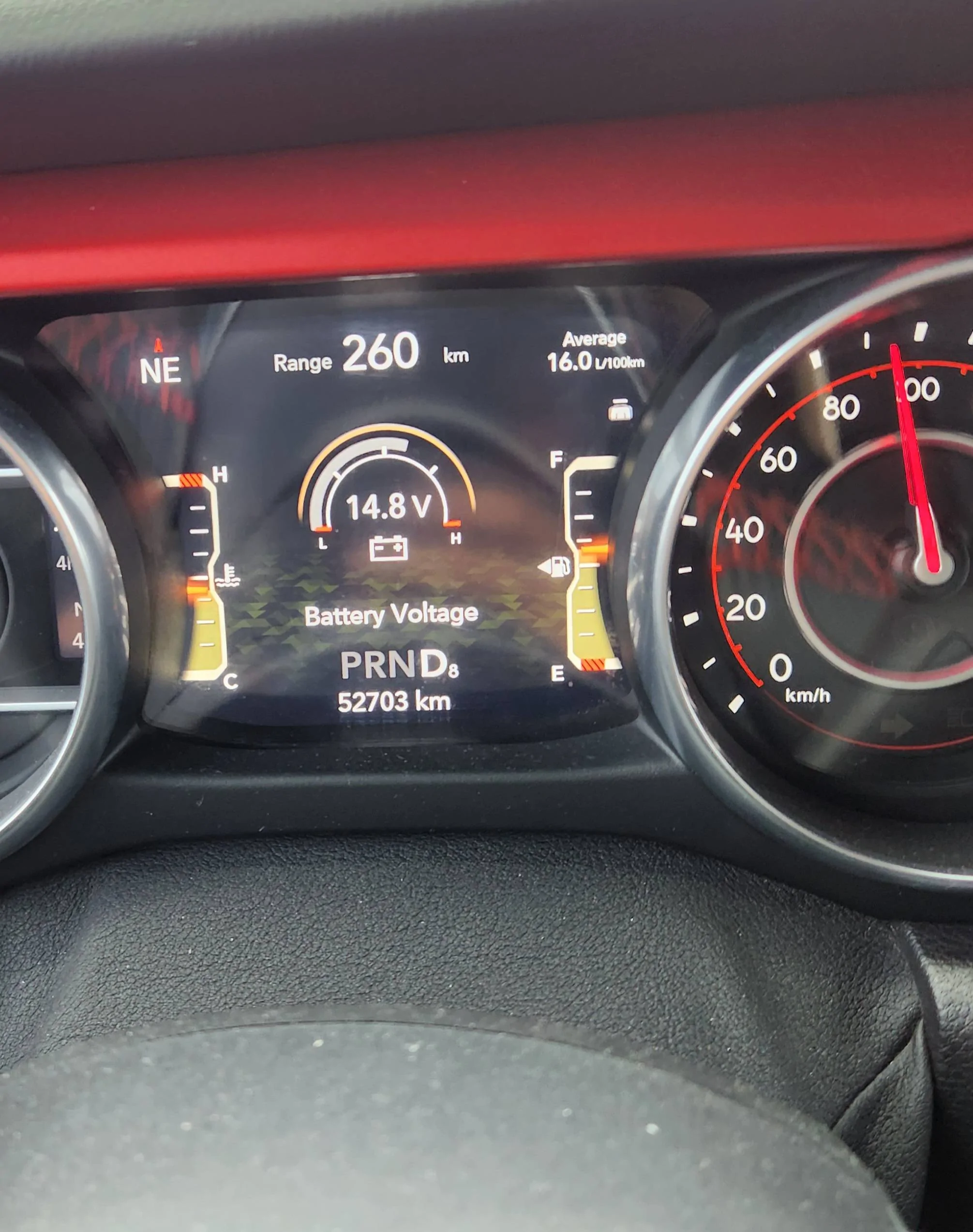

I parked my jeep for 1 month in October and disconnected the insurance but I remort start for 15 minutes every weekend then I restarted my insurance and jeep in November 2022,now after 4 months,still shows start stop not ready battery charging, i drove everyday to work now,long drive on weekends,but start stop worked only for 1 day last month,and yesterday I drove 200kms and got this new message ,battery protection mode. And blind spot alert not available service required. I think Alternator over charging it( as battery voltage shows 14.8)
I don't want to take my jeep to delership for diagnosis and now it not under warranty.
Let me know what you think guys,I already checked all fuses.

Mine just had the same message - and then it died on my yesterday. I removed both the main battery and the aux battery. The main battery is testing 12.41 out of the Jeep and the aux battery is testing 11.25. Going to get a new aux battery and see if that helps.
@whiterubicon
Your factory installed batteries(2) have aged out.
Do replace both the Main and the Aux. Not a good move to replace just one of the two batteries.

Thanks. The aux battery is only 1 year old - so it is under a warranty. Appreciate the advice and I am replacing both of them.
