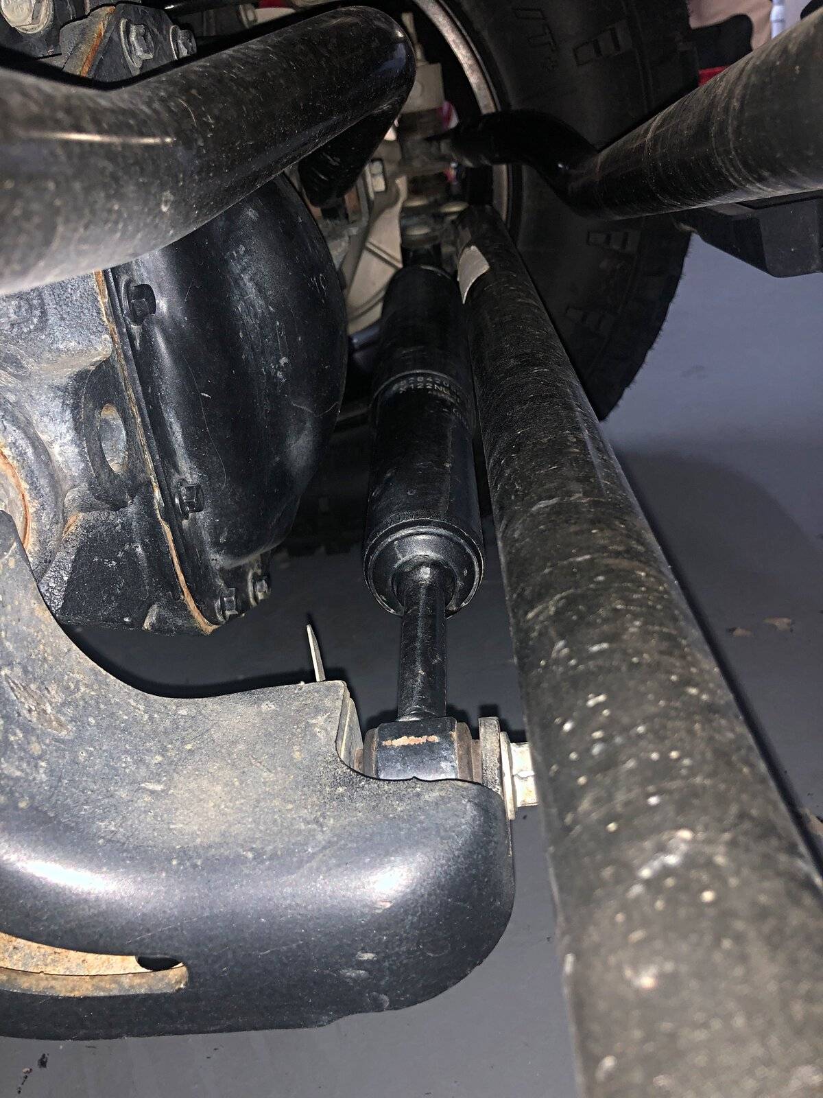

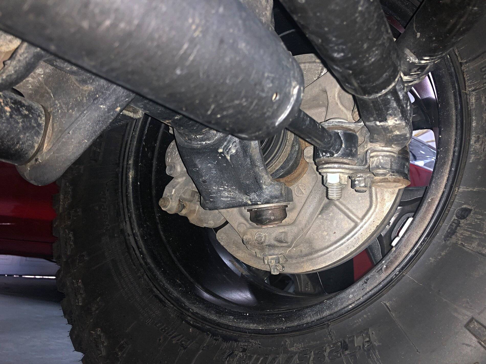

Is there any options available to relocate the steering stabilizer on the right hand drive JL Wranglers.

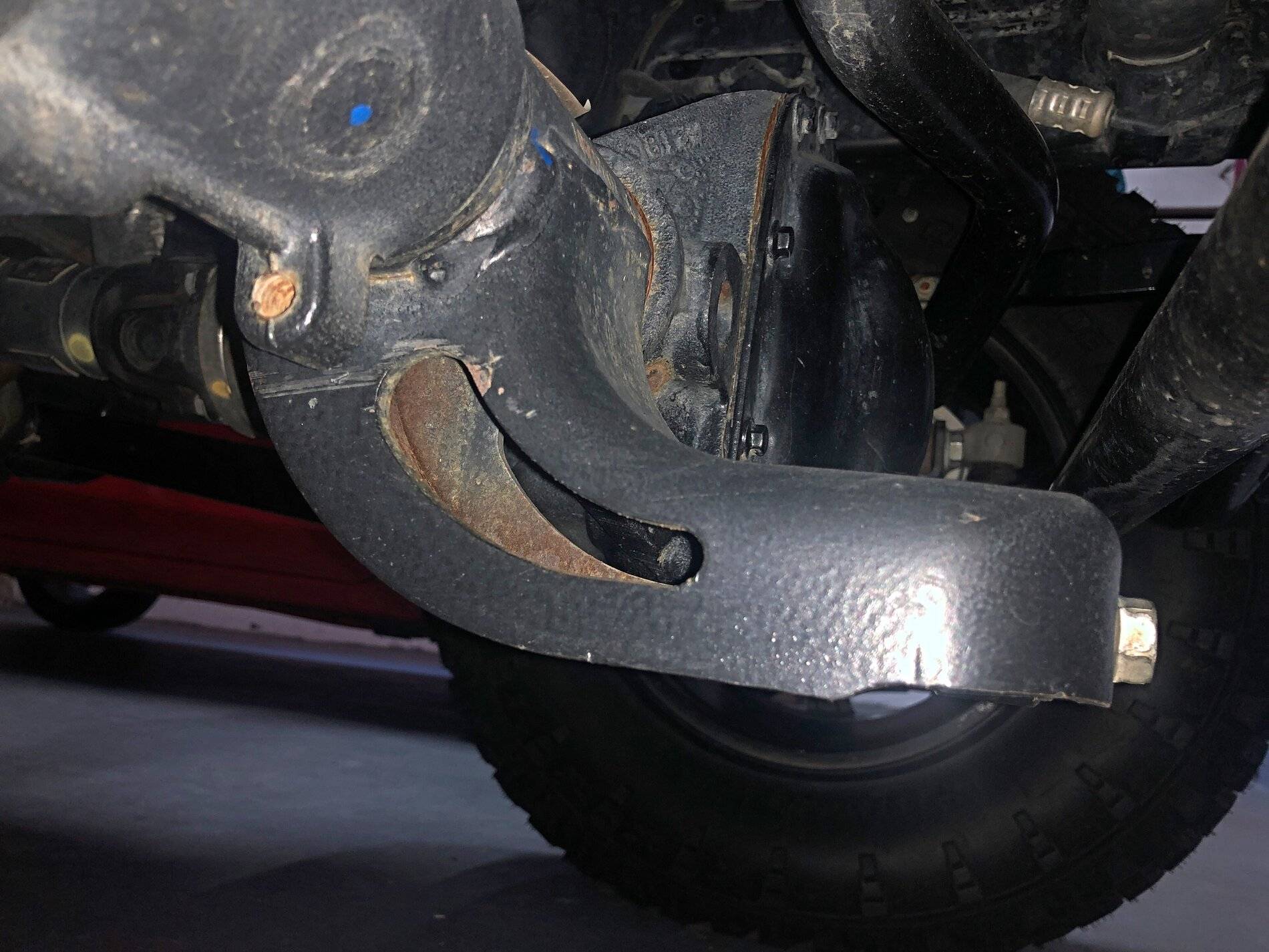

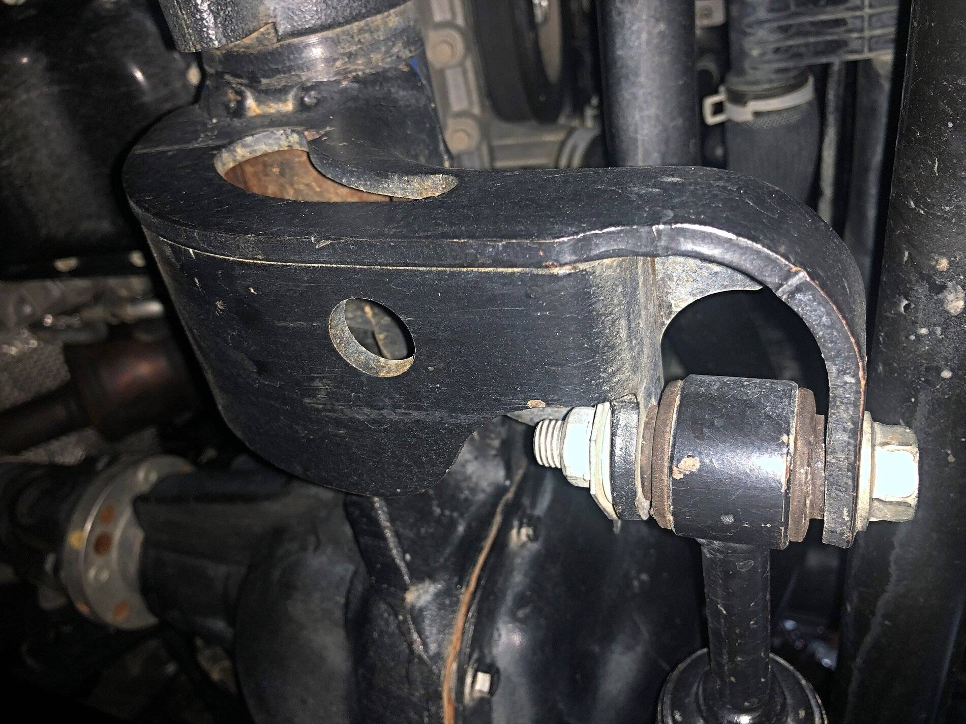

As you can see from the pictures the right hand drive stabilizer is fitted differently. The tie rod end is fine but on the other side it is mounted on a very large bracket that is welded to the Axle.
I want to get it out of the way and not be the lowest point in the front.
I hope someone has some advice or did such a modification on the right hand drive.

You can fit the Synergy kit with an aftermarket shock absorber. The smaller the diameter the easier to get all the necessary clearance.
I had to put a thick washer on top of the track rod tube clamp To get clearance on full lock.
jeepey in UK also have a kit which uses a teraflex steering damper but I have to say it didn’t feel as good as stock.
You then have the dilemma of the original foot shape bracket on the front axle. Designed specifically to hit everything possible?
I cut mine off with a carefully made thin cut which allows it to be welded back on should the need ever arise. Like you need a steering issue resolved under warranty.….…
If you can get away with it, leave it on.

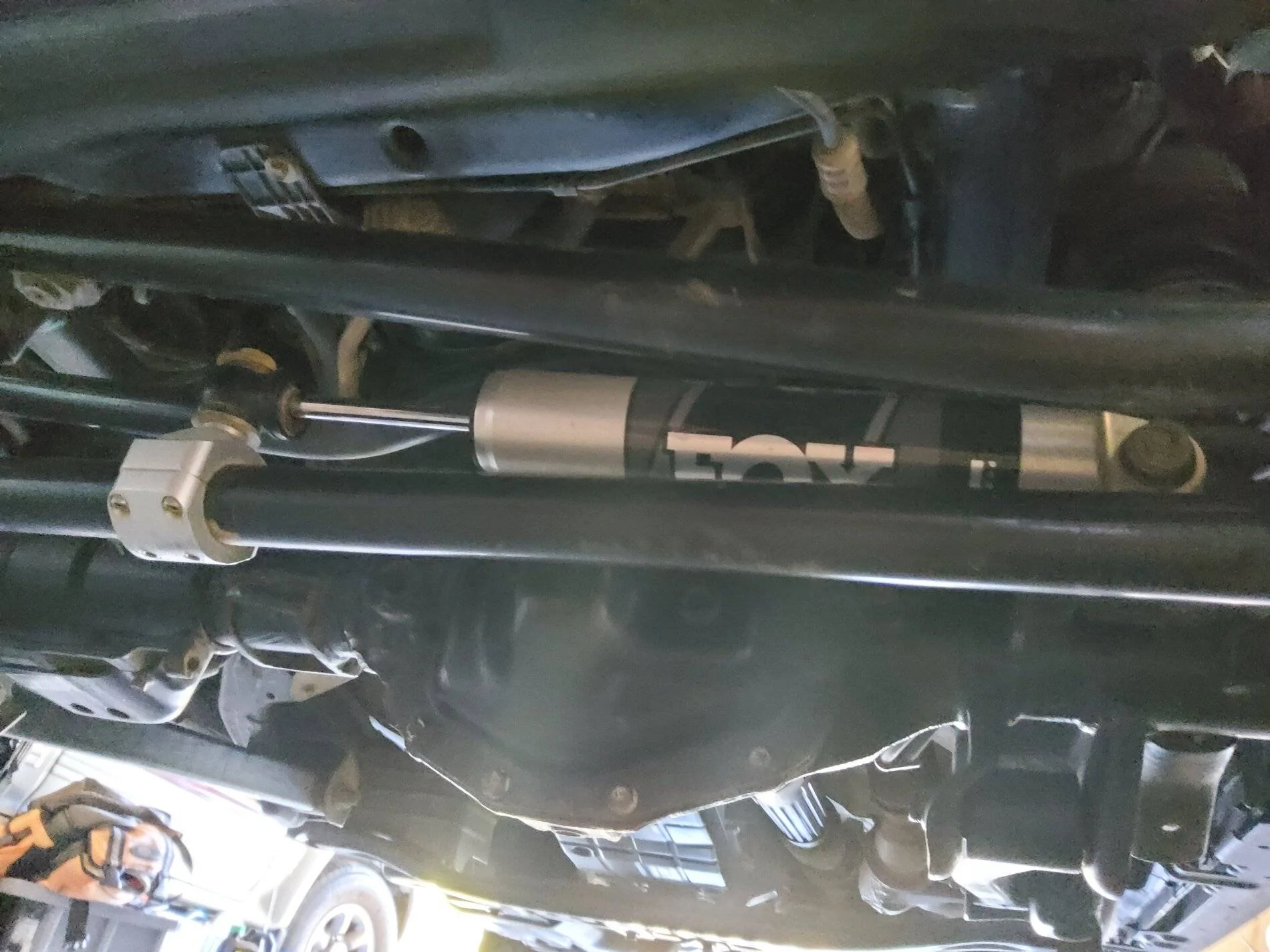

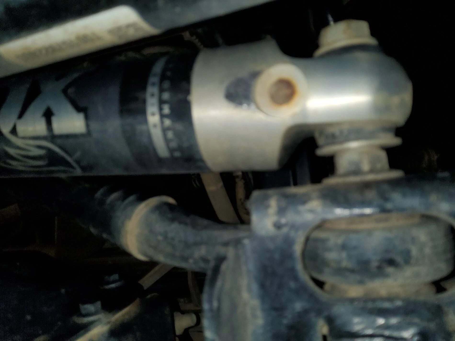

Teraflex relocation kit with fox steering stabilizer.
Hey thanks for the pics. Is this for a RHD JL wrangler? Do you have a link to the part? Thanks
Hi,
Do you have any rubbing issue with the stabiliser?

JLUR-Black
I have had the kit for a year now, and no rubbing. It is millimeter close tho.
Could you please let mr know your part number ? And which bracket you are using?
