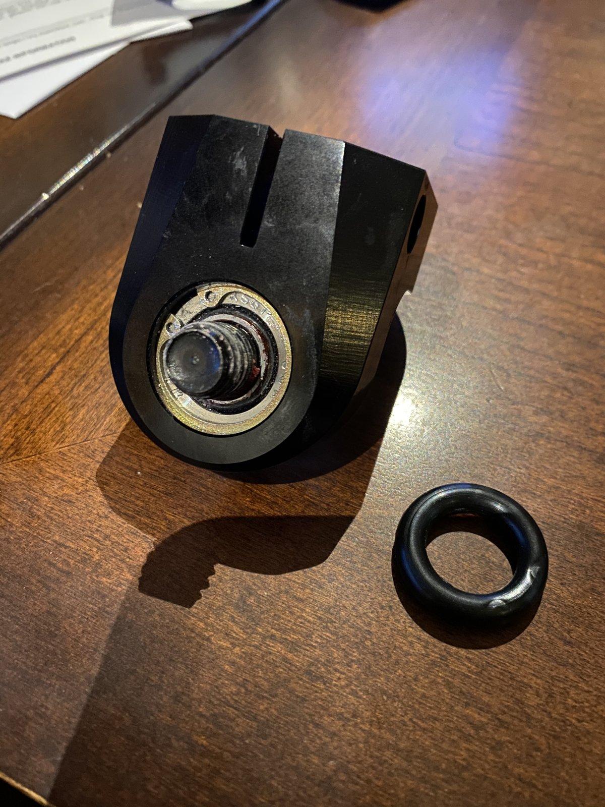

I got it off but it took a bit of heat. Lots of red loctite. Did yours have a snap ring like this? The bolt won’t slide out so I’m assuming it’s being retained by this assembly.

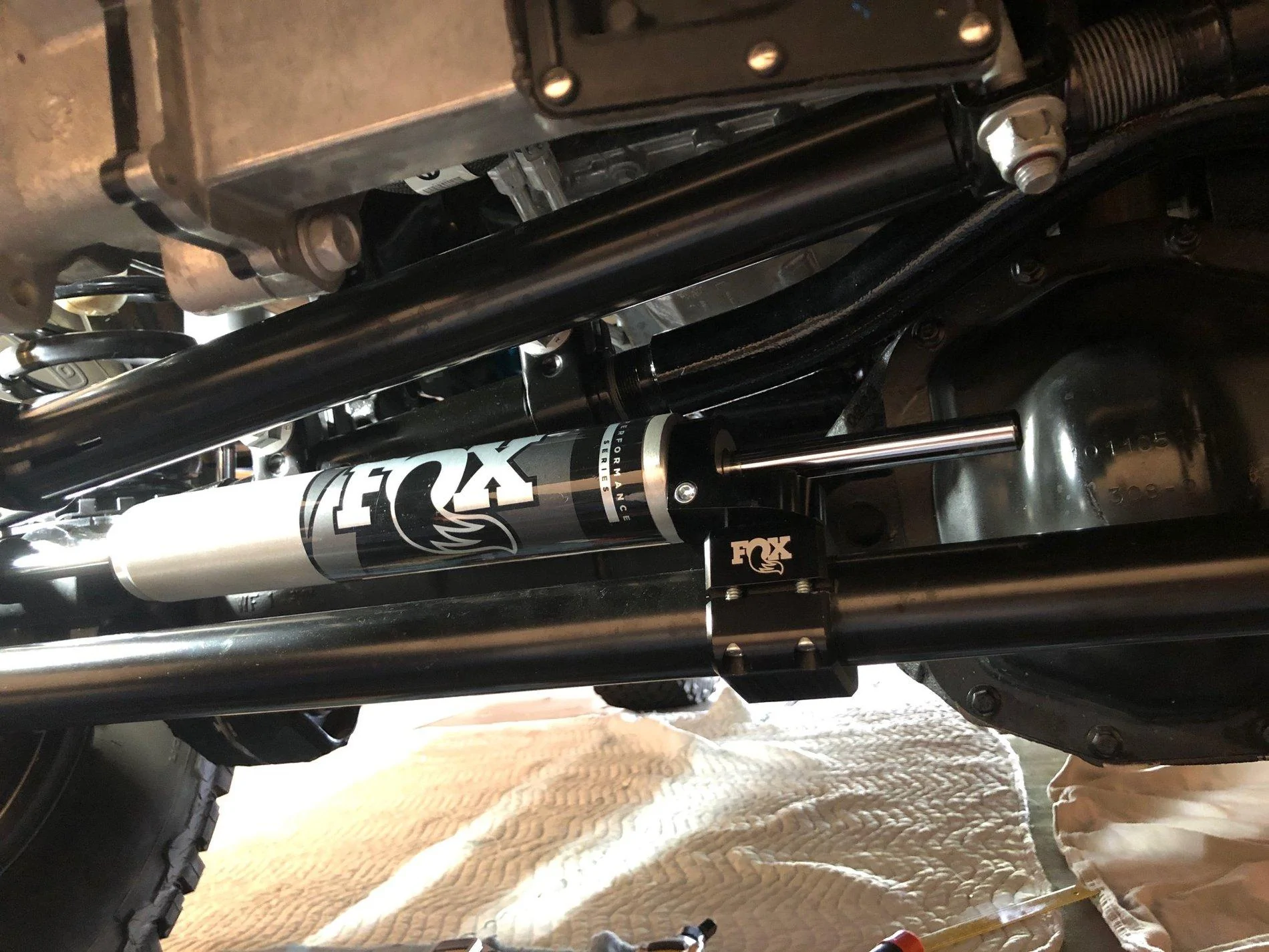

I never removed a snap ring. I left the bracket on that attached to the axle, put that piece in the vice. Took out the factory bolt, put in the new steersmarts bolt.

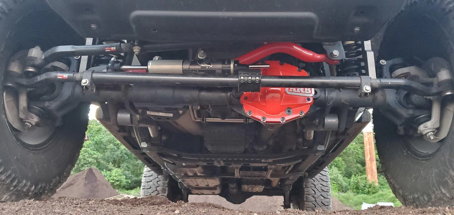

I have the full Steer Smarts steering (Rubi length tie rod, drag link and trackbar) and the Fox 2.0 TS top mounted using the Synergy Stabilizer stud/trackbar bolt and it works great! The picture below is full right turn, to the steering stops, to check for clearance-no issues!

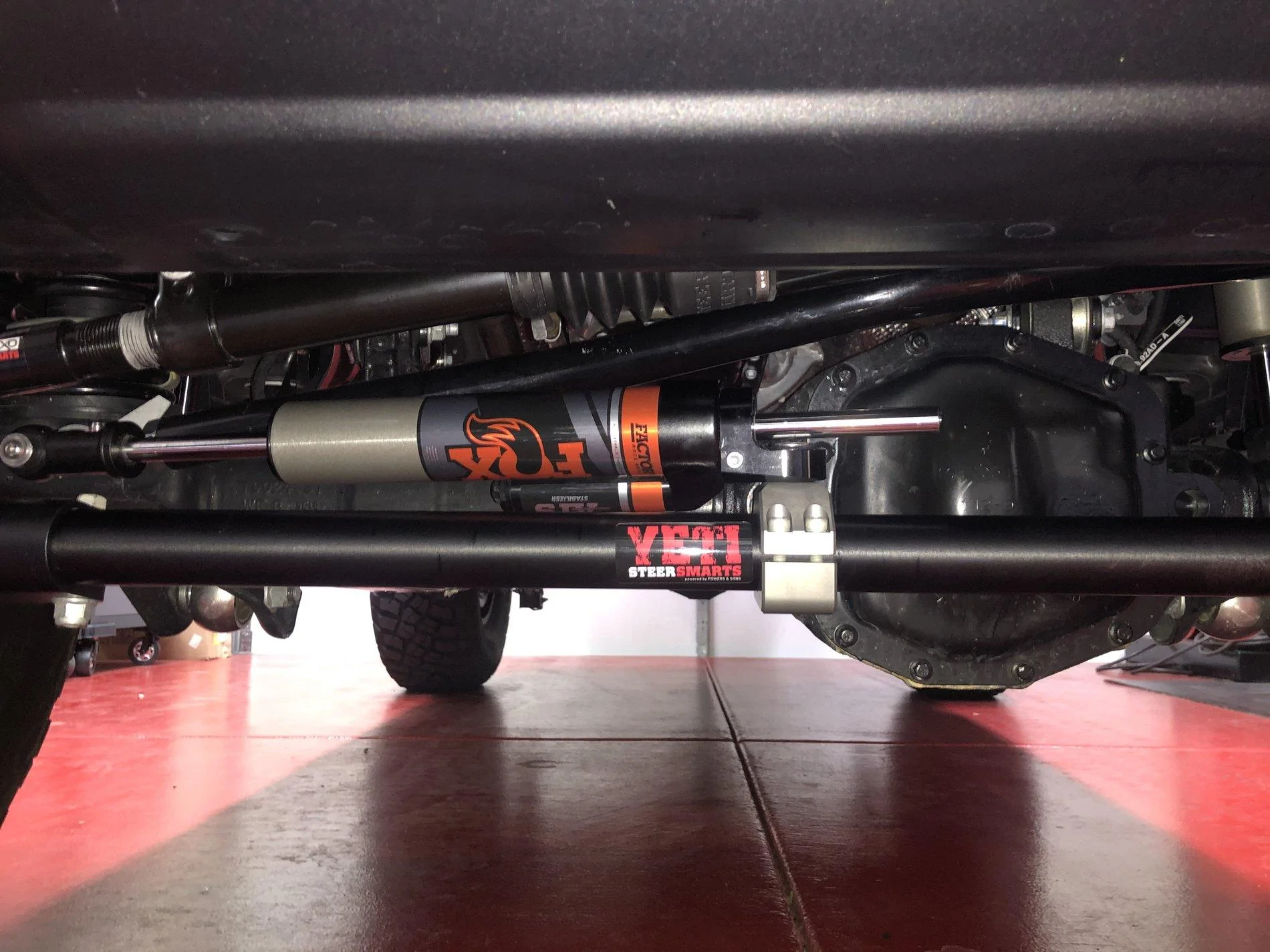

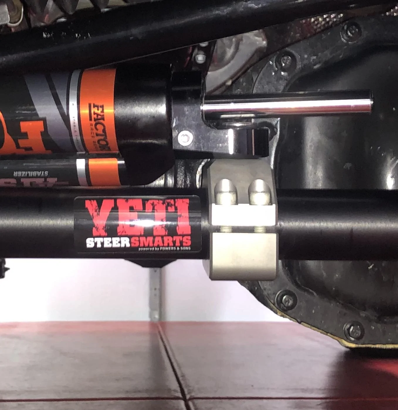

The SteerSmarts clamp is sized to work with their tire rod, which is 1-5/8". I went with the whole SS front end treatment and liked that their clamp is a larger 6-bolt design. It's also drilled and tapped to accommodate a hydraulic steering ram, but that option won't work with a through shaft stabilizer.
