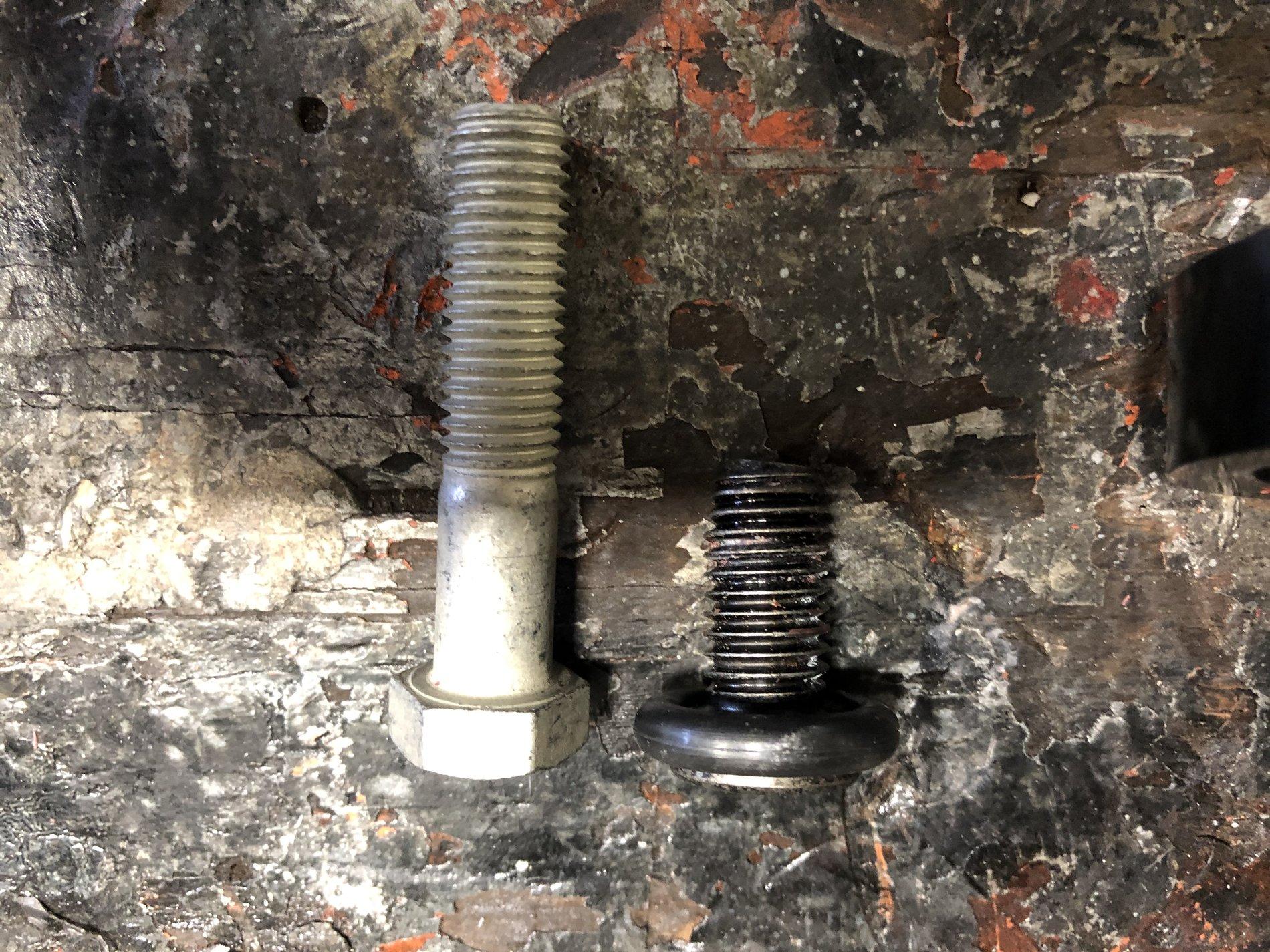

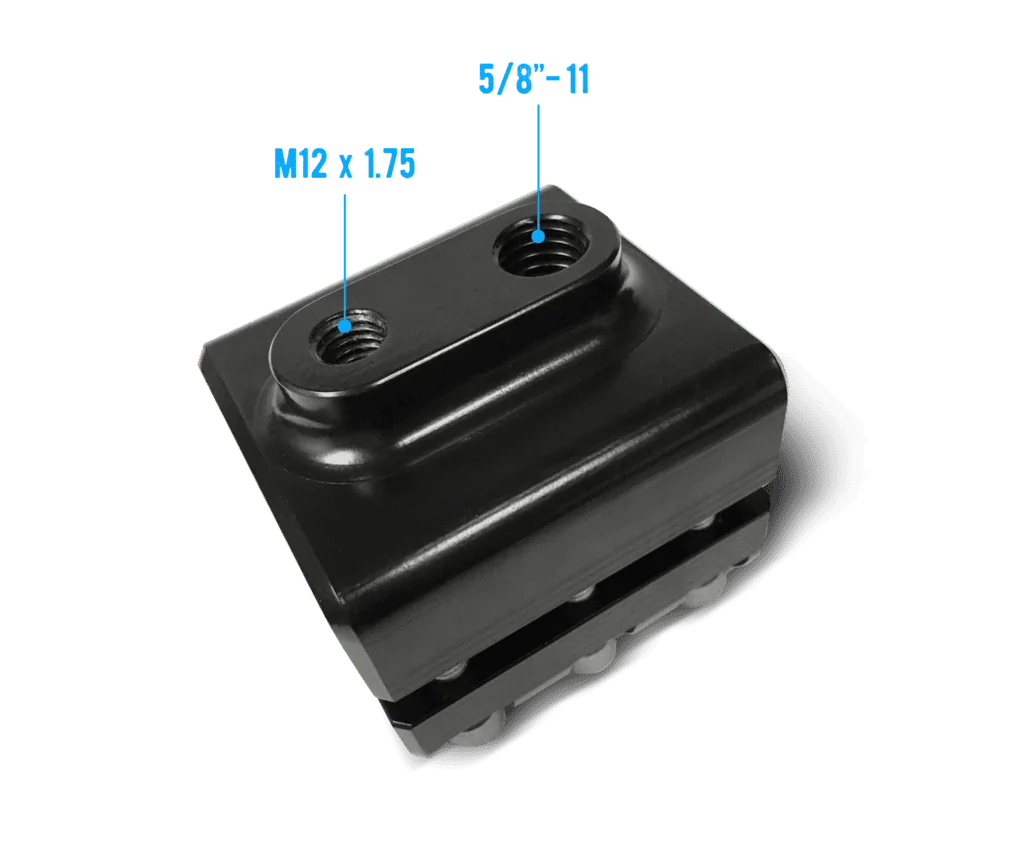

I can’t say with complete certainty, but that bolt thread looks more like the M12 x 1.75 thread than the 5/8 - 11. The pitch looks finer than the SAE thread pitch.
If you’ve got the bracket available take it to HD and test one of each to see for sure.
Might have to take it off and do just that.. lol Ugh.. it never ends :)
Alternatively, you could spend a couple of bucks and buy a fastener of each size and try them in the holes to see what fits. That way you don’t have to remove it since you’ve already put it on and you can return the bolts when you’re done.

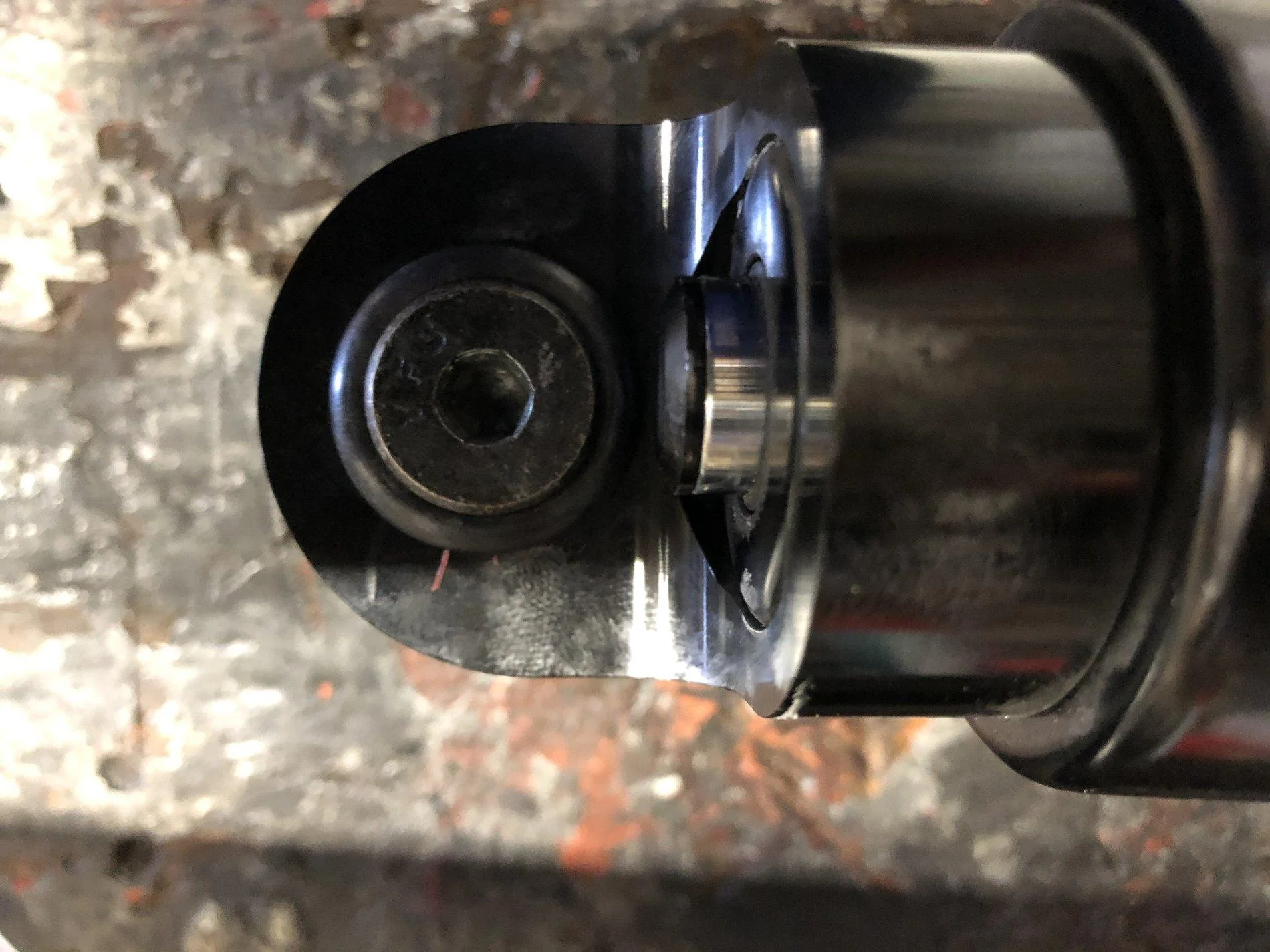

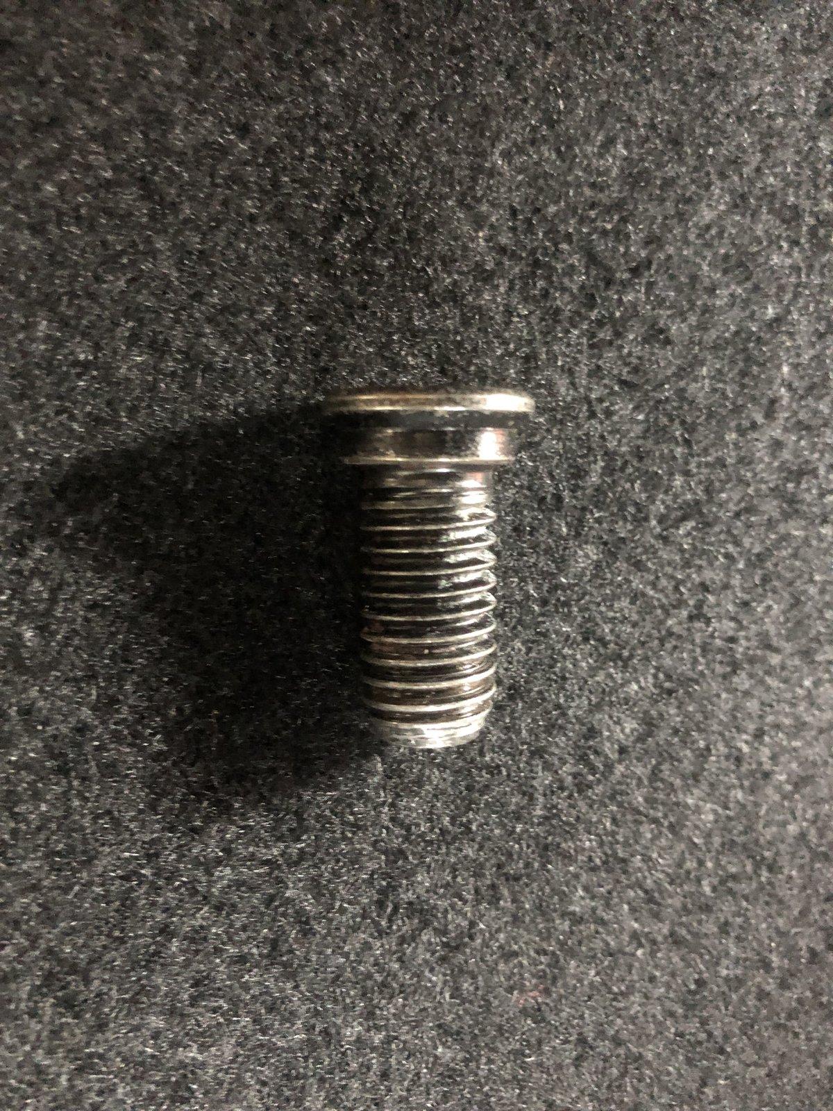

I had the Steer Smarts track bar, drag link, and tie rod assembly installed on Friday and Sunday. I bought the stabilizer bracket and relocation bracket and couldn’t install my Fox Steering stabilizer because the Fox bolt isn’t the same thread as the Steer Smarts stabilizer bracket. The bolt Steer Smarts supplies with the stabilizer bracket is designed for the factory stabilizer so the bolt is too long and does not have a tapered head or the recessed flange that the Fox bolt has. Steer Smarts is sending me the bolt that was referenced in an earlier post. When I get it I can swap out the factory steering stabilizer for the Fox one and be finished with the steering project.

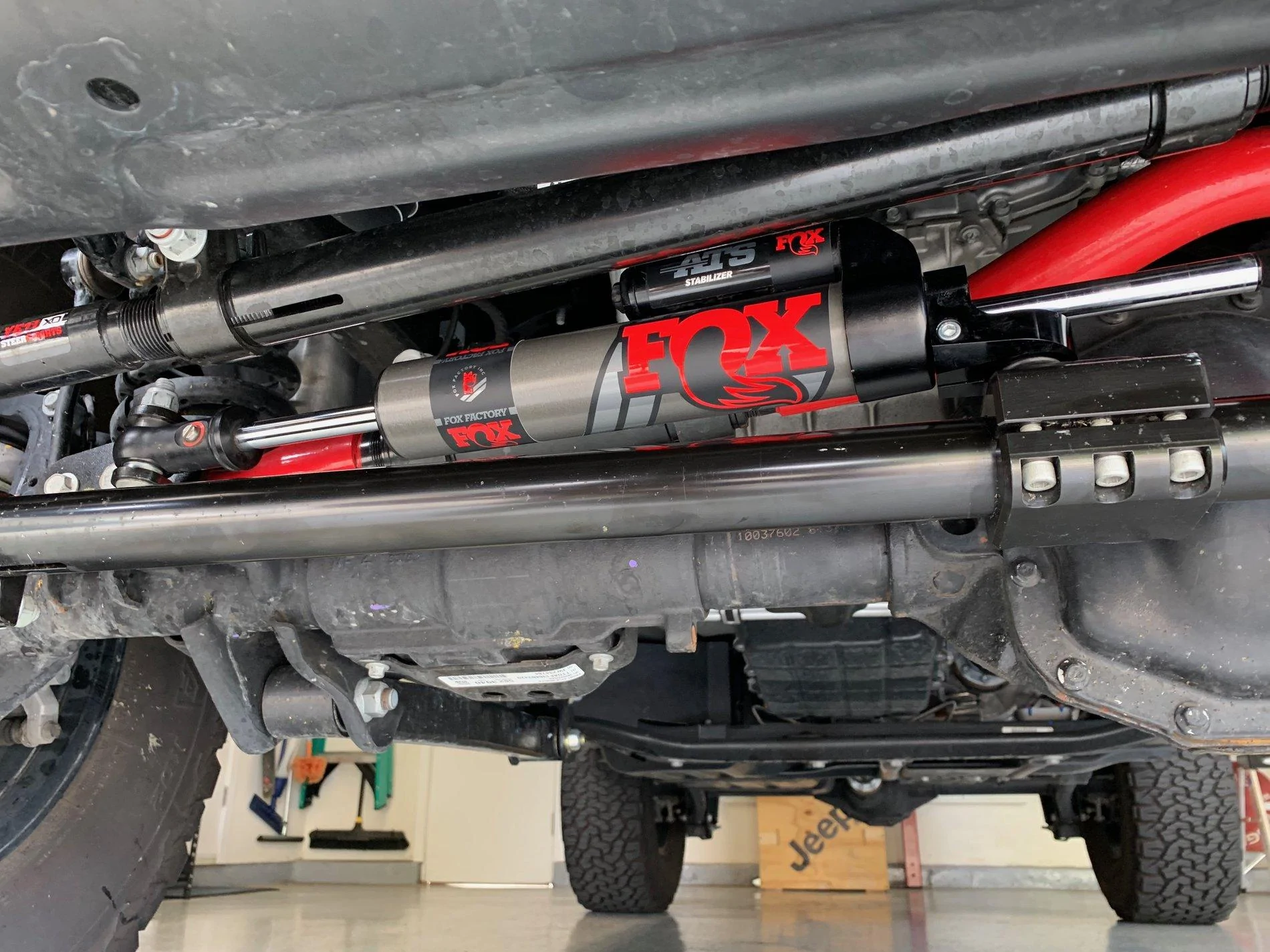

Just wanted to share that we were able to get my Fox ATS stabilizer back onto my SS setup (after initially removing it). It required a new countersunk bolt from SS to allow it to attach to the SS clamp instead of the original bracket used by Fox. Its a TIGHT fit, but I like the ATS and stiffness it offers for the damper. Also I re-decaled it in red since the orange was bugging me :)

night and day from the one you have. this one is adjustable and if you go to the stiffer settings its a huge difference, going to the max on the settings is too much even, so it really offers a wide range. I got the decals on eBay, they are made by Fox so super high quality
Are you able to share the parts used to make the ATS work? Is it just the stabilizer, clamp, and mounting bracket (Steer Smarts?)?
I had the ATS initially on my JK before PSC and I loved it. Would like to do the same on the JL, but couldn't imagine mounting it in the OEM location below the tie rod.

How did you get the black original bolt out from the stabilizer? Mine keeps spinning...
m3lover1
Ricky
Jun 9, 2019
619
1,522
Bay Area, CA
2019 Sting Gray JLUR, 2007 Yamaha R6
put the mount on and put it in a vice.
We are idiots. We thought it was threaded in and not that it could slide right out lol. Thanks for the help
