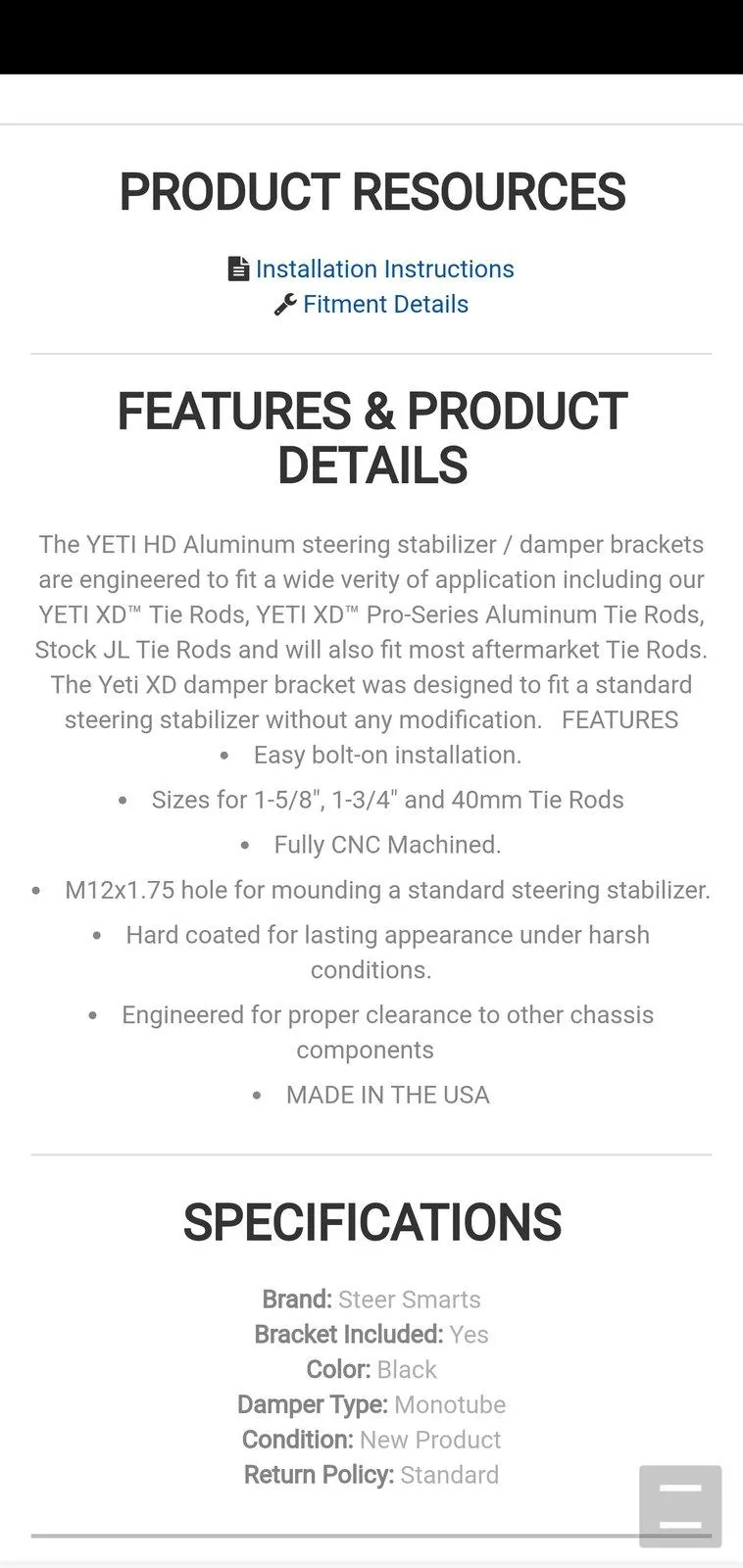

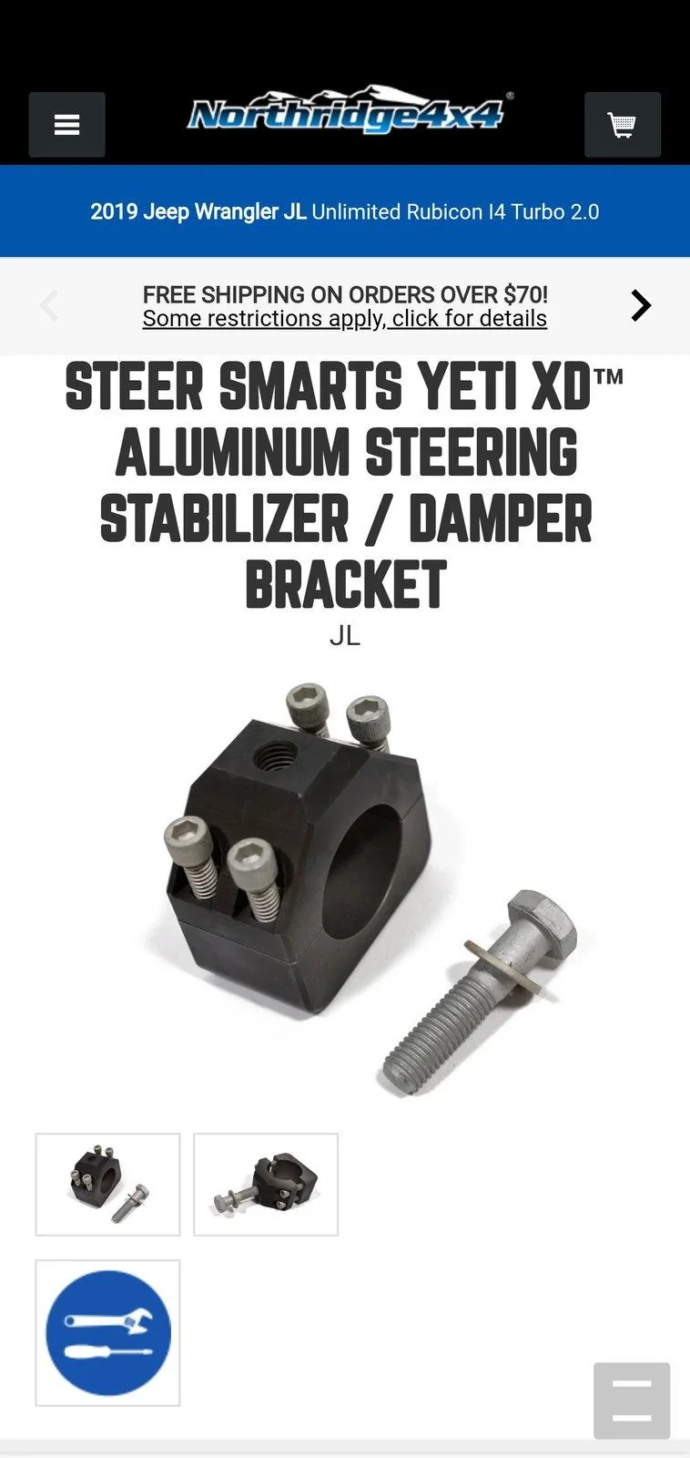

This is dependent on which tie rod you have from steersmarts?
They only have the 2 different tie rods, which are identical except for length. One is a bit longer and marked "Rubicon only", to account for the Rubi having wider axles than what comes in the Sport and Sahara models. Both are 1-5/8", unless they've added something new that I'm not aware of.
This is the one I was thinking of, also the one I went with. 1-3/4” diameter.
https://steersmarts.com/collections...angler-jl-jlu-2018-select-standard-or-rubicon
