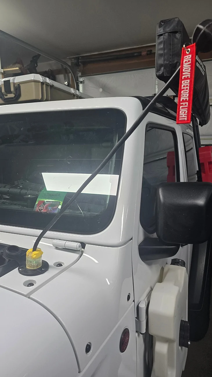

I don't drive that often. I mounted a NOCO 2D charger in the engine compartment with an external plug on the windshield cowl. l just grab the retractable cord on my garage ceiling and plug it in. Easy peasy.
And the retractable power cord on the garage ceiling is very convenient for many other things. IMO every garage should have one.

If you're thinking of doing it, the NOCO external plug just fits here and it's a very easy run into the engine compartment. I did make one modification to the plug. It has a drain hole but its clearly designed for a vertical mount, not horizontal. I drilled a 2nd drain hole at the bottom corner of the well between the pos & neg plugs outward at a 45 degree angle. There is nothing there but plastic and it will fully drain any water that may get in there.

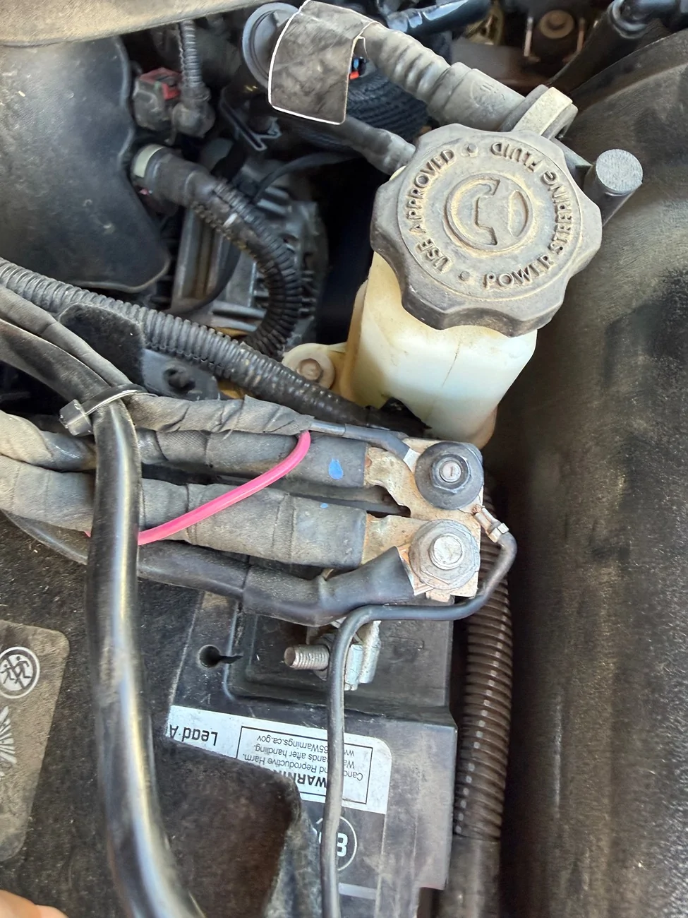

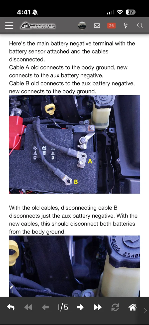

This is really confusing. Is he saying the negative terminal going to the auxiliary is “cable B”?
If this is correct, pulling that off the main and wrapping electrical tape around it should do the trick, correct?
Then I will just replace the main battery and eventually pull that old auxiliary battery out of there. I assume leaving the positive terminal on that auxiliary battery won’t hurt anything, since it doesn’t have a ground to close the circuit. I will snap a picture of my terminals!for reference as well.
The author of the post I linked is saying that sometime around model year 2021 (your model year), cable "B" changed from being connected to the negative terminal of the Aux battery to the body ground as located under the engine bay, on top, on the passengers front quarter panel, a.k.a. here:
If you are confused which cable, "A" or "B" is in fact your JLs cable that leads to the Aux battery do this instead: Start at the body ground that I just linked you a video of its location above. There are two cables there. Trace the one that ends up connected to the negative post of the main battery.
It is that cable you leave connected to the negative terminal of the main battery, removing the other (which will connect to the negative post of your Aux battery) and taping it up. This approach works for all model year JLs with dual AGM batteries.
Don't forget to pull Fuse 42 and turn ESS off at the dash.
