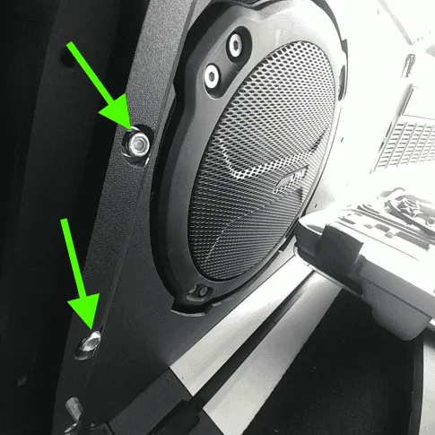

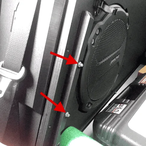

These bolts stick out about 1/4",
I only bothered noticing and doing something because they chewed up the pool noodles I had in the back.
After a bit of de-installation, I pulled these two bolts out and cut them down 1/4". I think a 1/4" was a little too much, probably should've just cut 3/16", but they're still biting into the nylon of the locking nuts.
Now, I can haul pool noodles (and other things) without worry of them being damaged or snagged on those bolts.
Couldn‘t you just have put the bolts in the opposite direction, i.e. bolt head on the inside of the cargo bay and the lock nut hidden behind the side panel? - I hope you don‘t mind me asking, but I have the Squadbox sitting in my garage, just haven’t found the time for the install yet... So I am now gathering as much info about the install as I can!

If you point those un-cut bolts away from the center of the Jeep, the thread side hits the plastic surrounding the subwoofer. If you cut the bolts, and then similarly point these shortened bolts away from the center of the jeep, the nylock nuts will hit the plastic surrounding the subwoofer.
Fractions of an inch matter in that spot. When I originally installed the subwoofer side, I pointed the nuts towards the center of the Jeep and I used washers in the bolts. Then, I wondered why the SquadBox wall seemed to curve and bow out a bit - it was because those bolt heads were pressing against the plastic surrounding the subwoofer. I removed the washers, so the bolt heads would lie lower and no longer touch the plastic surrounding the subwoofer.
I honestly can't remember if the instructions explicitly stated not to use washers with those bolts. But I suspect they did, because...I do remember thinking I had been shorted by two washers and adding a couple of washers from my ferreteria stash,...which I really didn't need to use, after all, LOL.
