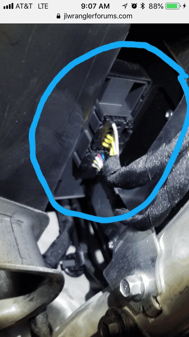

SO after 16 days in the shop trying to locate this issue....even though I showed them the pics from this thread the FIRST time I took it in....they located the vibration issue to be a "gateway module" behind the lower speaker under the steering column area. The official dealership fix was just a dollop of epoxy. I am beyond frustrated. I get to go pick up my baby today...hopefully! Oh how I have missed her.
Could you grab a picture of the fix so I could see exactly where/how they used the epoxy. There haven't been any real follow up pictures on here with actual solutions yet

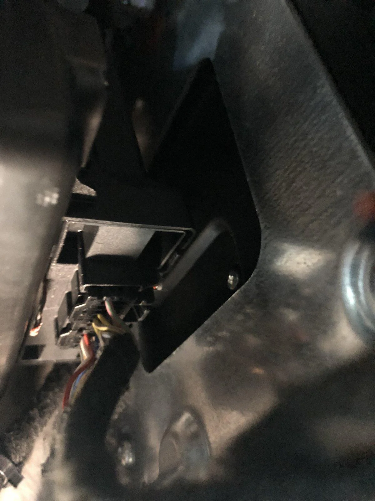

I have this same issue and it was vibrating so bad through steering wheel I had to investigate. I found the noise went away when I applied pressure to the two connectors going into the module behind the left speaker under footwell area. (see pic)
The plastic that the connectors attach to is loose. It rattles real bad. I also suspect the speaker enclosure could use some sound deadening spray or material in it. Possibly insulation on the mounts of the speaker box to the chassis. Not sure yet.
HAHAHA...thats funny! if you get a Tazer JL you won't have to worry about it anymore. You unplug those wires and let them hang free with the Tazer installed.
See the photo below.....that's the gateway module.
