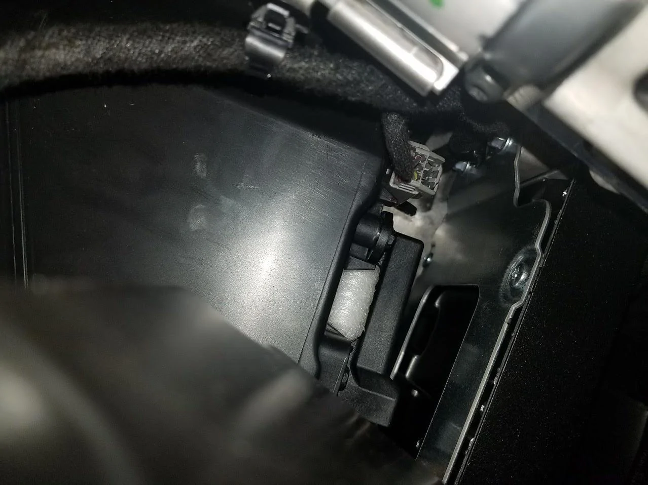

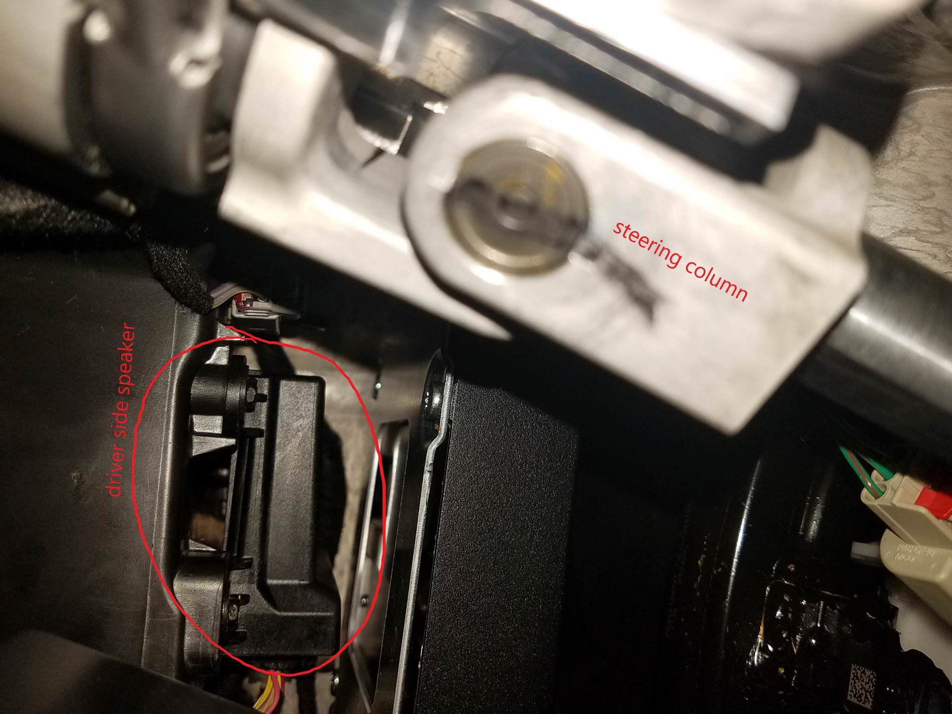

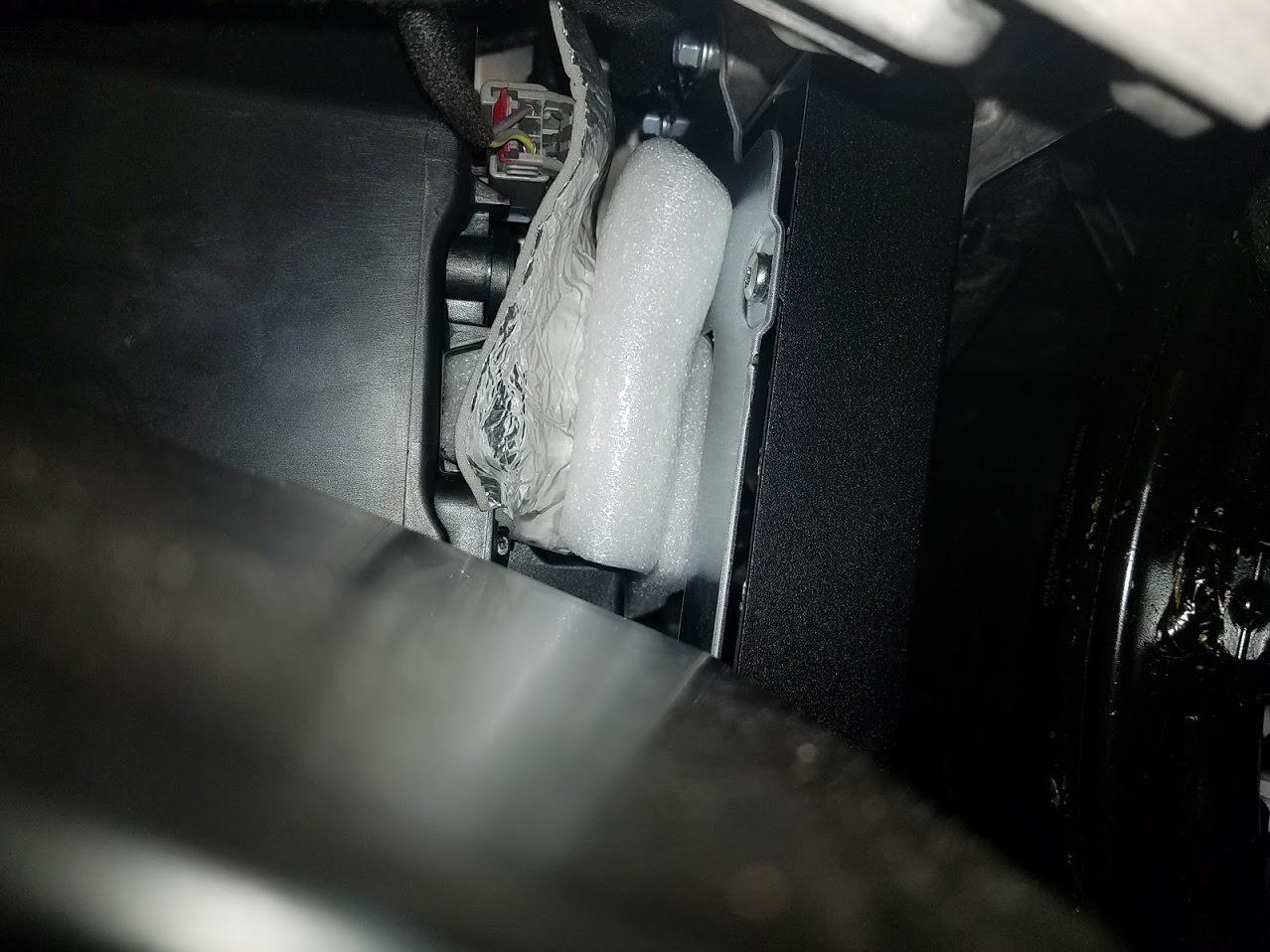

Got around to taking pics for this today. So I would have rather pulled the dash panel out to remove the speaker, but that looked a bit more complicated than anticipated. There was a screw in a very inaccessible spot, facing inwards towards the passenger seat, and pressing up against the inside of the drivers foot area. There is no way to remove that screw without pulling the entire left side of the dash out.
I ended up just re-foaming this, and doing everything from behind the panel under the steering column. There are 6 press in clips that hold that panel on. Start from the top and work your way down. When re-installing this panel, be sure to place the white clips on the panel itself. It will make life easier.
I circled in red the part behind the speaker that was causing the vibration in my truck. Second pic is a bit of white foam rolled up and stuffed in. Third pic I added an additional bit of adhesive backed foam foil (kinda like dynamat), and a second piece of white foam. The grey clip on top also wants to vibrate, so make sure that is anchored too.
To really get this to act up, you can set your radio to Howard Stern and adjust balance/fader to front left speaker.
