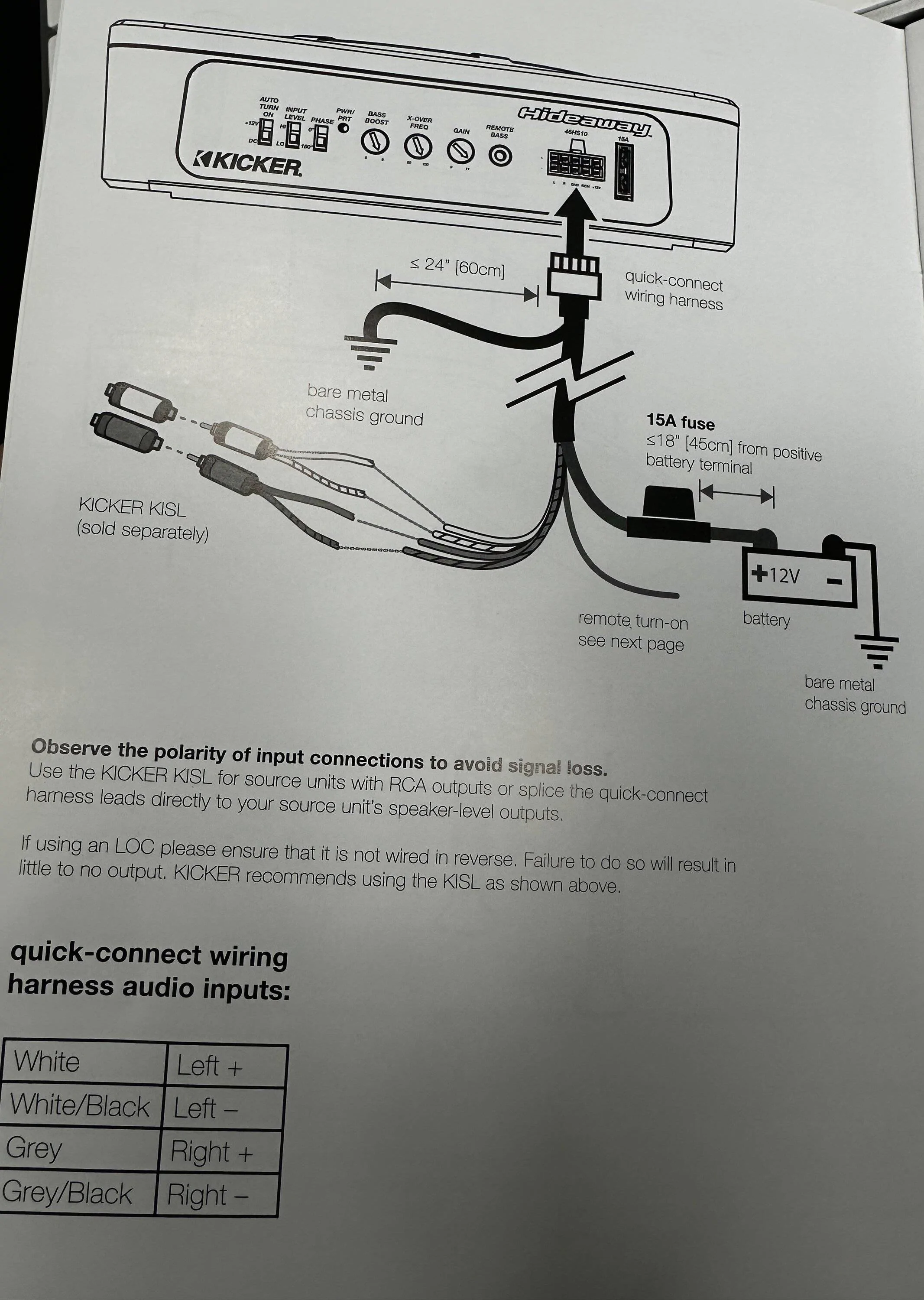

I am by no means an audio wiring expert. At all. I just would love some help on getting everything together. Here is what I am installing:
  • JBL Club 9632 - 6x9 - Roll Bar
  • Kicker 47KSC3504 - 3 1/2 - Dash
  • Kicker 46CSC674 - 6 3/4 - Knee
  • Kicker 46HS10 - Powered Subwoofer
  • I currently have the 7" stock head unit.
I got the dash in already, I'm not terribly concerned with installing speakers. Thats all straightforward. My problem comes from the Kicker 46HS10. I am a little confused about the install with wires. Here are my concerns/questions:
  • The instructions that came with it mention ground from battery to "bare metal chassis ground" - Is this already done? Or do I have to buy something additional?
  • Crutchfield had me purchase the Kicker KISL: I am assuming so I don't have to splice into the wires? If that is the case, is it better to use the RCA connectors to the back of the head unit? Or is it suggested to splice into the speaker wires and do away with the RCS adapter?
  • If I do the splice option, can someone show me EXACTLY where they did the splice? The linked thread from below has the wiring diagram.
The wiring is my biggest concern. I can pretty much figure out the rest. The information from https://www.jlwranglerforums.com/forum/threads/simple-subwoofer-upgrade.108432/ has been SUPER helpful but I just need a little more clarification.
Any help would be WONDERFUL.
