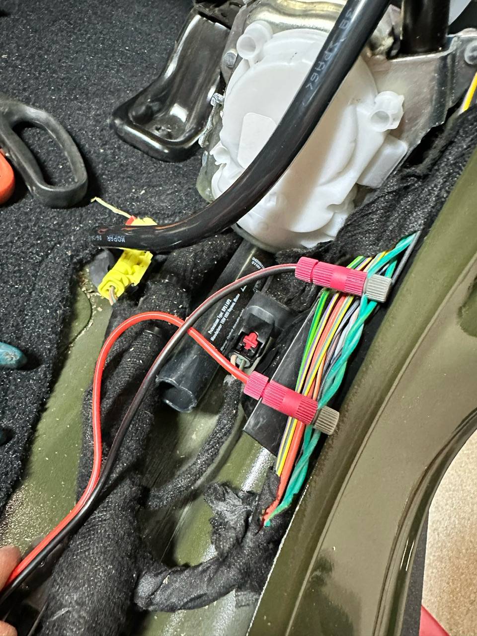

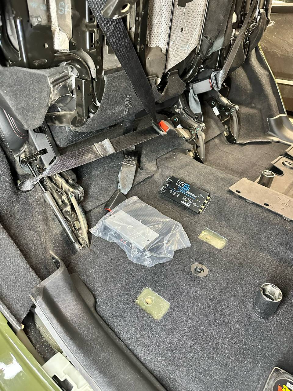

I’m in the process of adding the 10” JLAudio Driver Side Stealth Box to my factory 8.4” receiver. You’ll need a Line Output Converter (I opted for an Audio Control LC2i PRO to tap into my Alpine amplified speakers at the bottom of the passenger side b-pillar). From that I’ll run quality RCA to my mono amp and then speaker wire to the sub.
The hardest part of it all has been figuring out where to put everything (installing a Cap as well). At first, I was going to install the amp under the front passenger seat, but quickly noticed the heat vent that would blow hot air directly at the amp. No bueno.
I opted under the rear seat (I have a 4 door). A good factory ground is about 12” away from the amp, so it’s the perfect spot.
I’m going to remove these plastic Posi-Taps and connect the wires directly in the future and I suggest you do the same(just want to get this on and tested before stripping any wires). Also, I still need to tap two more wires. This is passenger side b-pillar…

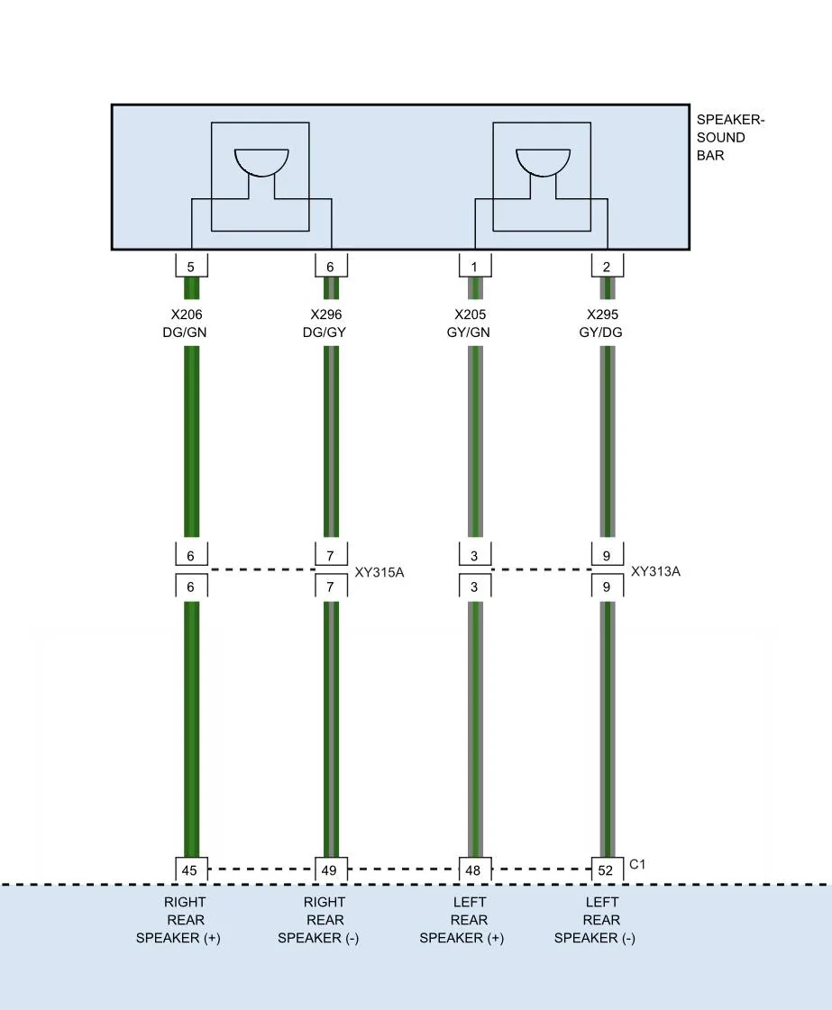

Here’s the wire colors for the base audio (appears to be the same for the Alpine upgrade)…

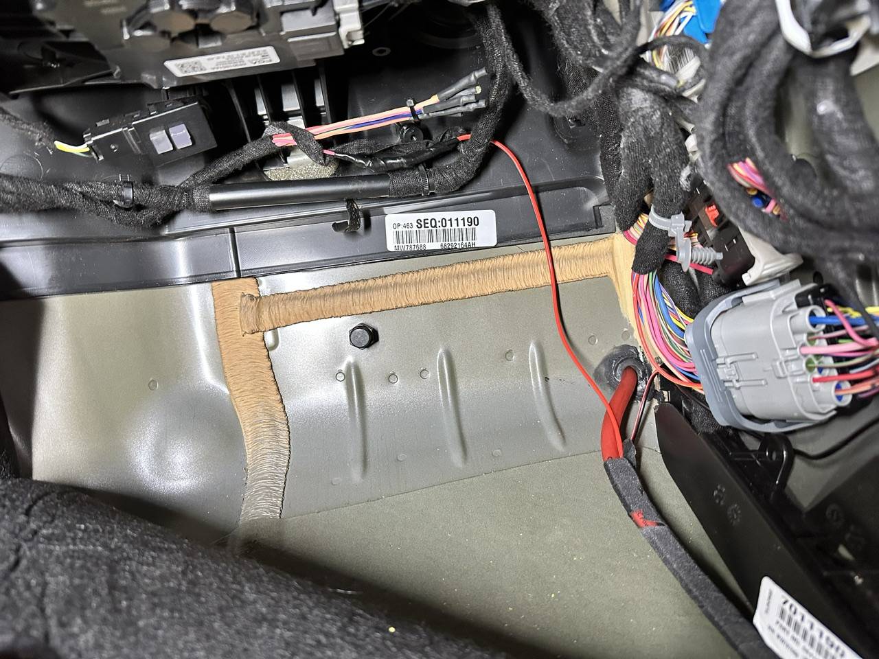

I installed a grommet in the passenger side floor board for the power and I eventually tucked the wire under that black plastic piece. The smaller gauge wire is power for the Audio Control LOC mentioned previously (I need to refuse this with a 5 amp fuse).

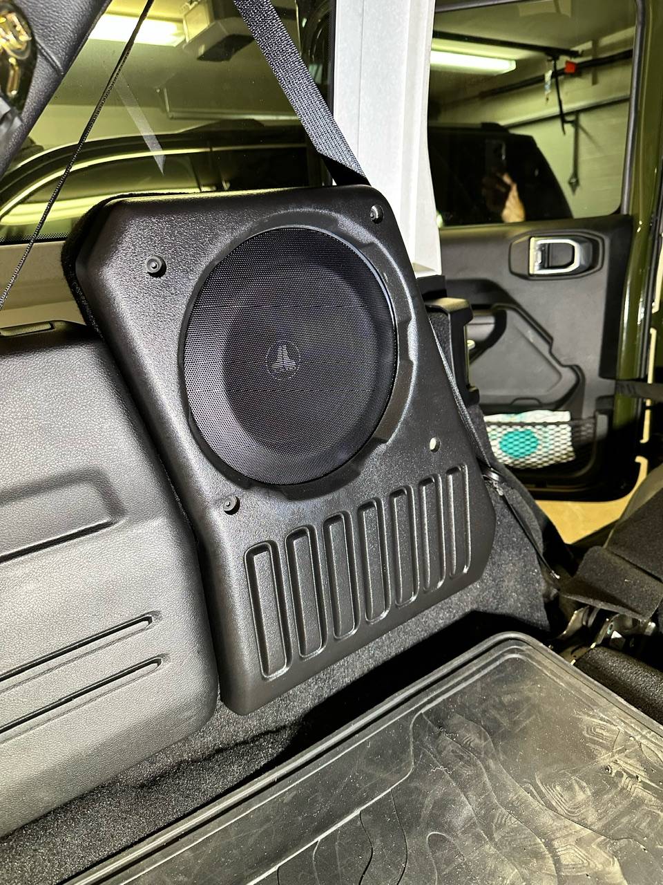

Driver Side 10” 2ohm sub…

Still dialing in the location of everything. I added MDF board underneath the carpet and will use caulk to glue it to the floor. I’ll screw the amp into the MDF. There’s a great factory ground under the loose trim piece. There is a bass control knob run to the dash on the driver-side from the AudioControl…

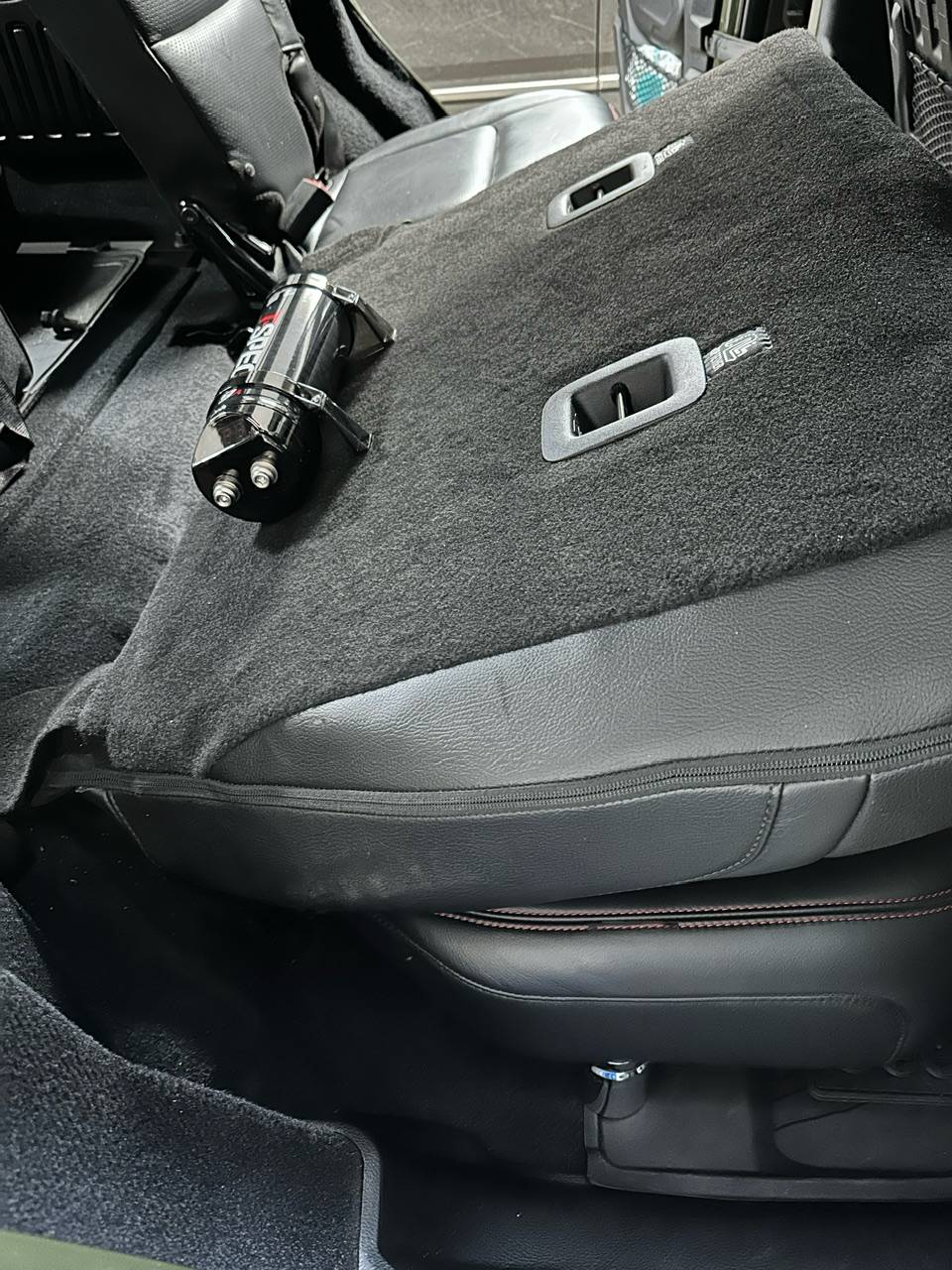

Still debating if I want the cap here or not…
