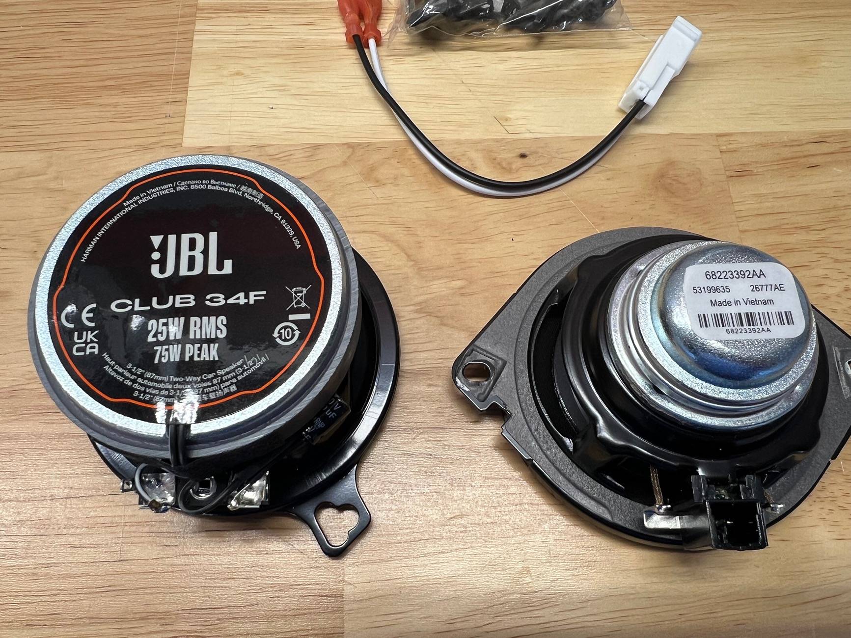

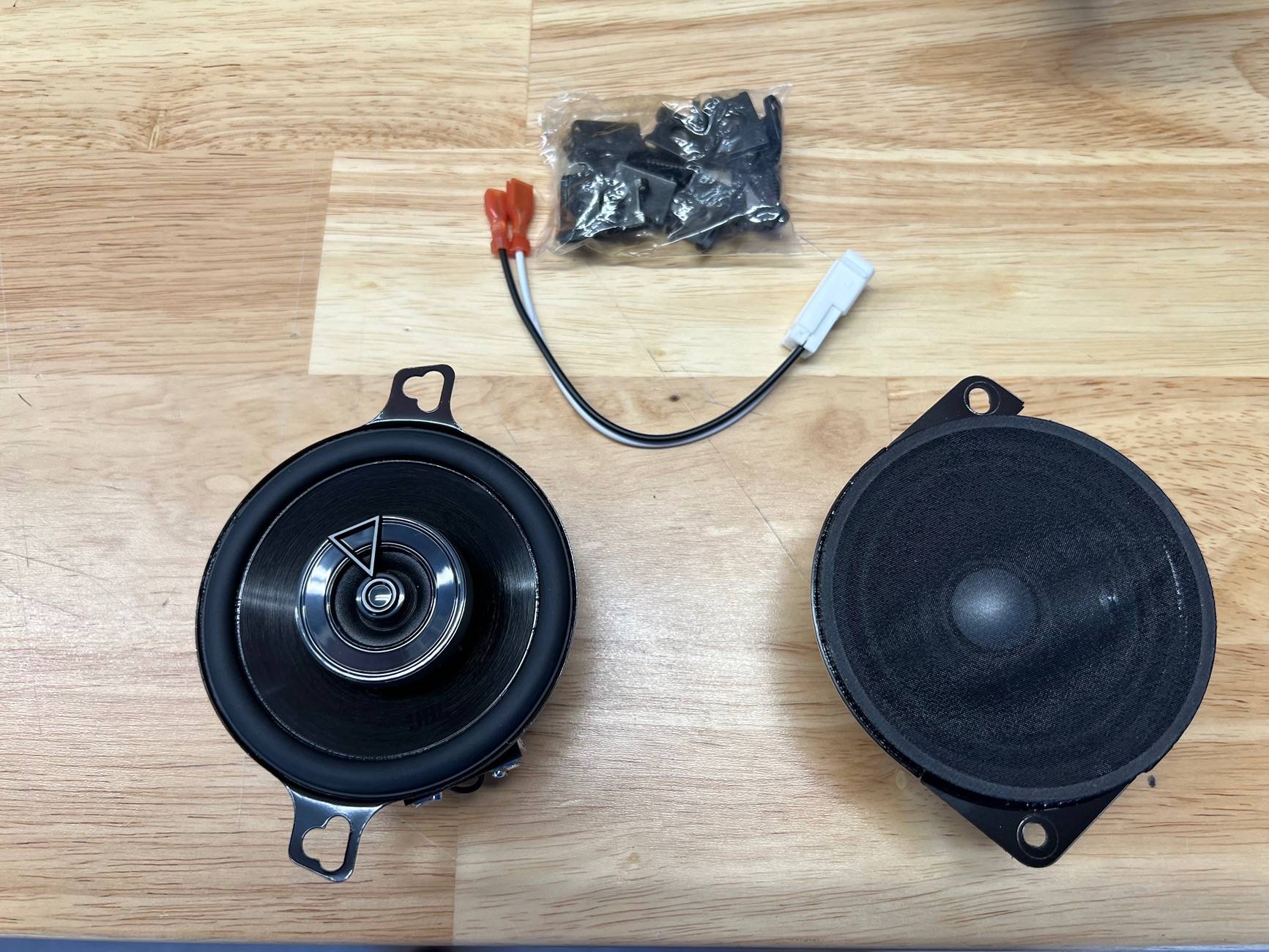

https://www.crutchfield.com/p_109CL34F/JBL-Club-34F.html?tp=105
Comes with the wiring you'll need. A little wiggling to get it seated but a really easy install with no modifications. Definite noticeable improvement but the speakers that @Pismo61 posted are better. The JBL Clubs are great speakers but the AU SoundStage speakers are better. Both are easy install and plug and play.
Side note, I tried several speakers (thanks to a car stereo friend of mine) for the soundbar and didn't see much of an improvement. The dash speakers really brought out the sound though.
Jeep Wrangler JL 2024 FACTORY ALPINE SPEAKER UPGRADE? HELP!?!? IMG_2006
Jeep Wrangler JL 2024 FACTORY ALPINE SPEAKER UPGRADE? HELP!?!? IMG_2005
