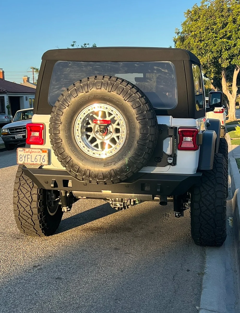

This is a 38” spare. This is reinforced by Teraflex. I say reinforce at 35 inch and bigger.

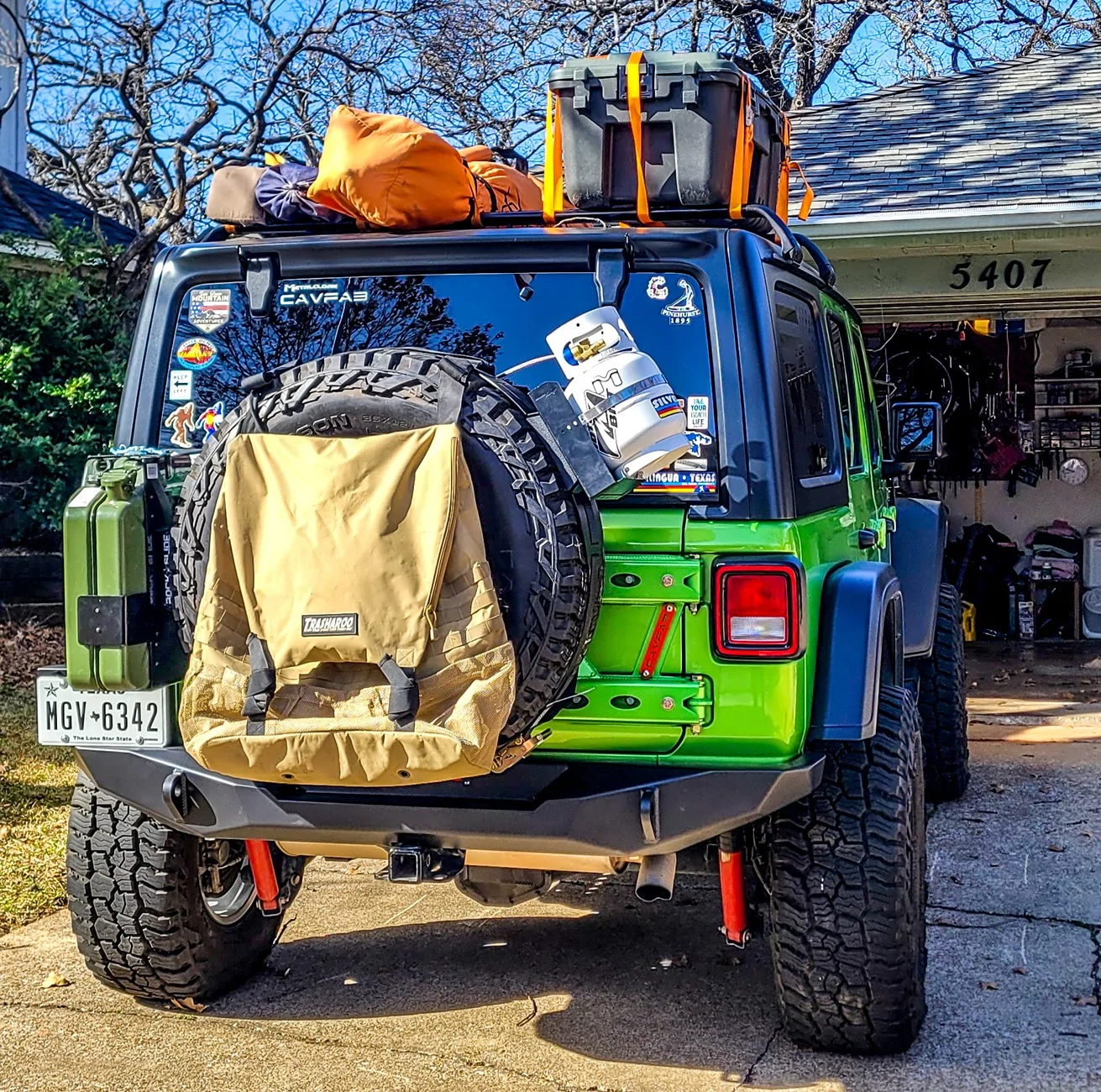

There was no hesitation in installing the CavFab elite spare tire carrier when I went to 35s on Method bead grip wheels. I did not want to have a spare tire carrier failure on the highway that could result in something REALLY bad happening to someone else. I've seen the plastic carriers crack with heavy spares, and I've seen rear gates that sag with heavy spares. I didn't want either of those things happening.
The CavFab laughs at the 35 MT BB AT on the Method wheel. It laughs when I load it down with 5 gallons of fuel and a 5 pound propane tank (the mounts for these things aren't light...).
