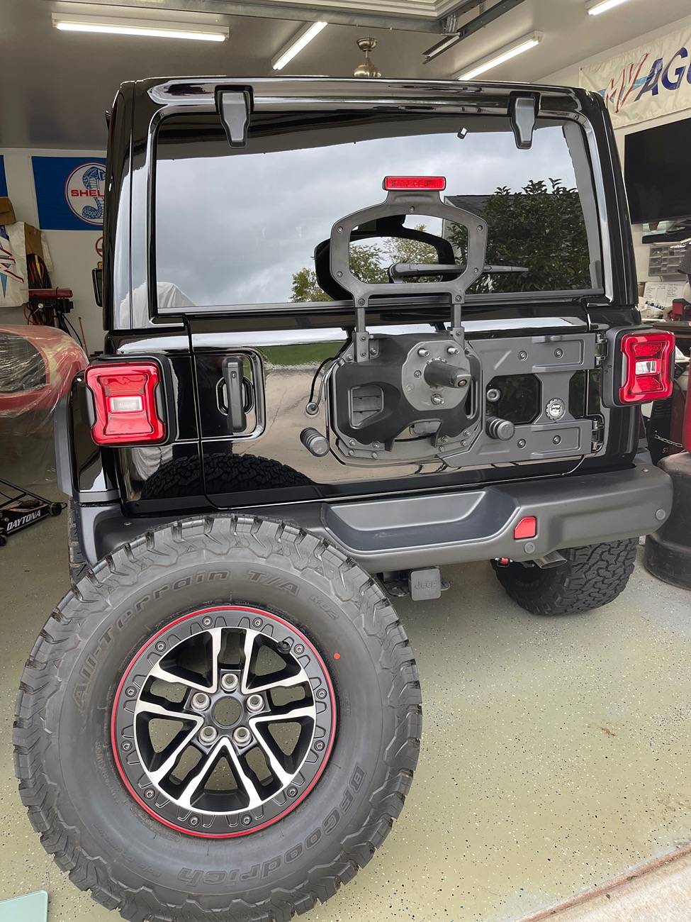

Ordered this from Extreme Terrain. I agree with the other posts, it is not really needed for a 33" tire, I just wanted something extra. This item is $80, is made of aluminum, fits well and looks good. One word of caution, this will step the tire away from the factory rubber stops by about 1/2". As others have said, this is not good. The tire should be in firm contact with the rubber stops at all times. An aftermarket rubber stop kit solves this. They run another $25 or so from Quatratec.
