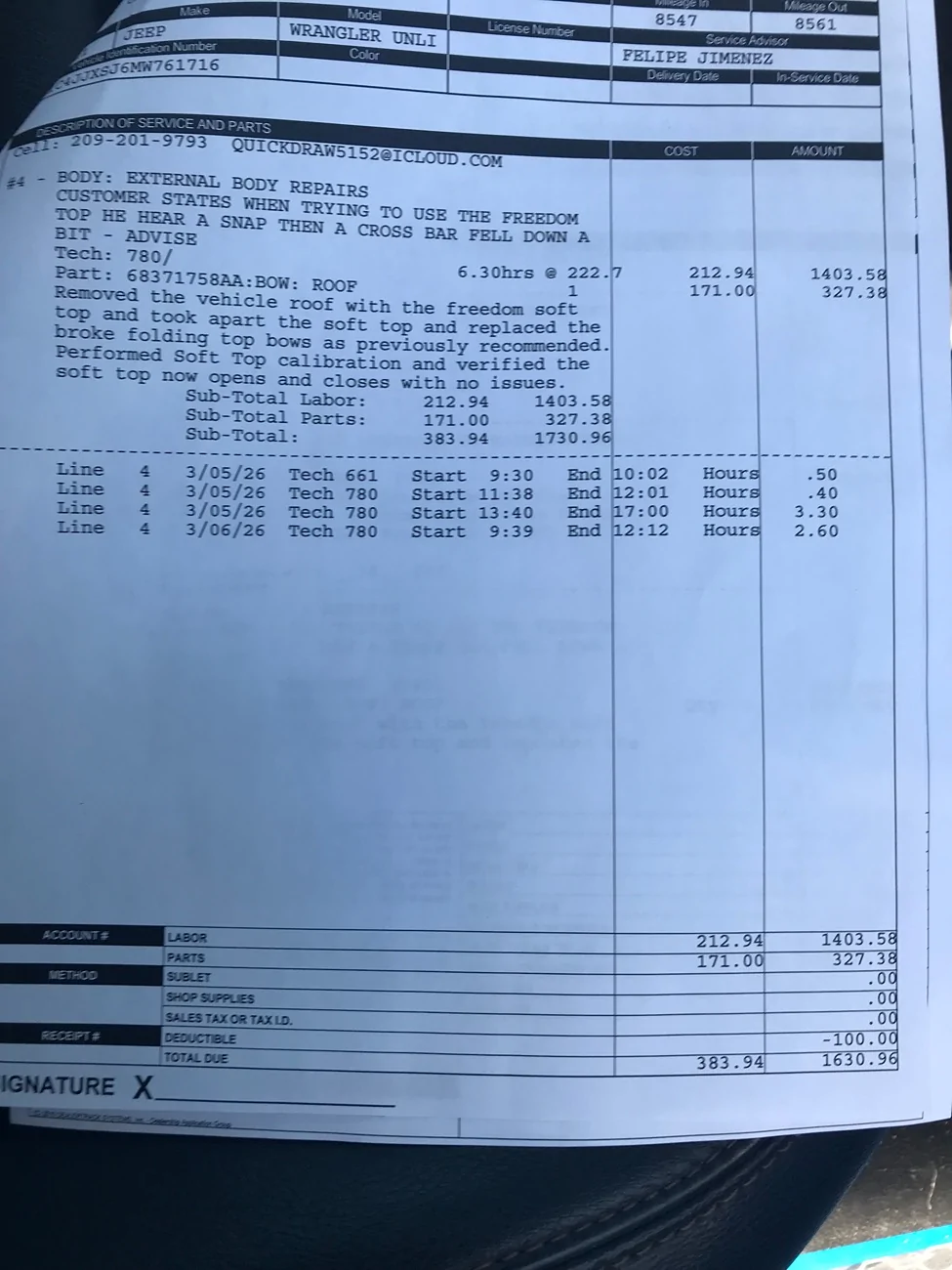

Look up at all the crossbars….. just one broken Plastic track end a $1.7K repair
Max Care covered minus deductible
That’s crazy. It would be great if there was an aftermarket option for repairing broken pieces, especially because it’s a fairly common option on a lot of Jeeps out there anymore.
2nd 392
Jun 20, 2021
10,223
17,115
Ca
1 cross bar 2 bar section, one on the track the other folds up. But the top has to be removed and partially disassembled to weave the new one in. Mostly labor
