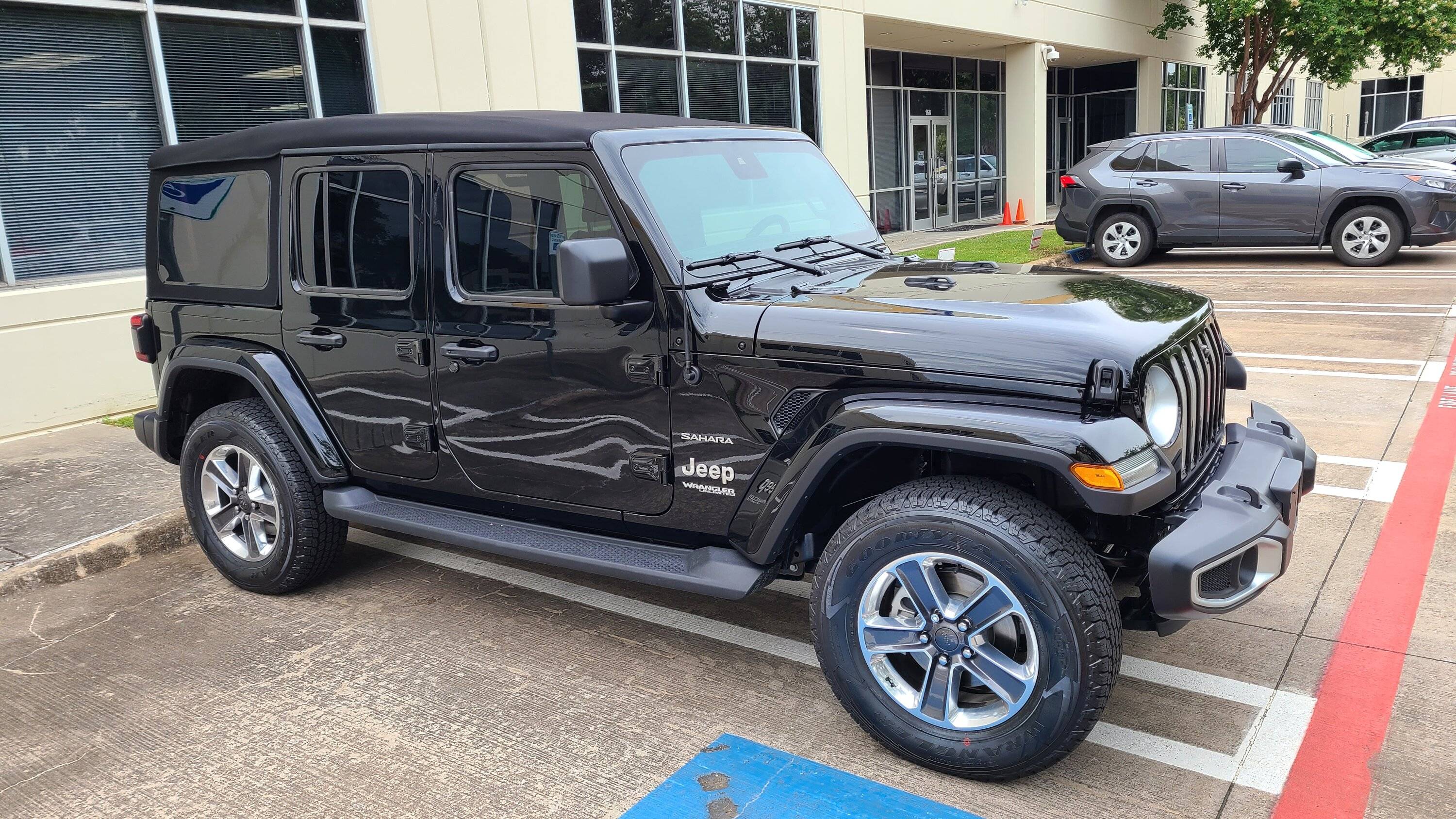

We had the soft top windows wrapped in Stek paint film. They did both inside and out and it looks great and no scratches yet. I cannot tell a difference.
