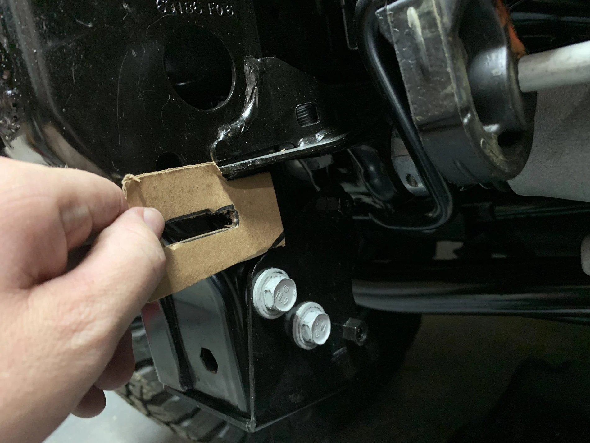

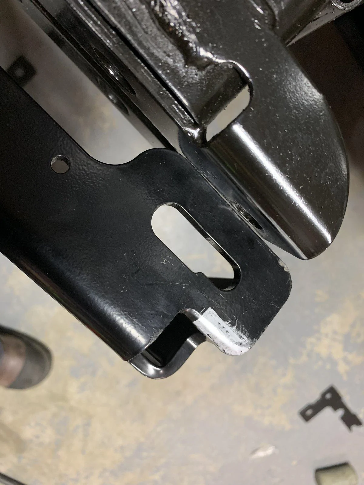

I just installed my winch with the Maximus plate Saturday night. I ran into fitment issues, at no fault to their product. There’s a mount that is welded ~ 3/8 lower on the pass side then the driver side. I had to cut away at the plate to make it work. Came out good tho. Had to fool around making a bracket for the Warn interrupt kit so this took a bit longer than expected.

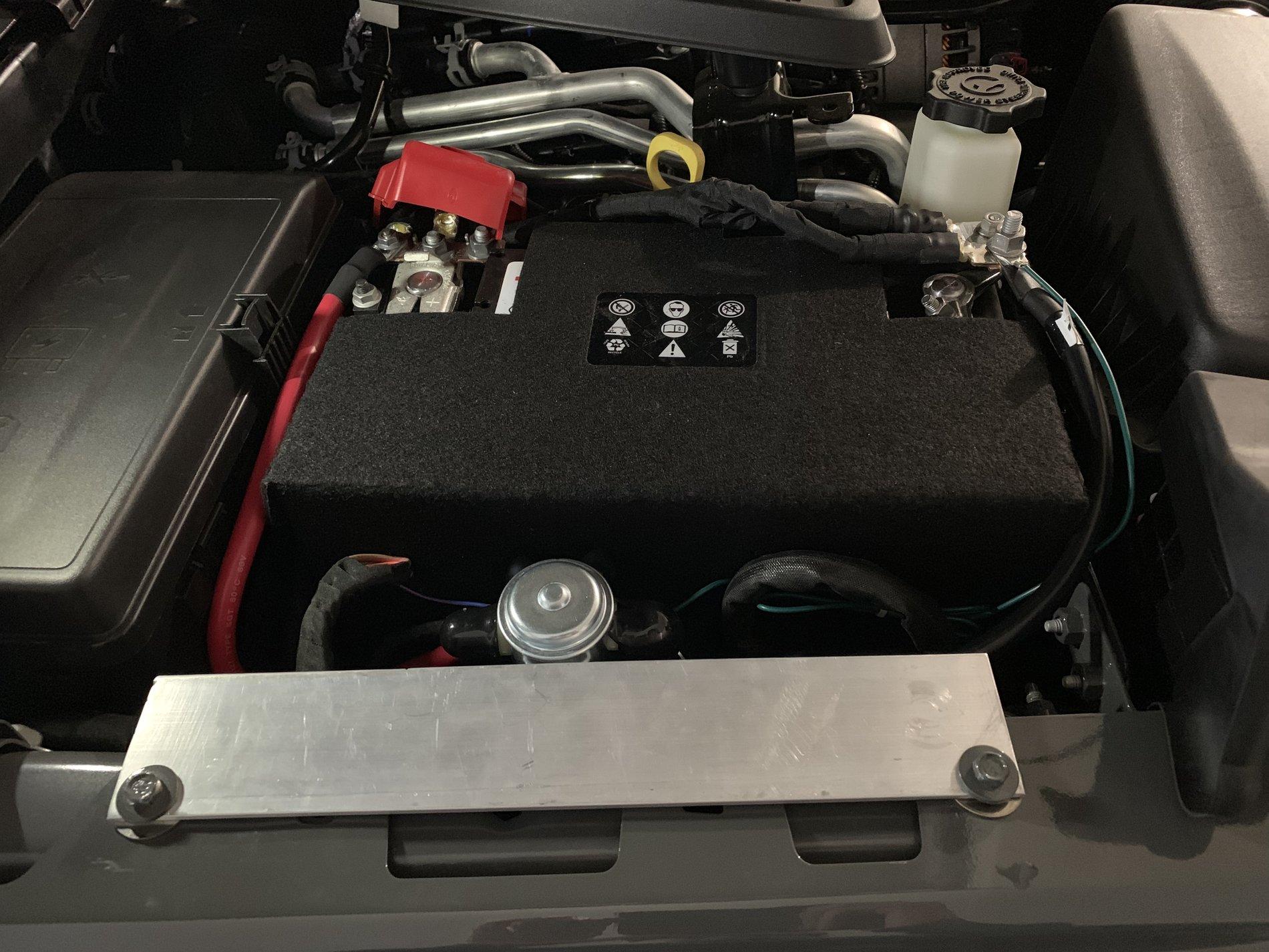

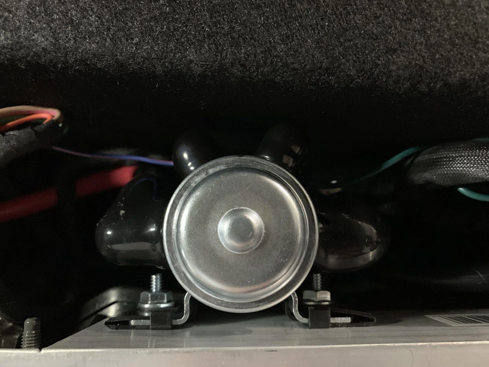

Hooked up the winch last weekend, but got called into work by the end. Finally finished wiring up the Warn Interrupt to the Aux switches yesterday tho. Tested & confirmed - it works! Not too tough of an install. Hardest part is figuring out how to mount the solenoid & making it look half way descent.

Could you not wire the aux switch in place of the control box on/off switch? It wouldn’t be on the main power side.
