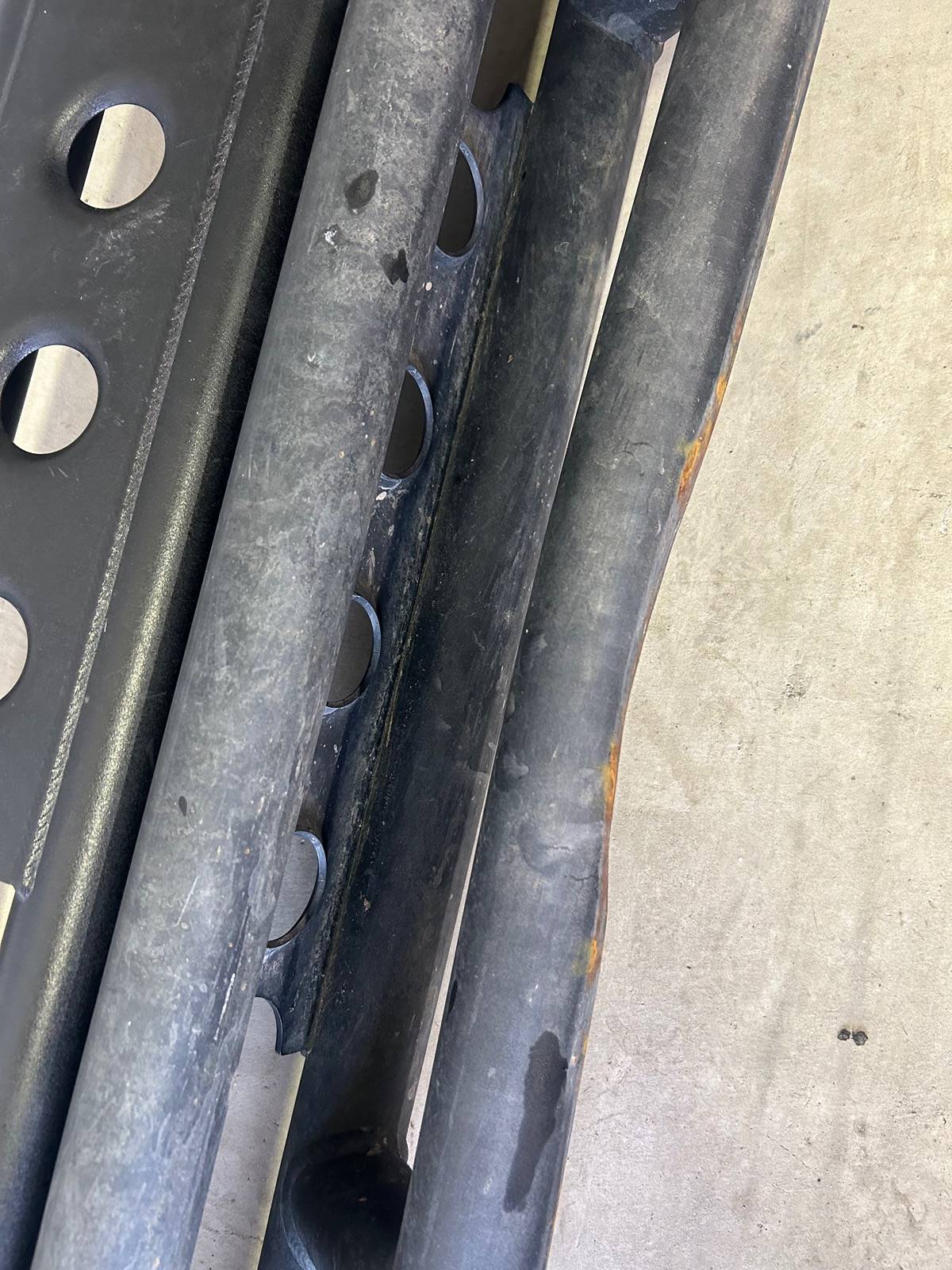

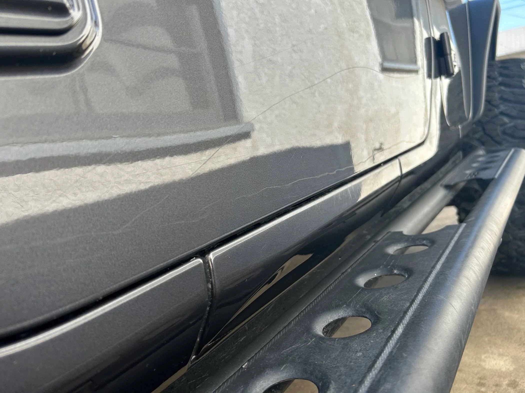

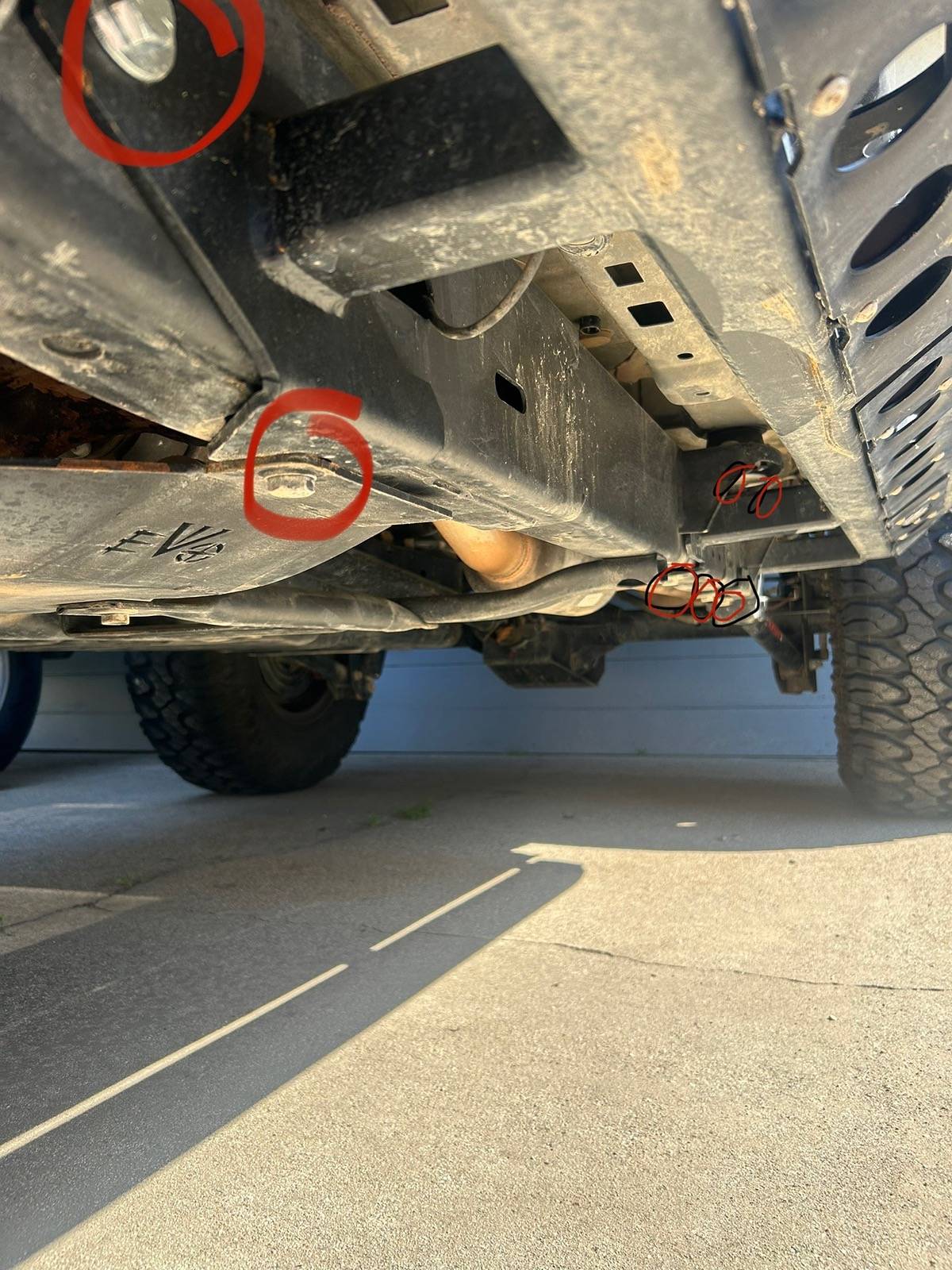

I’ll be up front. I had the smittybilt step sliders.if you don’t plan to wheel harder than easy trails they’re great. They hang low and push rocks from the body nicely. But beware you get what you pay for. I now have to large dents under my front driver and Front passenger door sills from coming down a little harder than I normally have in the past.. if you remotely plan to get into anything harder than mall crawling and easy fire roads than I would 100% save for a few months and get a better setup. I change my sliders to L.O.D sliders and at a hefty price but I have much more confidence in these LOD step sliders than the smittybilt ones. As for the Amazon ones you have pictured those mounts look extremely weak even compared to the smittybilt units. Note that the smittybilt only bolt around the body bolts with a couple of smaller 3/8” bolts z where as my LOD sliders now bolt up with the same six as the smittybilt plus 6 frame bolts. Which actually keeps it from hitting the door sills
here’s a picture of the driver door sill
the second picture marking out a few of the frame bolts on the LOD sliders that the smitybilts didn’t have that caused it
also a third Picture of the smittybilt bend from the rock that punched the whole step into the door sill

Do you think the stock Rubi rails would have caused the same damage or would they have handled it better than the smitty? How low do the smittybily sit? Doesn’t appear any lower than the frame itself?

Do you think the stock Rubi rails would have caused the same damage or would they have handled it better than the smitty? No , I believe the factory rubi rail would have hit as well with how hard it came down unexpectedly .

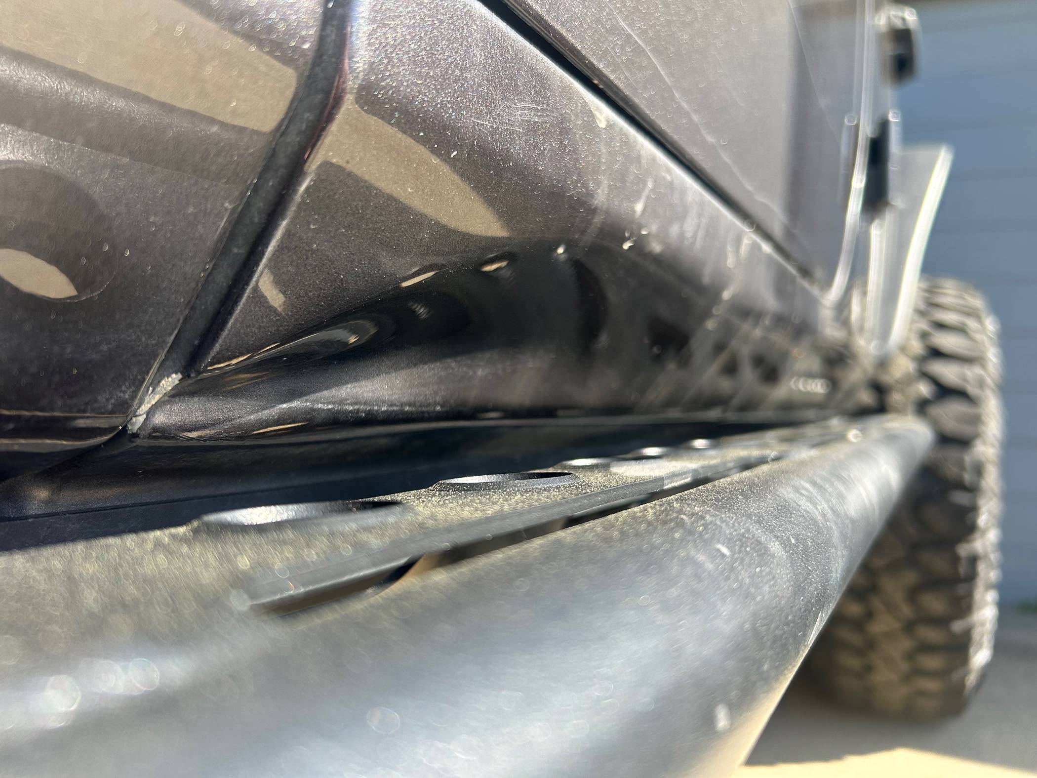

How low do the smittybily sit? They sit about 1/2”-3/4” above the frame rail. I found they touched a lot when doing easy to moderate trails come paired to the new LOD sliders I have now. Doesn’t appear any lower than the frame itself?
I also want to mention that the LOD slider is a step as well
Added a picture of the gap between the door and the smittybilt steps

Those sit about where I thought. Which is something I’m looking for. Amazon, red rock and quadratech all have sliders that sit super low and you can see the pinch seam. I like the aesthetics of the Smittybilt but not loving this story of how easy they flex. I don’t plan on any crazy crawling. I’m in Florida, not a lot of that but I don’t need a happy accident either.
Appreciate it, I’ll keep looking out there for something that looks as good as the Smittybilt.

Looking at the LOD signature, they appear to mount exactly like the Smittybilt… there are optional bolt holes but I don’t see how these help with the stability of the slider.
Martial Fartist
Martial Fartist
Christopher
May 8, 2021
56
414
578
Spring Hill, Florida
Do you believe the square tubing makes the lod stronger? Anyone else have the Smittybilt bend up on them?
