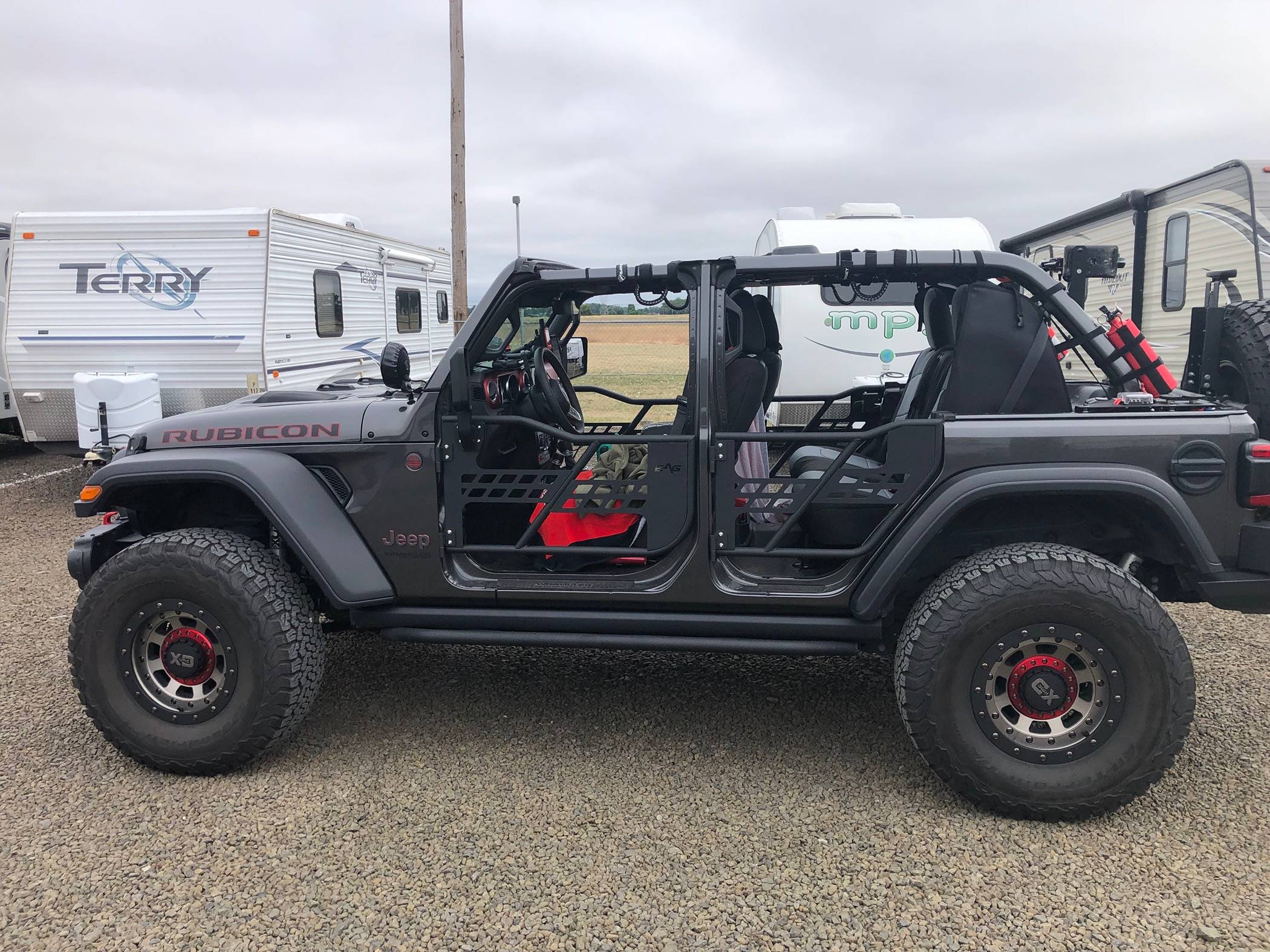

I confess to buying these Chinese sliders off of Amazon. They were extremely stout and very heavy — and about one-third of the price of the American made alternative from a company in Michigan. I had myself convinced to buy the American ones until they told me it would take “eight to twelve weeks“ to ship. Apparently, they were as busy as they wanted to be.
I don’t think anybody has confused Smittybuilt with quality since it was purchased out of private ownership (40 years ago?).

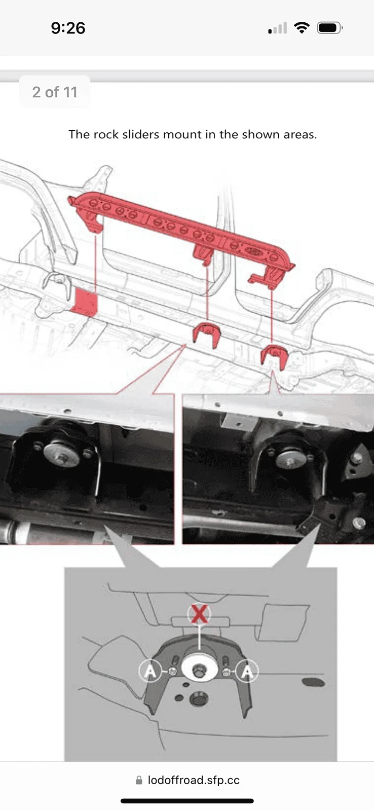

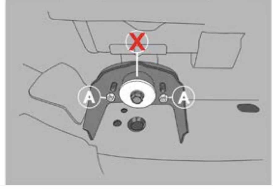

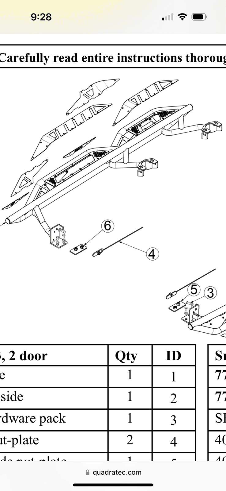

They appear to mount exactly the same as the lod
Look closer ... the back two mounts on the Smittybilt appear to ONLY mount to the body mount bolts. The LOD ones also bolt to the frame. The LOD would be much more rigid and should take a hit better.
Martial Fartist
Martial Fartist
Christopher
May 8, 2021
56
414
580
Spring Hill, Florida
Yeah it looks like it uses those 2 bolts the same but what it’s bolted to is attached to the frame right? Looks to be welded The extra bolt hole to the frame is a nice option but it’s just 1 more bolt.
If the smitty will bend up into the door I’d imagine it’s not because of the mounting but the integrity of the round tube vs the square of the LOD.
