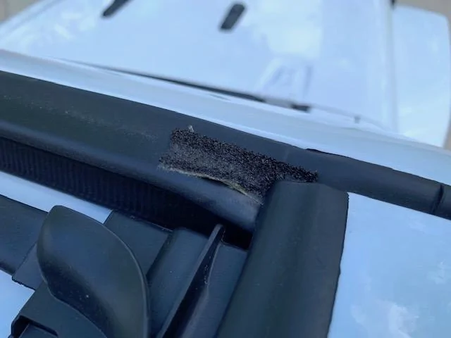

Here's a picture of the fix. As you can see, it's barely noticeable. Definitely made a difference in the noise on the passenger side. Now the normal wind noise is evenly distributed from left to right.

I have the same issue. Where is that fix? Can’t make out what they did?

It looks like a strip of velcro. It probably just breaks up the air circulation causing a reduction in wind noise. It looks like it would lead to a leak problem. They should have replaced the whole seal instead of that little temporary patch.

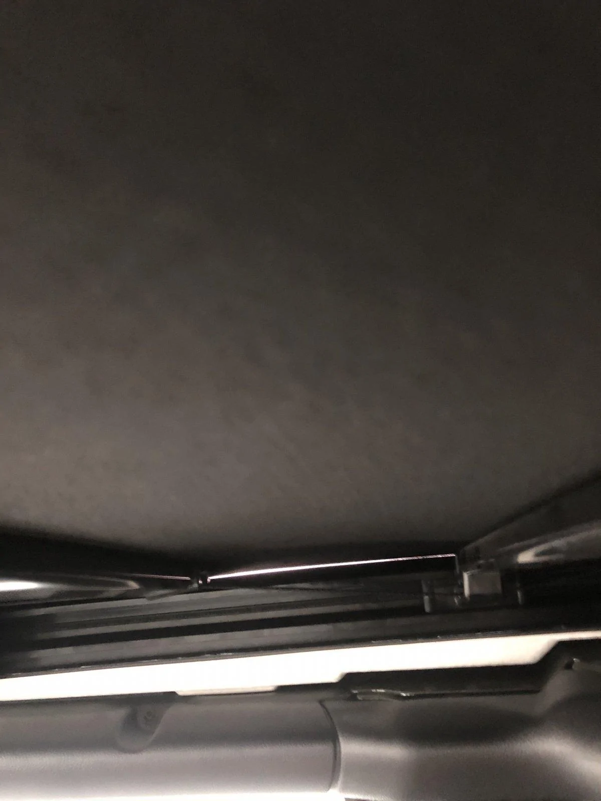

Here is my experience with a brand new one. At higher speeds of 75mph plus the top seems to lift on the passenger side. Then I was also able to notice the same on the drivers rear side. Had cross winds today. Seems that turbulence behind trucks caused this go be more noticeable. Almost like there isn’t enough tension holding the top down. Below 65mph, no issues.
Did you notice anything like this?
