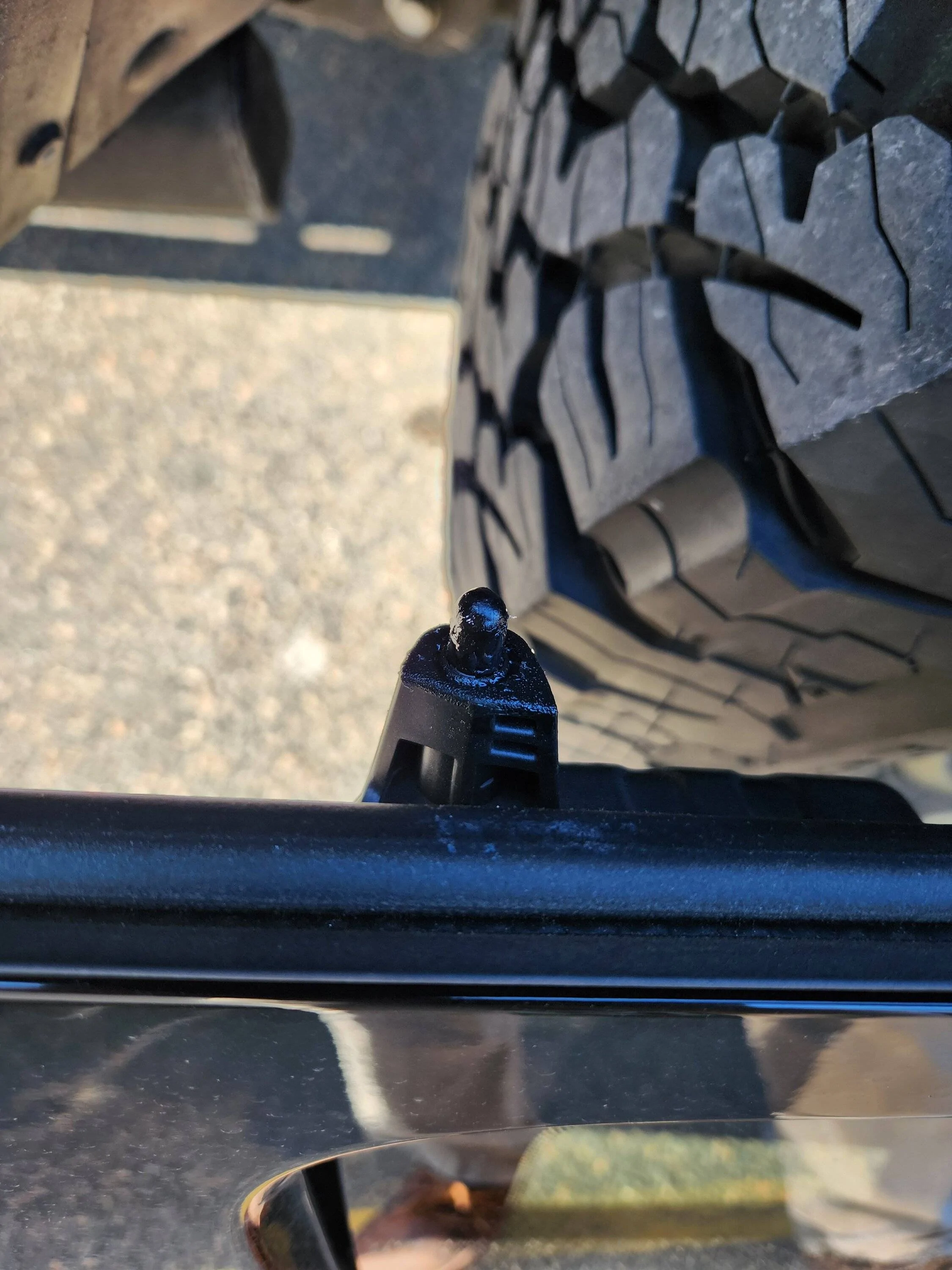

I ended up finding the cause to my annoying rattle from the rear. I did 2 fixes I'm not sure which one it was but either way the rattle is gone!....first i took off the back windows and put some lube on the spring pins that hold the windows in place. made sure to press them in a bunch to so the lube got in there and they worked smooth.

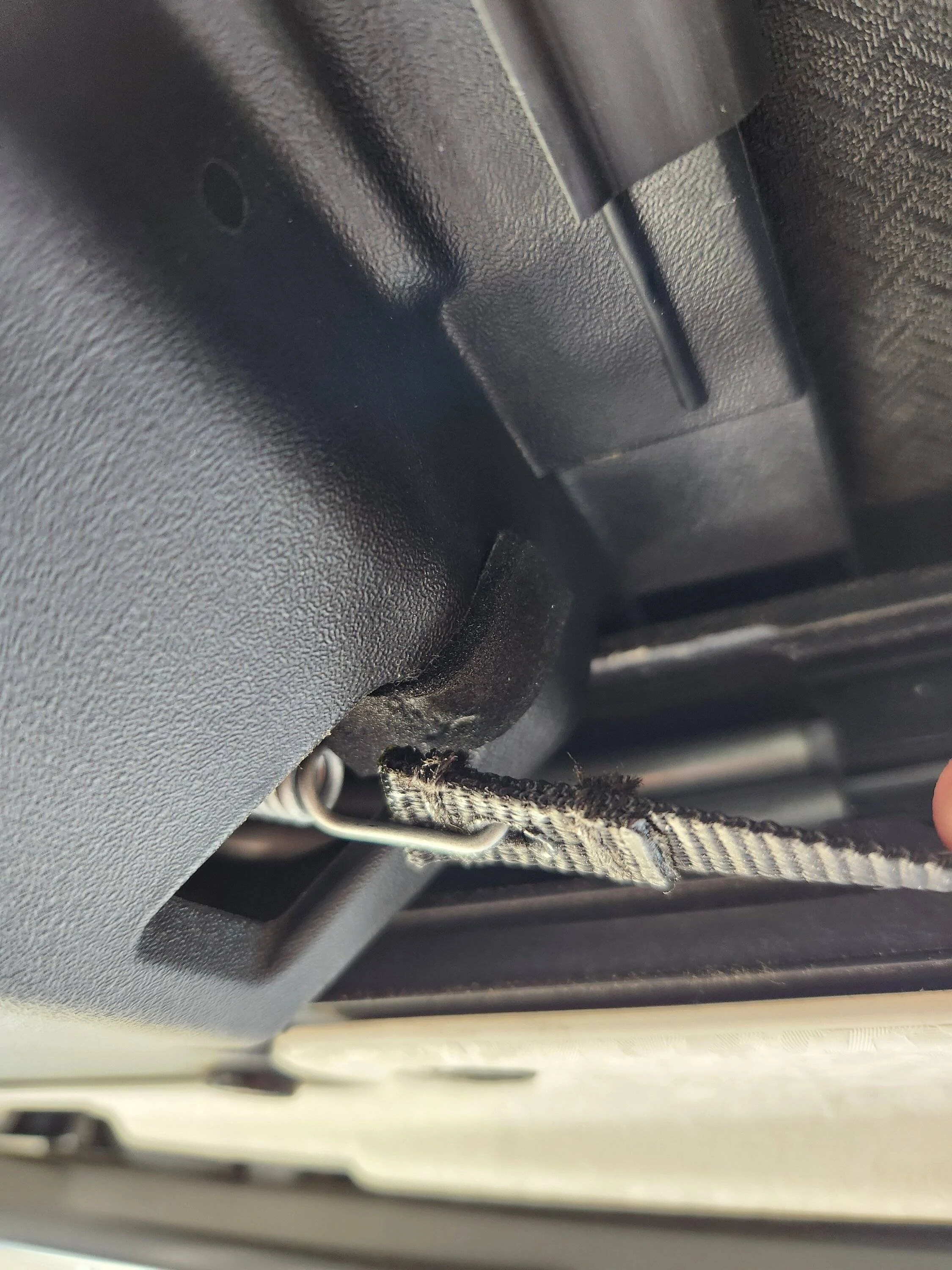

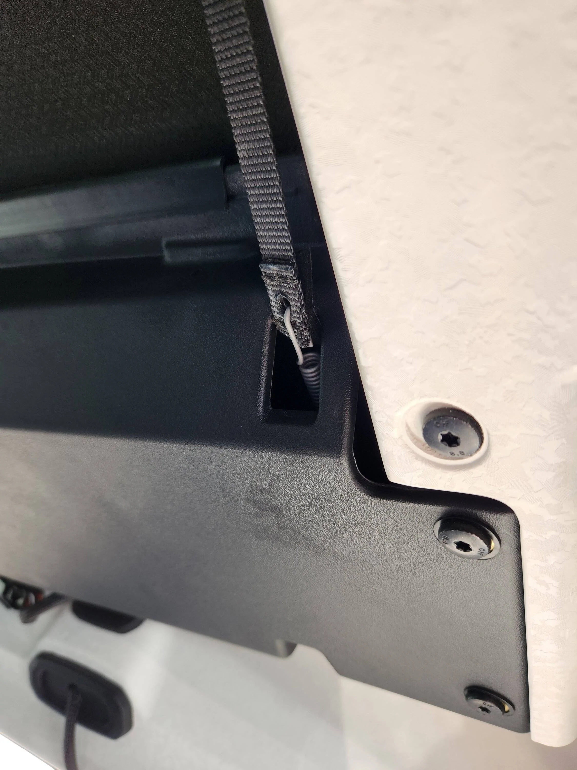

this is what i think really solved it. in the back theres a metal part that holds the top to the back.
above the rear window and on either side of the metal "plate" there are these small metal springs, 1 on each side. the springs hold the tension on the black strap the runs the length of the top on either side.
i think the metal springs are clicking up against the metal part making noise. so i put some foam tape above the spring on the metal part on both sides......See pictures of the fixes

I attached Pictures to my post check them out.
Don't bother going to the dealer for this. it should take you like 5 to 10 min to try these 2 fixes to see if they work. if you go to the dealer they will charge you a ton of money for no reason
