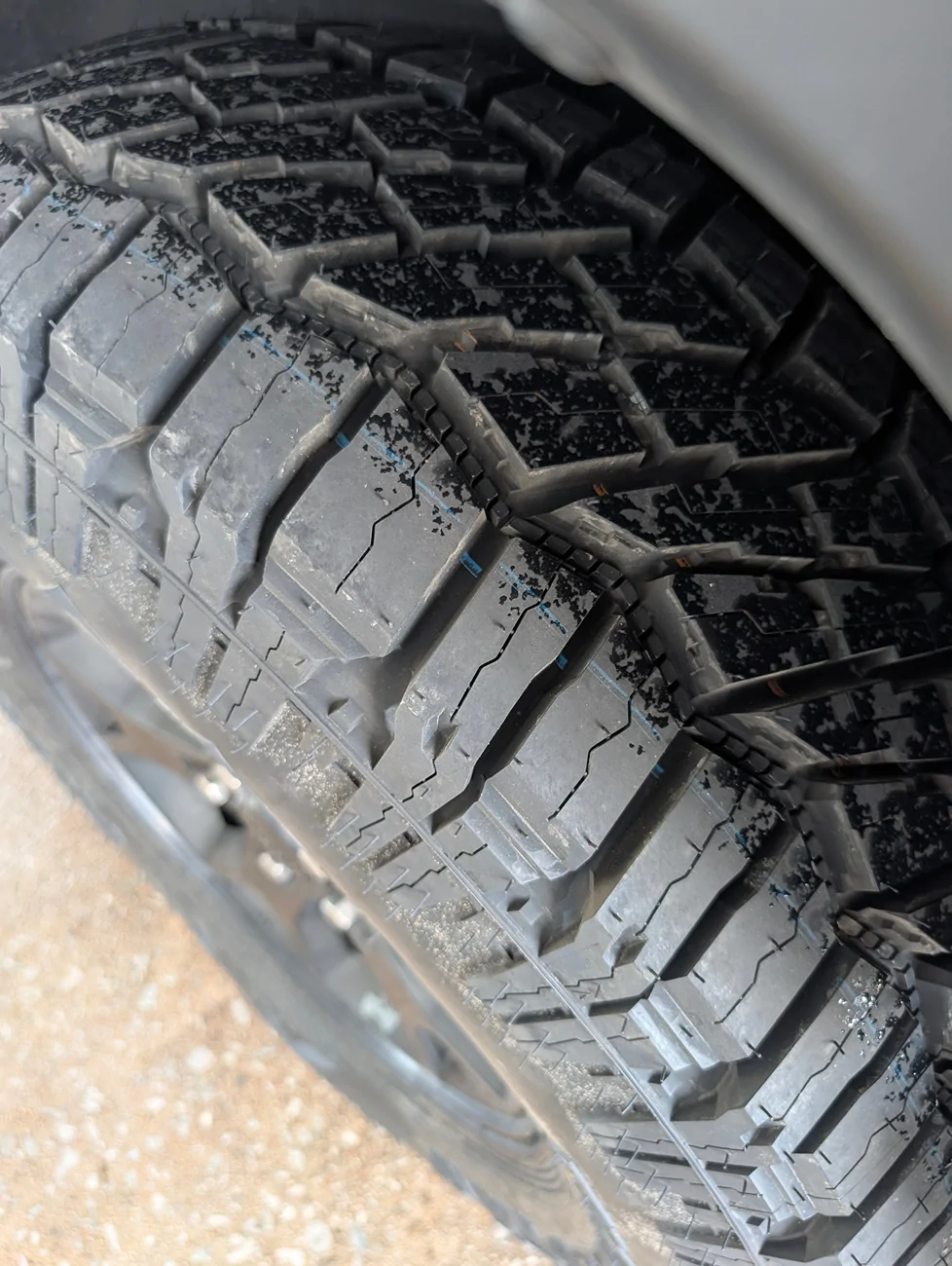

New tires unfortunately load range E they are Patagonia xt 285/75/17. This is what it looks like when it gets wet pulling into a car wash bay. I don't have chalk to test that way.
Should I air down more? I'm sitting at 34 psi cold these were probably at 36 in the car wash or 35psi.

Yes. Air down more. Try them at 28 or 30. I run my 35s at 25 cold to get a good test.

Pressure can help some, but wheel width is also in play. If the wheel is too narrow the tire can sit as shown in your pic where the outer blocks don’t contact the road.

The Patagonia isn't a square pattern tire. The tread is supposed to be crowned. I wouldn't go below 30psi on a tire that small.
What’s the advantage of a crowned tire that sees on road and off road use?
I think in theory it would handle/ride more like a narrower tire on the street while still offering the huge contact patch when aired down for wheeling. Could in theory help with mpg and wet traction.
