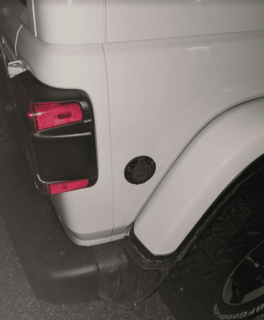

Passenger rear quarter:
Jeep Wrangler JL Shore Power - AC input 1655942280064

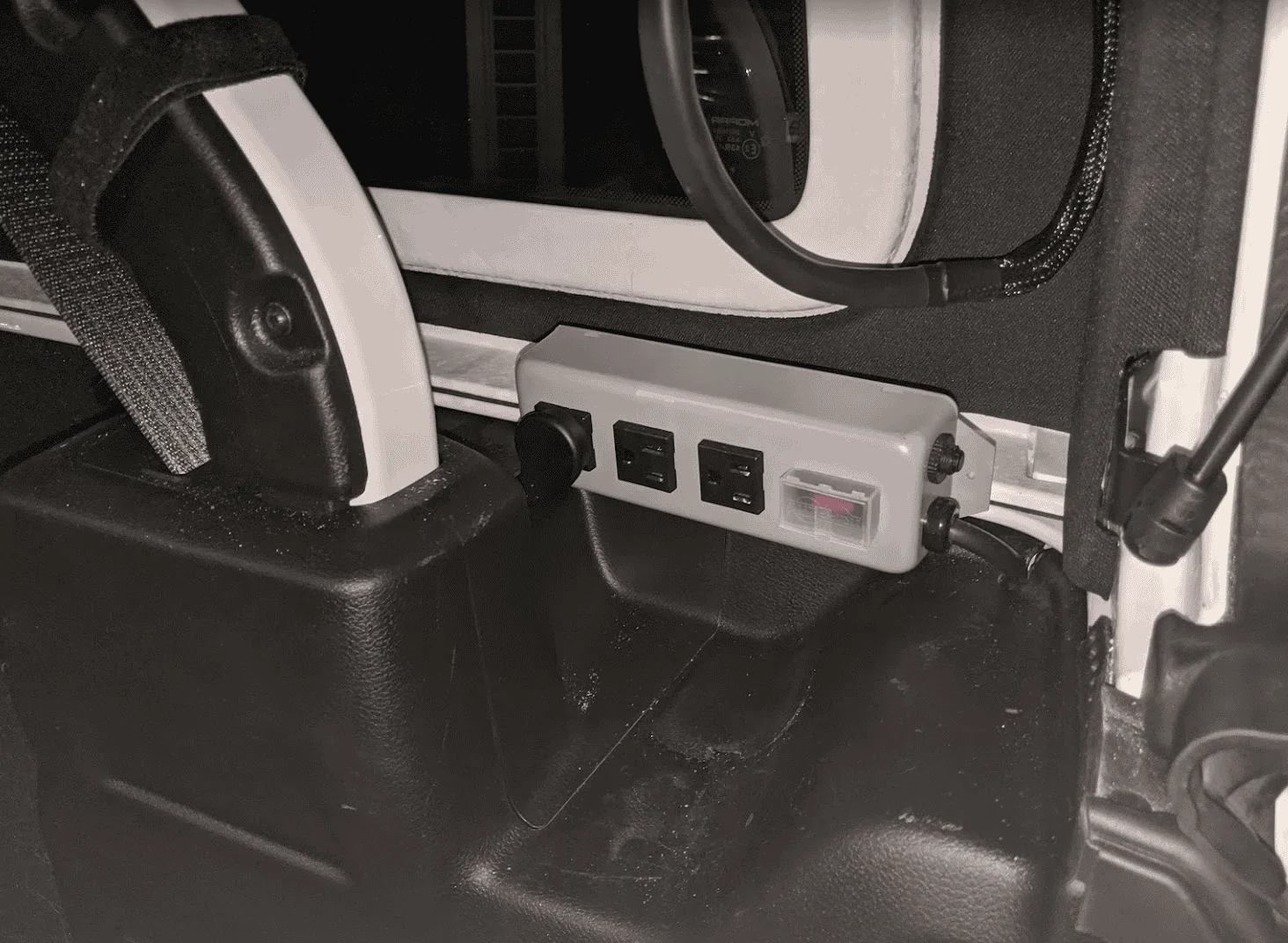

Runs to a power strip in the cargo area, with one outlet to a Redarc BCDC that charges my house battery:
Jeep Wrangler JL Shore Power - AC input 1655942460148
