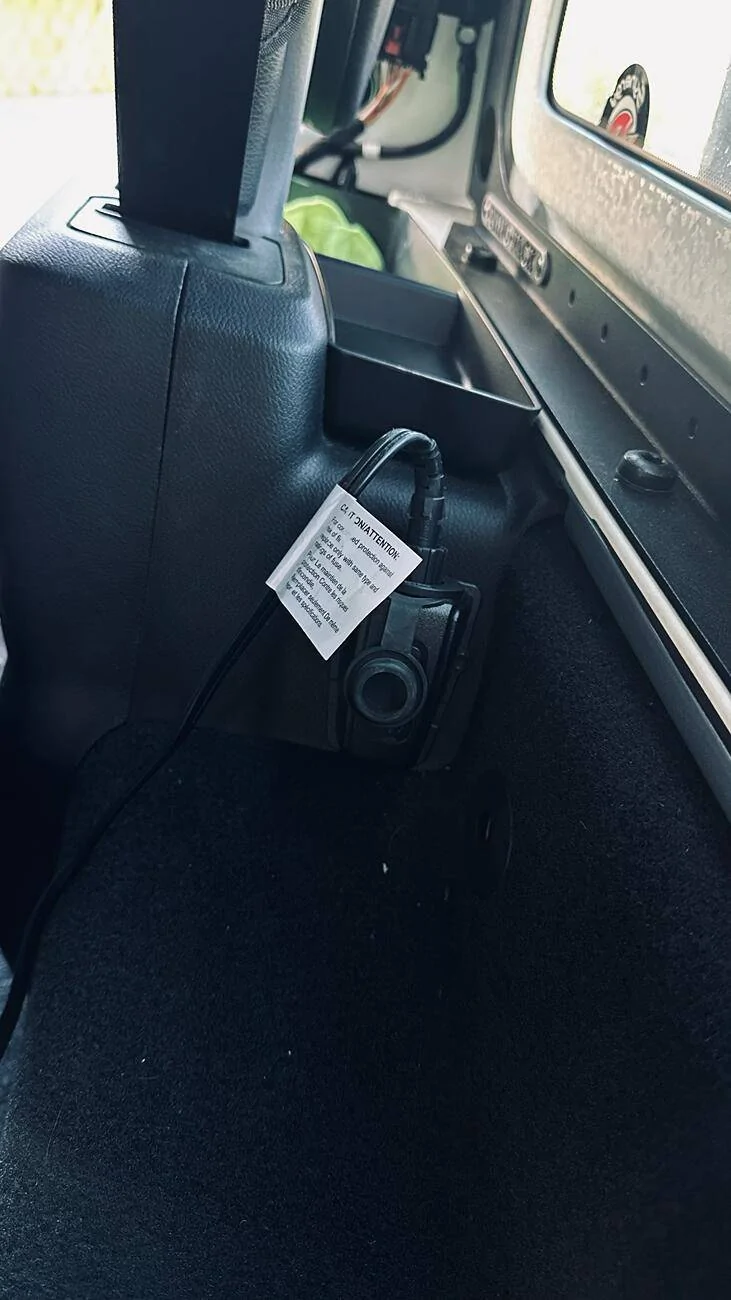

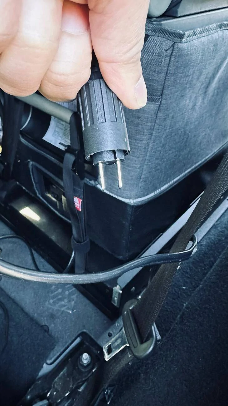

I have wired the ARB wiring kit from my AUX battery in my engine bay (I have the genesis dual setup) up to the ARB threaded socket that came with the wiring kit in the cargo area. This ARB socket plug has the threaded socket which works fine when I plug in my ARB fridge 12v input by unscrewing the barrel connector so that I just use the 2 prong plug into the ARB socket.

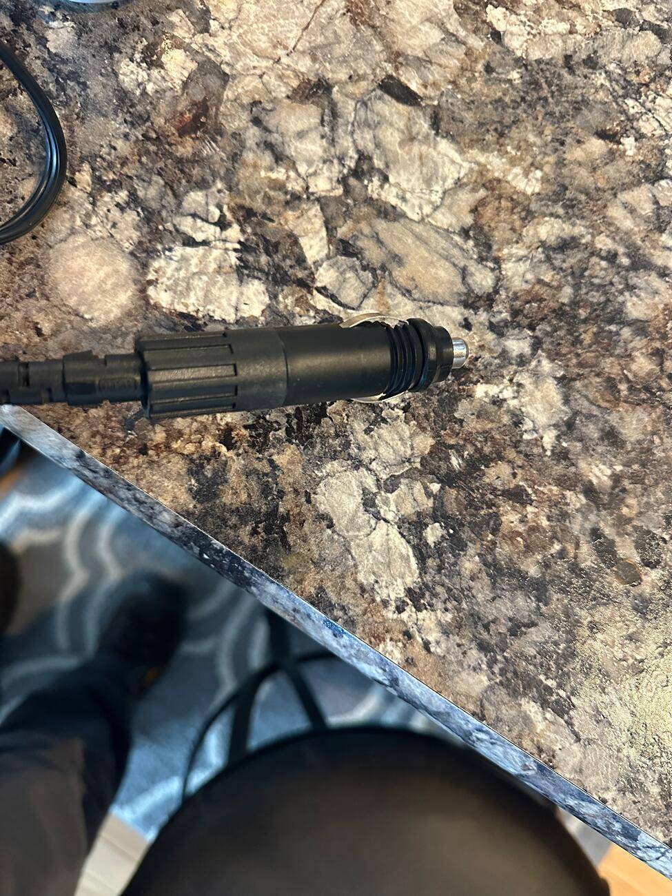

But lately, I have been wanting to plug in my Jackery 1000 12v input into that socket instead so that I can run my fridge off of my Jackery instead of the aux battery in my engine bay. This of course doesn't work since the barrel connector of the Jackery is not threaded and am not able to unscrew that to plug into the ARB socket.
Any tips on how I can solve this ?

I’m taking about the input into the Jackery , not the output.. That ARB threaded connector can only fit the output socket of the jackery. Makes sense ?

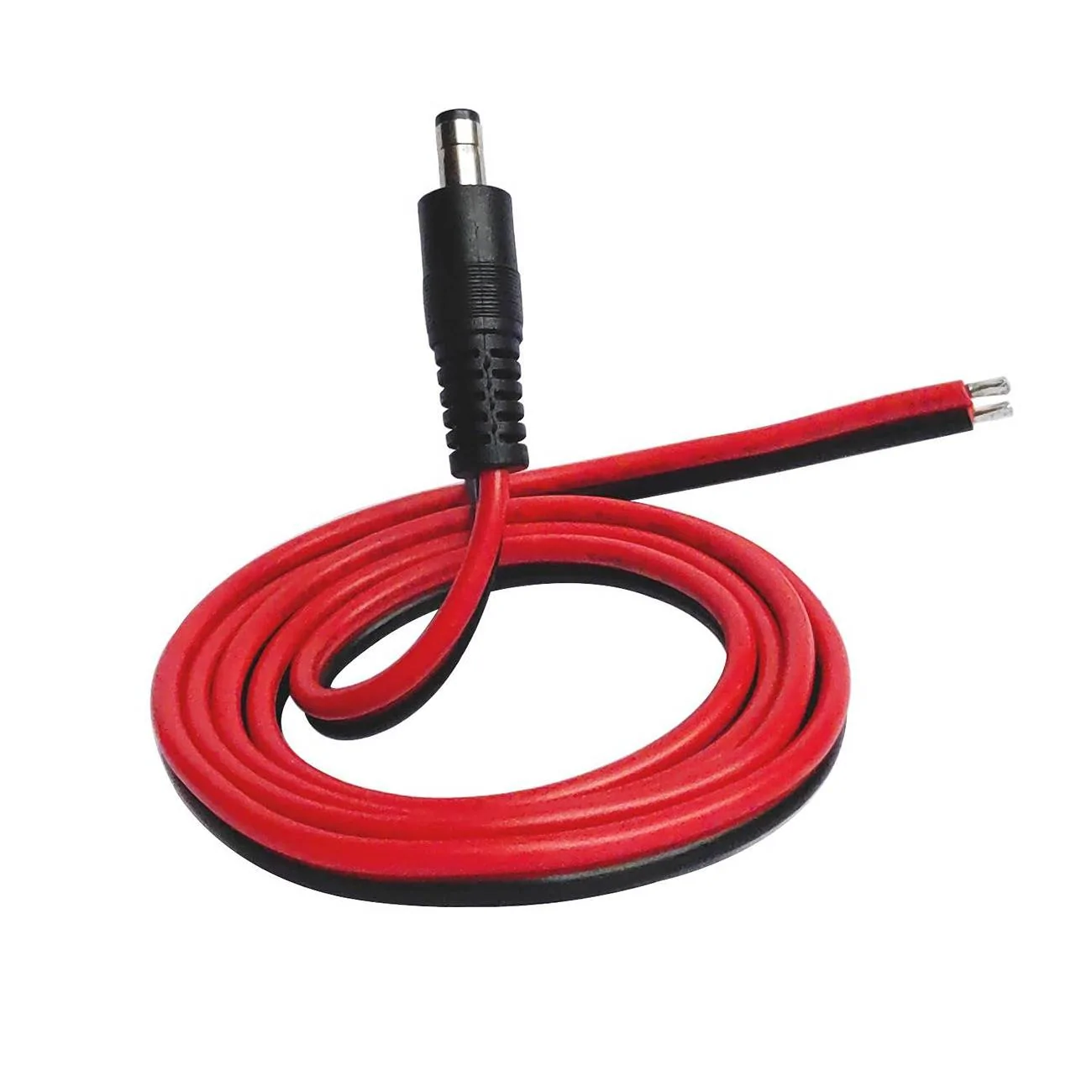

you could cut the 12V plug off and put on the ARB end. they are spendy tho. I have actually looked just for the mail end by itself.
THAW
Foster
Oct 28, 2022
2,208
3,039
PNW - prefer Middle of Nowhere
23 JL4DrRubicon
Seems like you'd need to cut the male ARB connector from the ARB cord (or buy another cord to harvest the connector), and crimp it to a male 5.5mm x 2.1mm pigtail.
