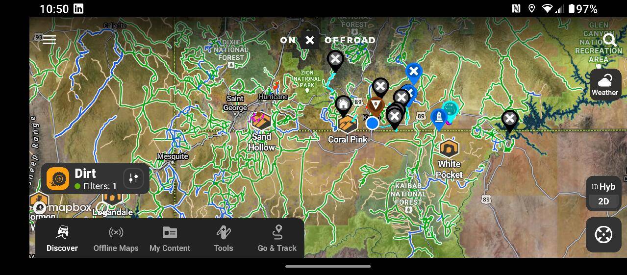

I'm close to many offroad options, so I don't have to drive too far for fun. This is a screenshot from OnX Maps of trails from my home base, and many are still unmarked. So you are correct, I don't drive a lot (from a mileage perspective).

Yeah, I tend to use Trails Off Road a lot more now due to a similar level of what can be perceived as noise with OnX. OnX has its uses, but I prefer to focus on quality over quantity when looking for new trails.
