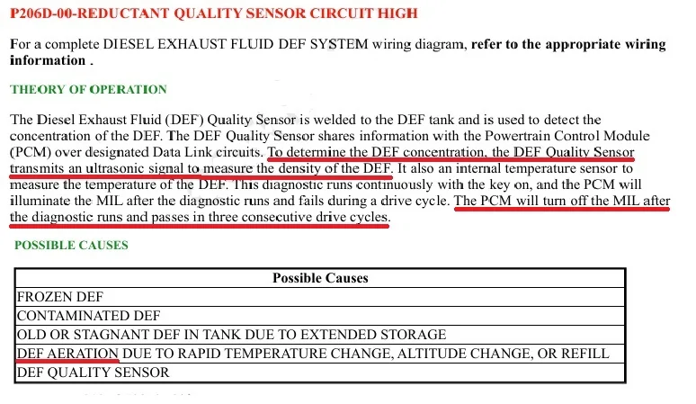

Sounds to me like the cause of your code is aeration of your DEF when you're bouncing around offroad.
DylanM, That's a great find - where did you find this information? And thank you!
The DEF aeration could be the culprit, or the rapid altitude change. The error has not occurred for me without both of those items happening.
With the Error now clearing itself (as opposed to it previously being a "permanent error"), the error message should be changed from "Service DEF, See Dealer" to something less onerous.
