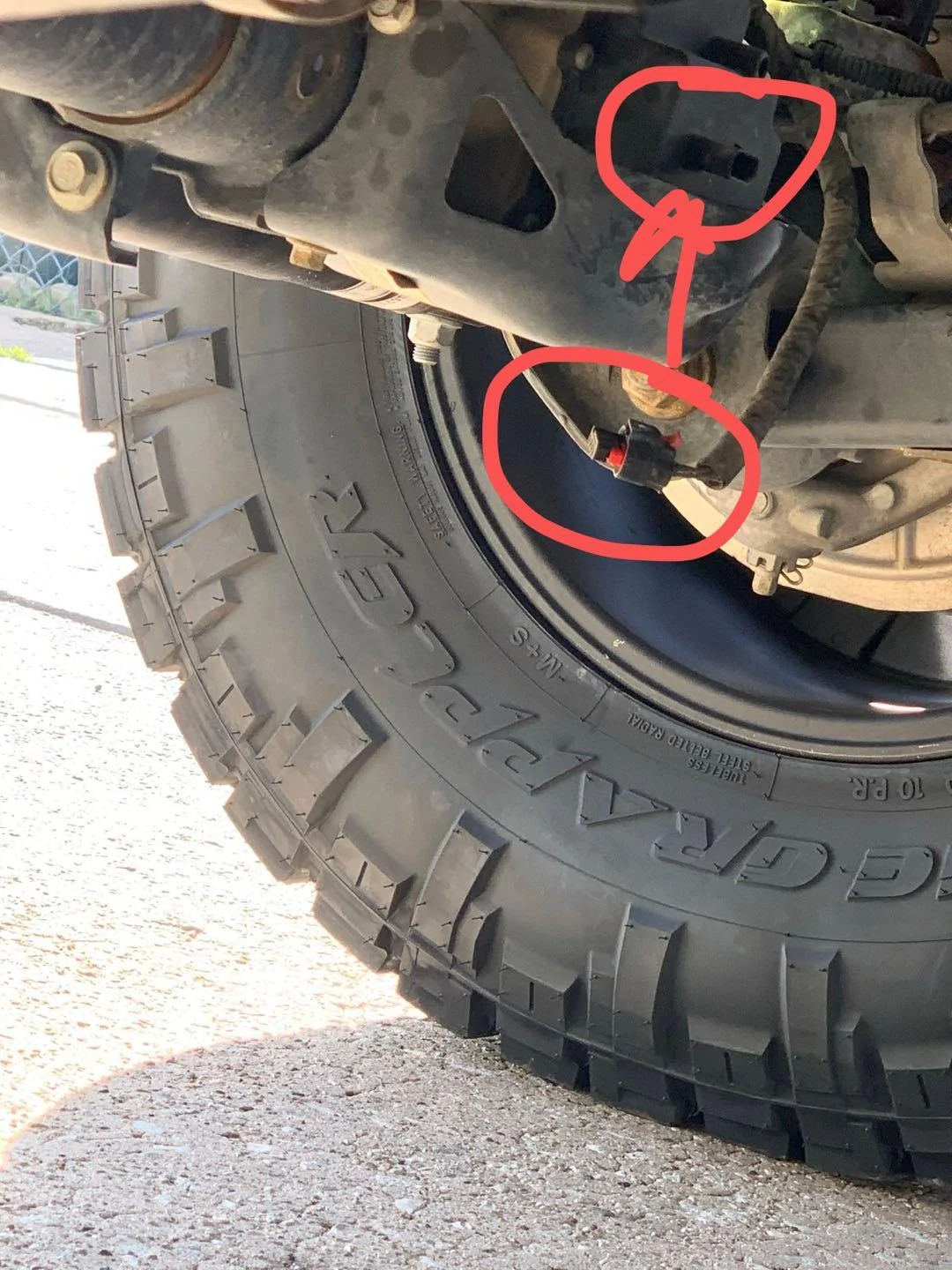

BCBA
Mine had this wire disconnected. Check yours. Maybe it’s not plugged in all the way.
