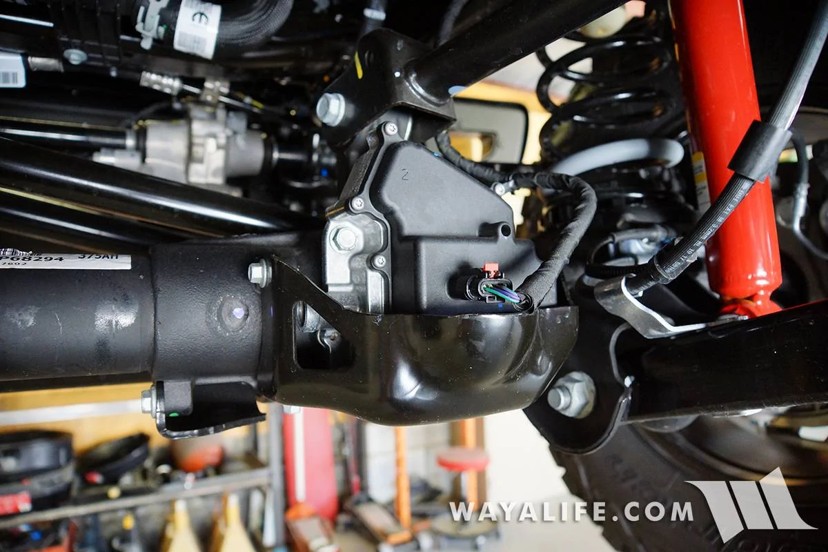

Check the plug going into the FAD unit on the passenger side of the front axle.
Try removing and reinserting it - that's an easy one to check that causes the SERV 4WD message. Other possible issues could be related to the selec-trac center diff in the transfer case but I'd say it's pretty likely it's something minor like this plug.
