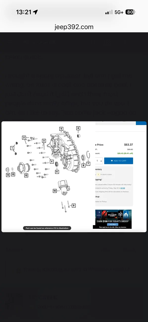

I had that problem on my 2021 392 with the full time transfer case. After it would set overnight it would go away. Once the light would come on I would have binding in the drivetrain. A couple of months later the light came on and the front wheels quit pulling. Most of the time it’s the electric solenoid on the side of transfer case. I finally got tire of mine and replaced the transfer case with an Atlas.

How do I check if it is the electric solenoid on the side of transfer case?
Is there a way to read hidden codes, as I just have a cheep OBDii reader?

Thanks .. I may just throw that part on...
It's likely under warranty.
