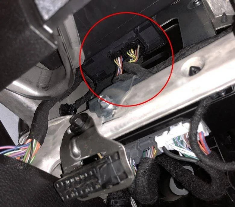

Ok these two connectors in the picture are unplugged and plug into the Tazer. If I use JSCAN I plug the two connectors into the ECRI module and the JSCAN bluetooth adapter into the OBD port. Are you saying with the two OEM connectors plugged into the Tazer, the ECRI module that the OEM connectors plug into is unnecessary?
Yes, the ECRI is unnecessary; your Tazer already allows you to use JScan via a Bluetooth adapter in the OBD-II port.
Doesn't the ECRI have other features though?

Well hell…thank you. I’ve been switching back and forth between the ECRi and Tazer modules needlessly then.
