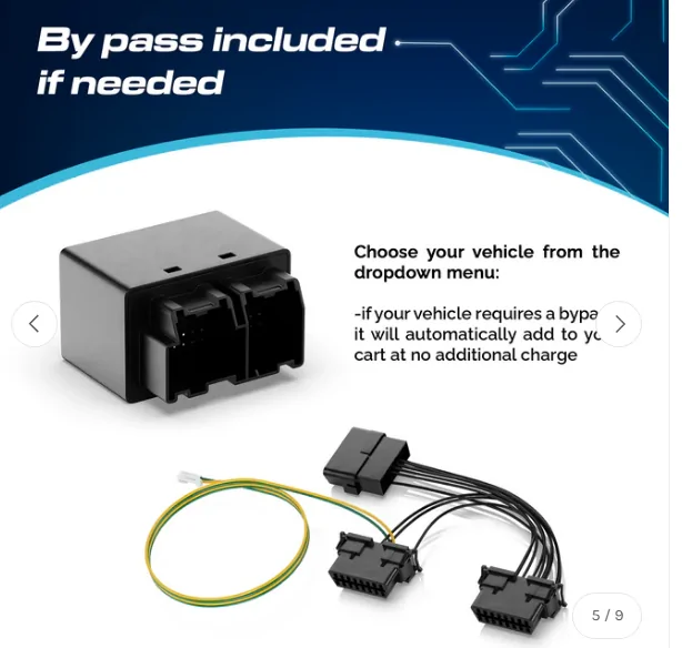

Theres a company called ZFlash that uses a permanent bypass with their ZFlash module. Don't know if they sell the bypass by itself. Bunch of us on our Volunteer Fire Dept use their stuff. They always send the correct bypass when we order.
Jeep Wrangler JL Permanent Security Bypass via OBD?? Screenshot 2026-05-01 163920
