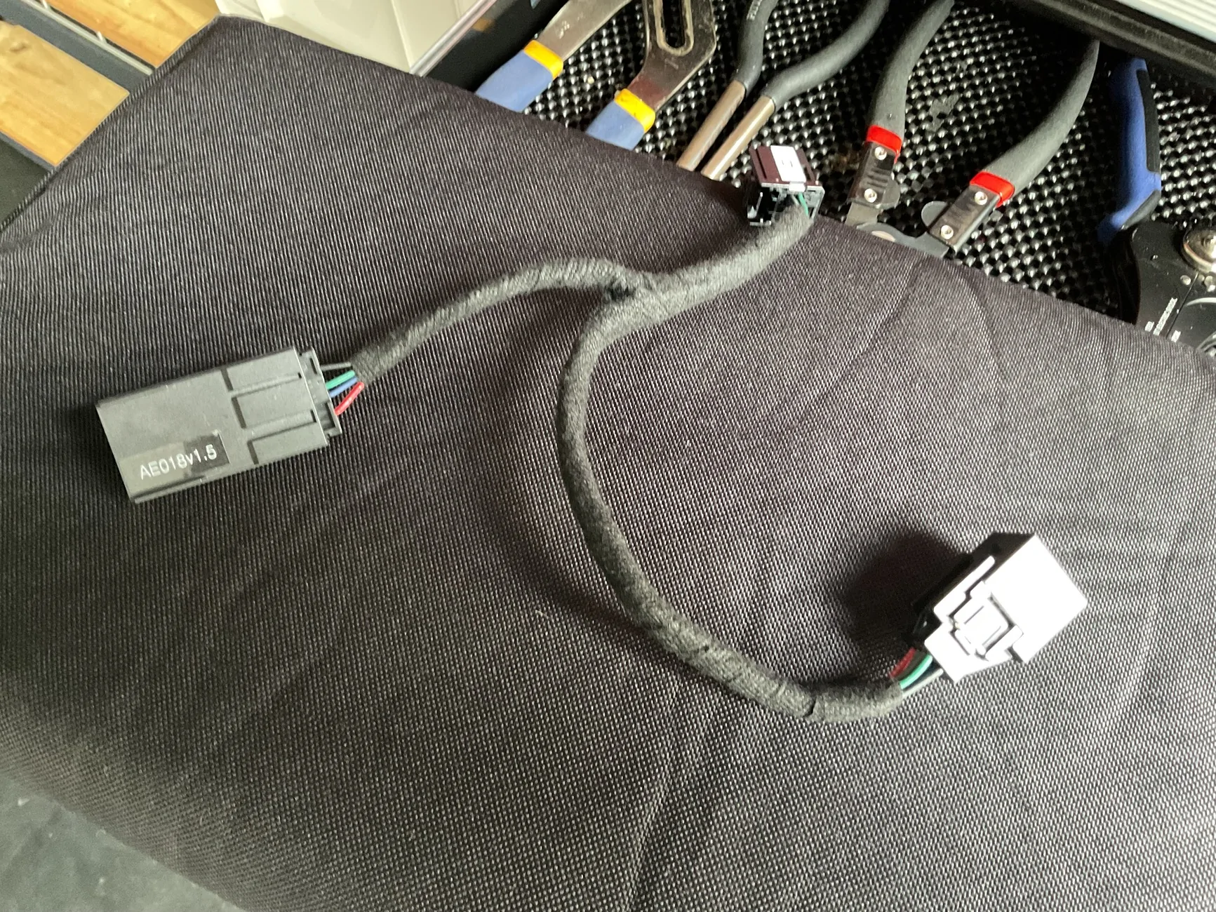

Hi all,
Does anybody have any idea what this is? I’m putting an extension on the security bypass for the JScan I have coming tomorrow for a bit of a road trip on Wednesday.

Unfortunately, I think the previous owner kept the module that makes it work.
One more question. I’ve only dealt with AEV procals in the past. Never used a JScan. Do I just leave this extension plugged in and it takes the place of the security bypass cables being plugged into their normal spot?

There’s not a module with it, that’s all of it. It just remembers what your last selection of the Stop/start button was on restart. As to the 12+8 cable you can leave it as is or plug the SGM back in.
Auto Stop Eliminator
Gregj
Cool! Thanks Greg.

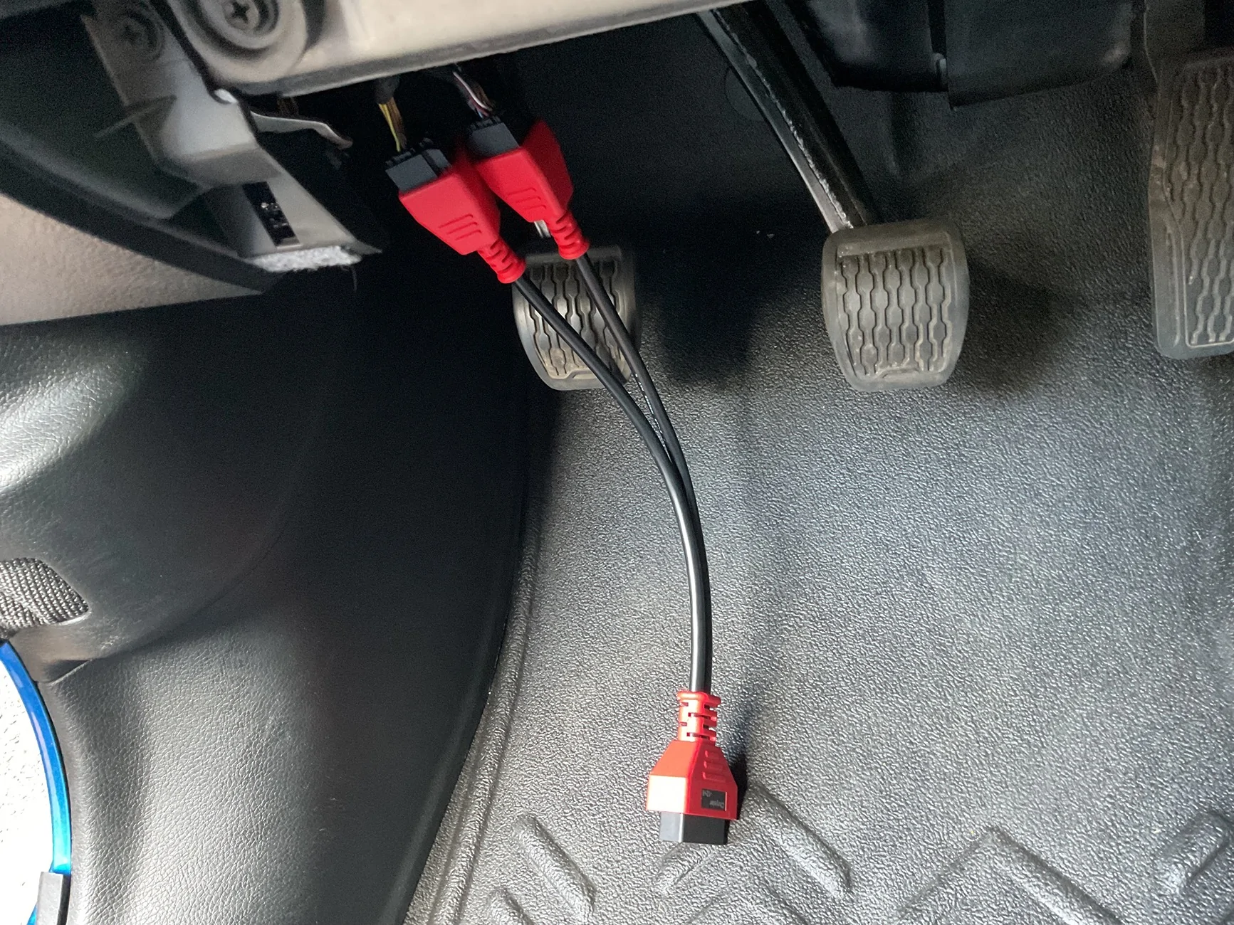

I use SGW extension cables so the disconnect point is above the brake pedal. I only use the JScan adapter when using JScan. My hands don’t fit where the cables connect to the SGW, so it was usually a bloody experience when disconnecting the cables. I really hate the SGW design and placement. I was considering an AEV Procal if the wiring results in a fully functional OBD2 port.
