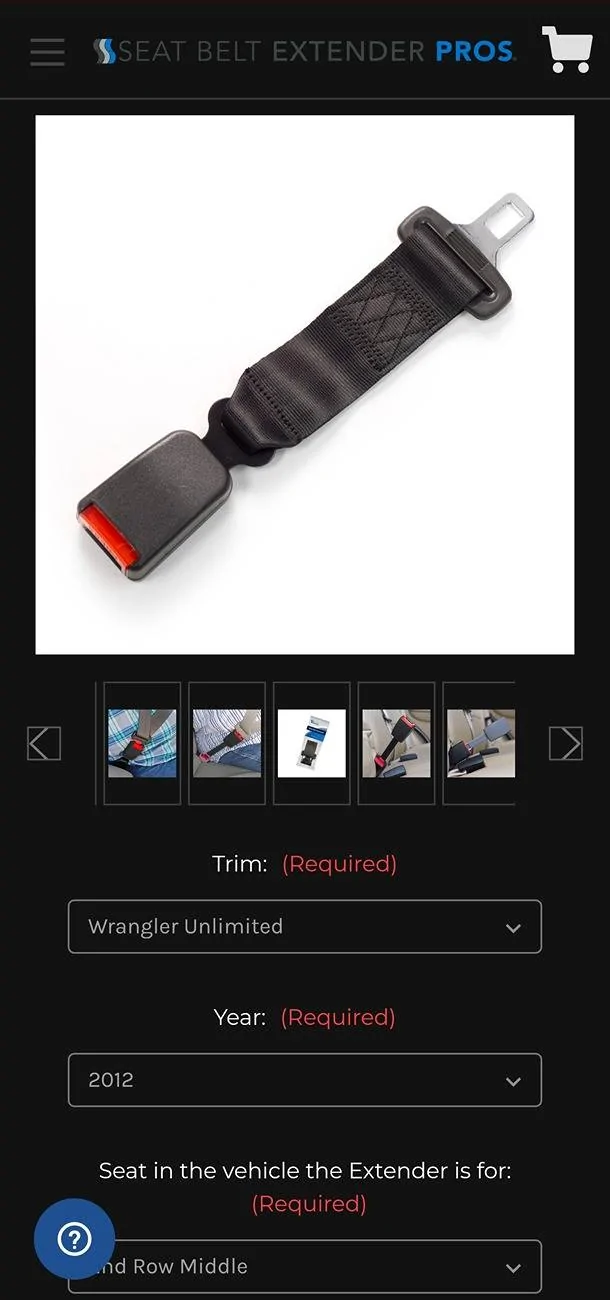

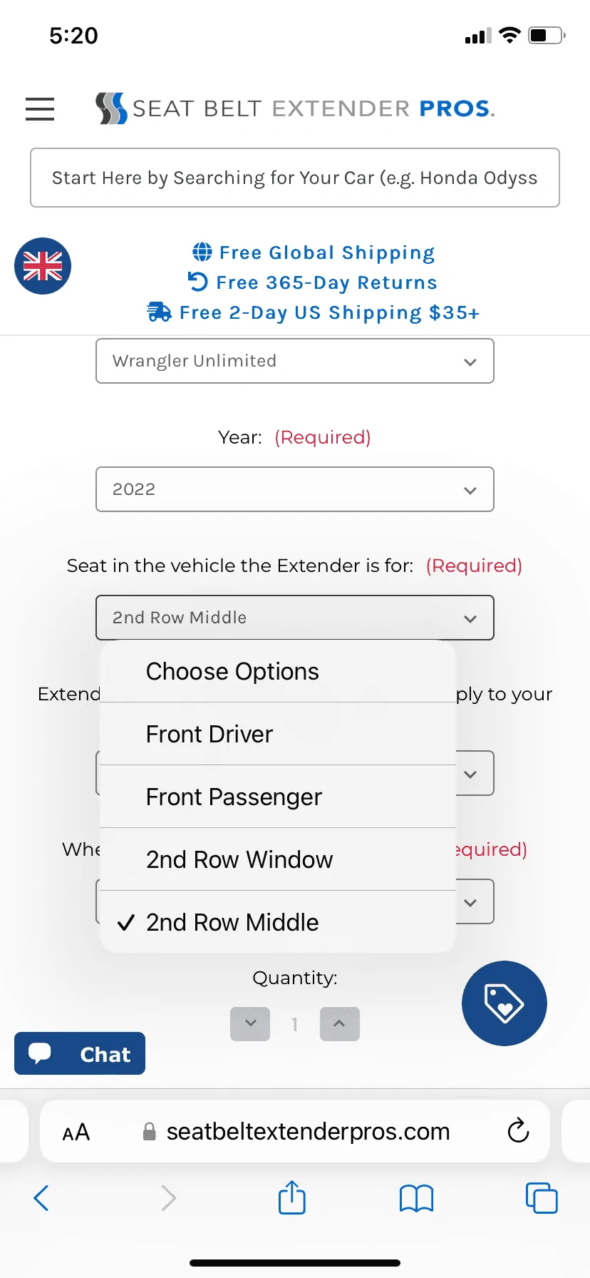

They have the middle one on the 2022, assuming it’s the same for yours.

Did their extender end up working for you? I am looking for the exact same thing, and can’t seem to find the right kind of buckle on Amazon to match the center rear. Which, WHY DID THEY MAKE IT DIFFERENT TO BEGIN WITH?! Ugh…

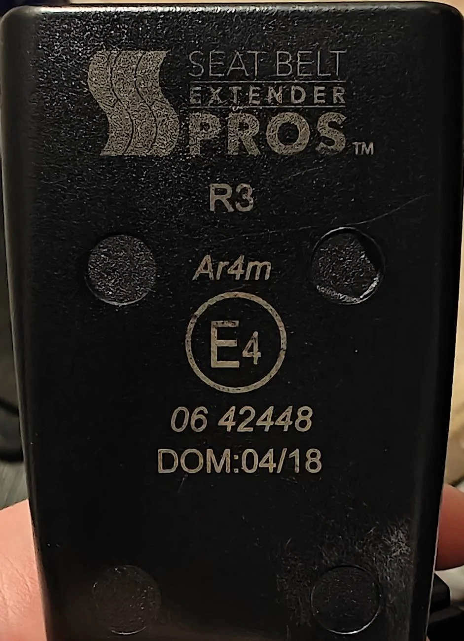

this is good advice because some that look fine on Amazon turn out to be flimsy and poorly made out of bad materials: thin metal badly chromed, poorly molded plastics, notchy action.
I learned this a bit late by having to send back a few I bought from Amazon. They all fit fine in the OEM buckle because that's just a shape thing, and it's easy to choose the right shape. A poorly made extender is fine if all you want is to turn off the chime. But if you want to plug a seat belt into it and have it hold you in place during a collision, you want something well made with the same testing they do with OEM seatbelts, such as the E4 certification this link mentions.

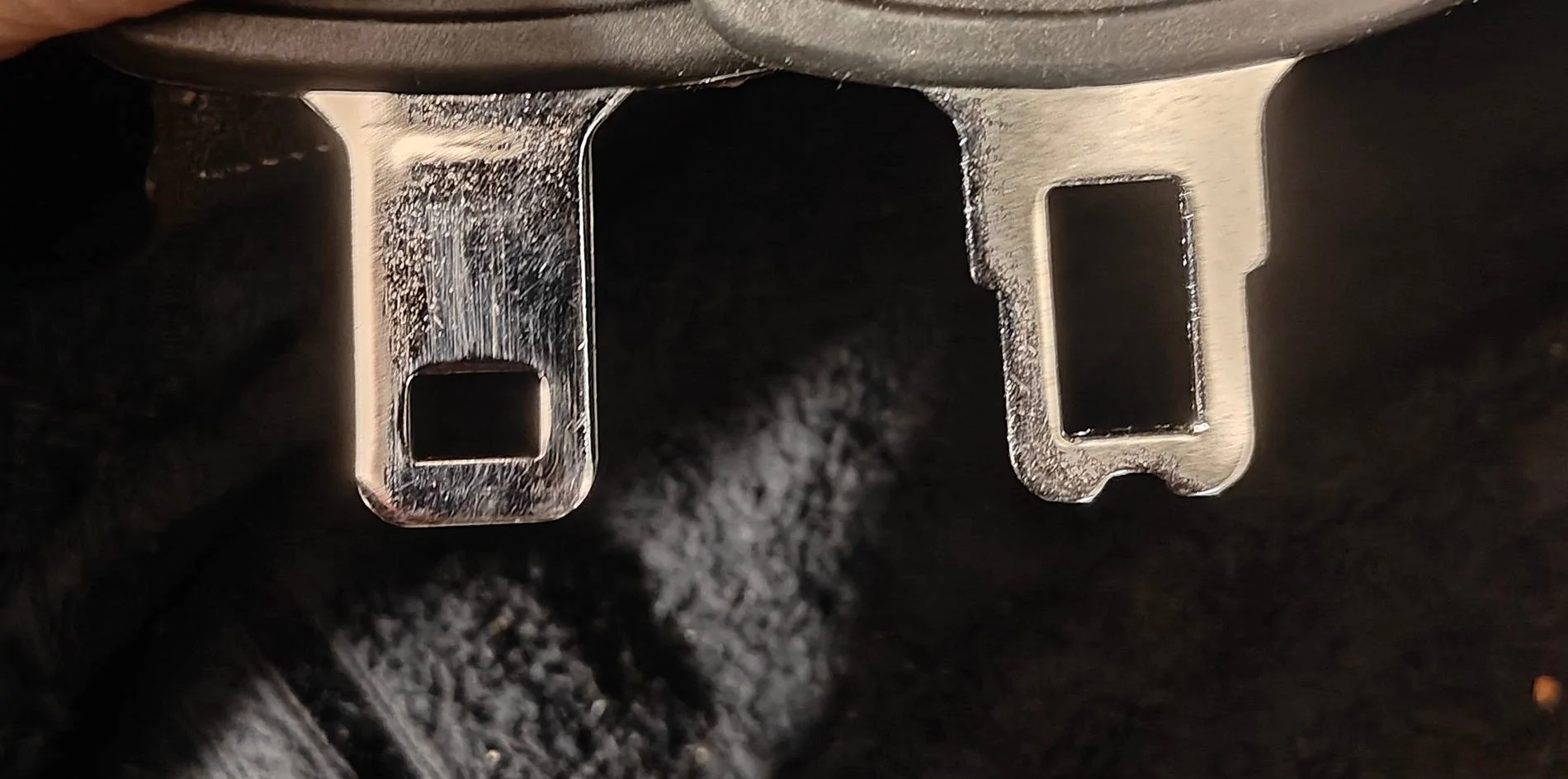

I know this is an old post. This same problem has been bothering me as well. Until today, I had to reconsider putting the youngest child in the middle seat to separate the two older children who were fighting like cats and dogs. I compared the other seat belt buckles with this middle buckle to try to understand what the difference is and why there is no suitable extender on the market. Here is a comparison of the side buckle and the middle buckle.
Jeep Wrangler JL Seat belt extender? IMG20241013154615~2
When I found the old JK seat belt extender in the drawer, I found that the middle buckle can be inserted into the old JK extender slot. It turns out that the second row center seat belt buckle of JL is a modified JK buckle. Use a file to narrow the sides of the JK buckle extender and make a small semicircular hole on the head. It works! Hope this can help others who have this problem.

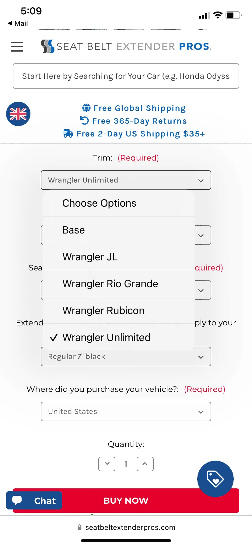

I got mine from Seat Belt Extender Pro, but I had to message them directly with my Wrangler’s year and trim. They didn’t list it on the site, but they sourced one that fit the rear outboard buckle. The seat belt extender made it so much easier for my kid to be independent again.
