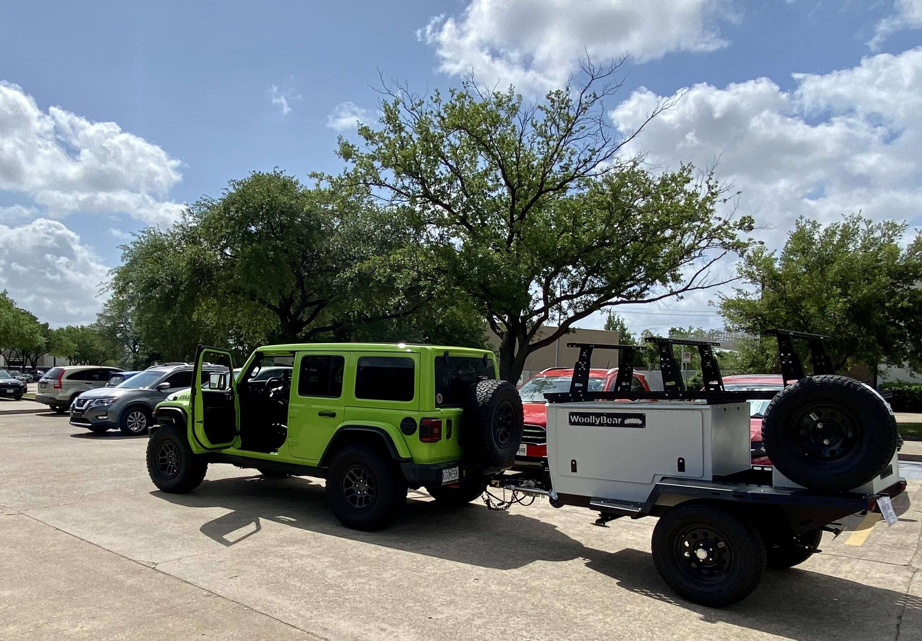

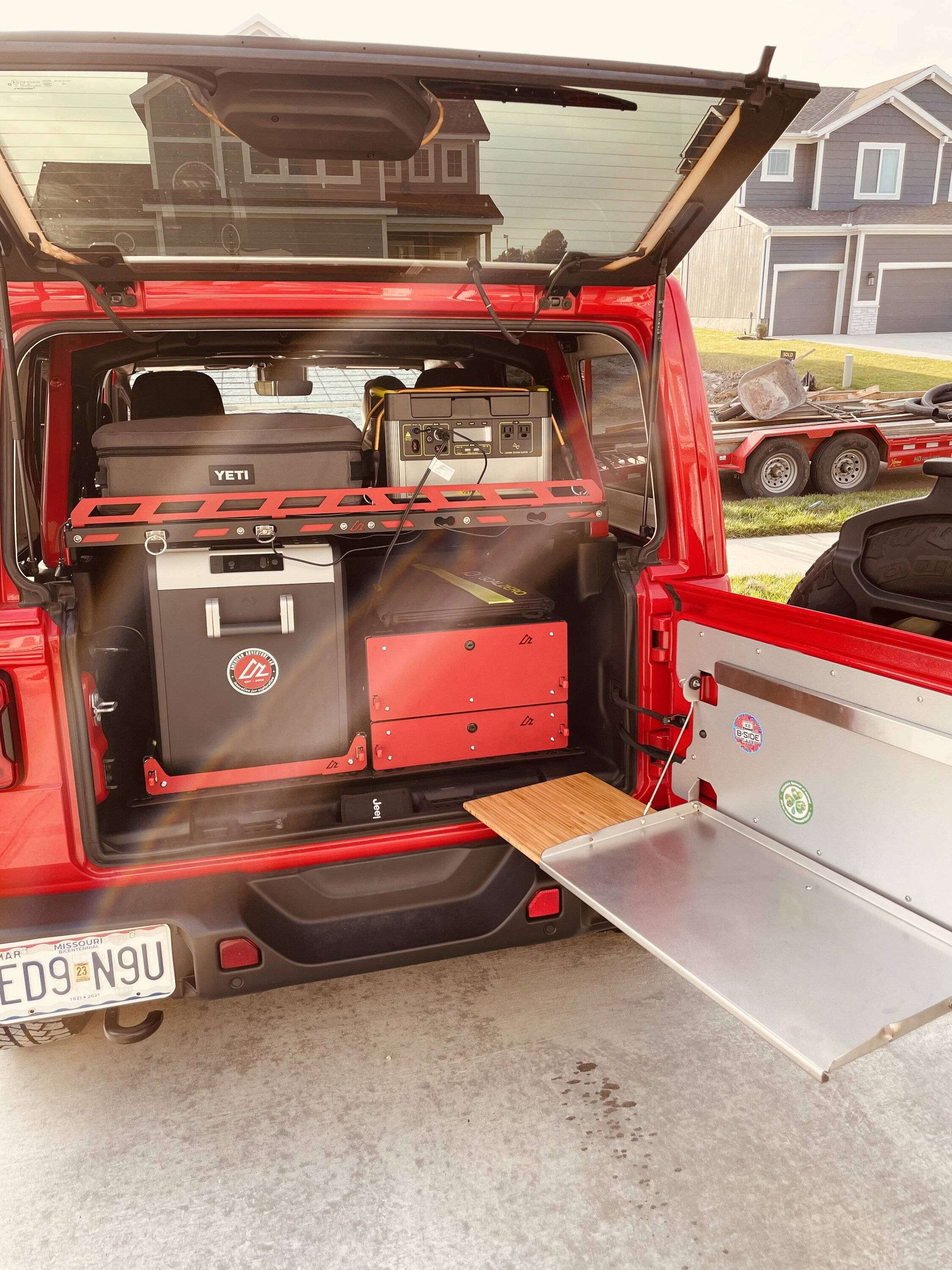

Any advice for this? I have a 21 Rubi Recon package with the stock suspension. I’ve added a shelf, drawers, and fridge slide from American Adventure Labs in the back which has added some weight (can’t find any details on how much that has added with a quick search of their site). The picks from the red jeep is what I have…I just moved it to the green jeep. I also pull a Taxa Woolly Bear with a tounge weight in the 150 pound range. What would be the best way to reduce my rear end sag? I have some without the trailer, but quite a bit with it.

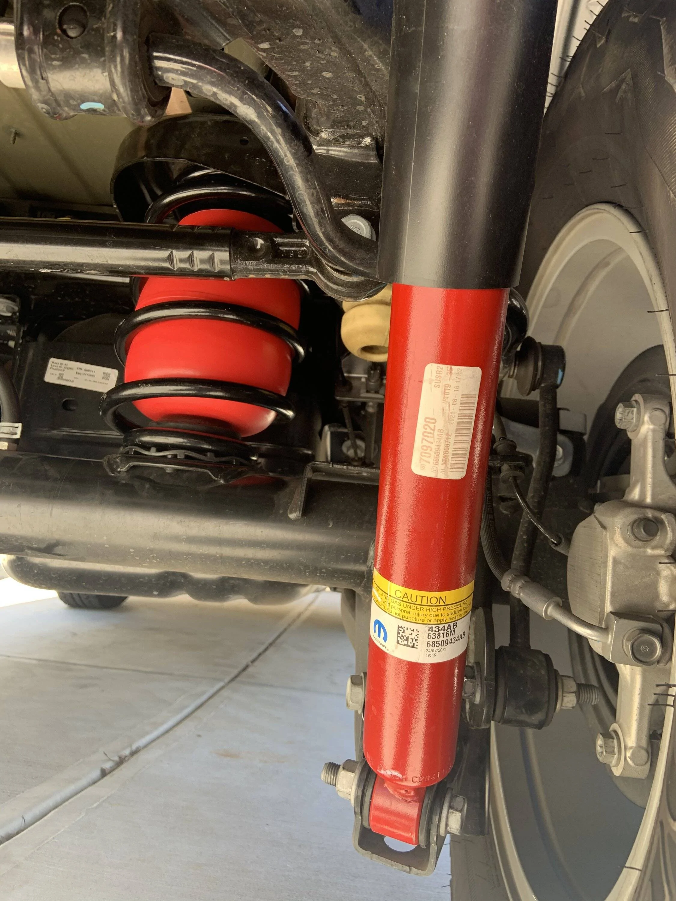

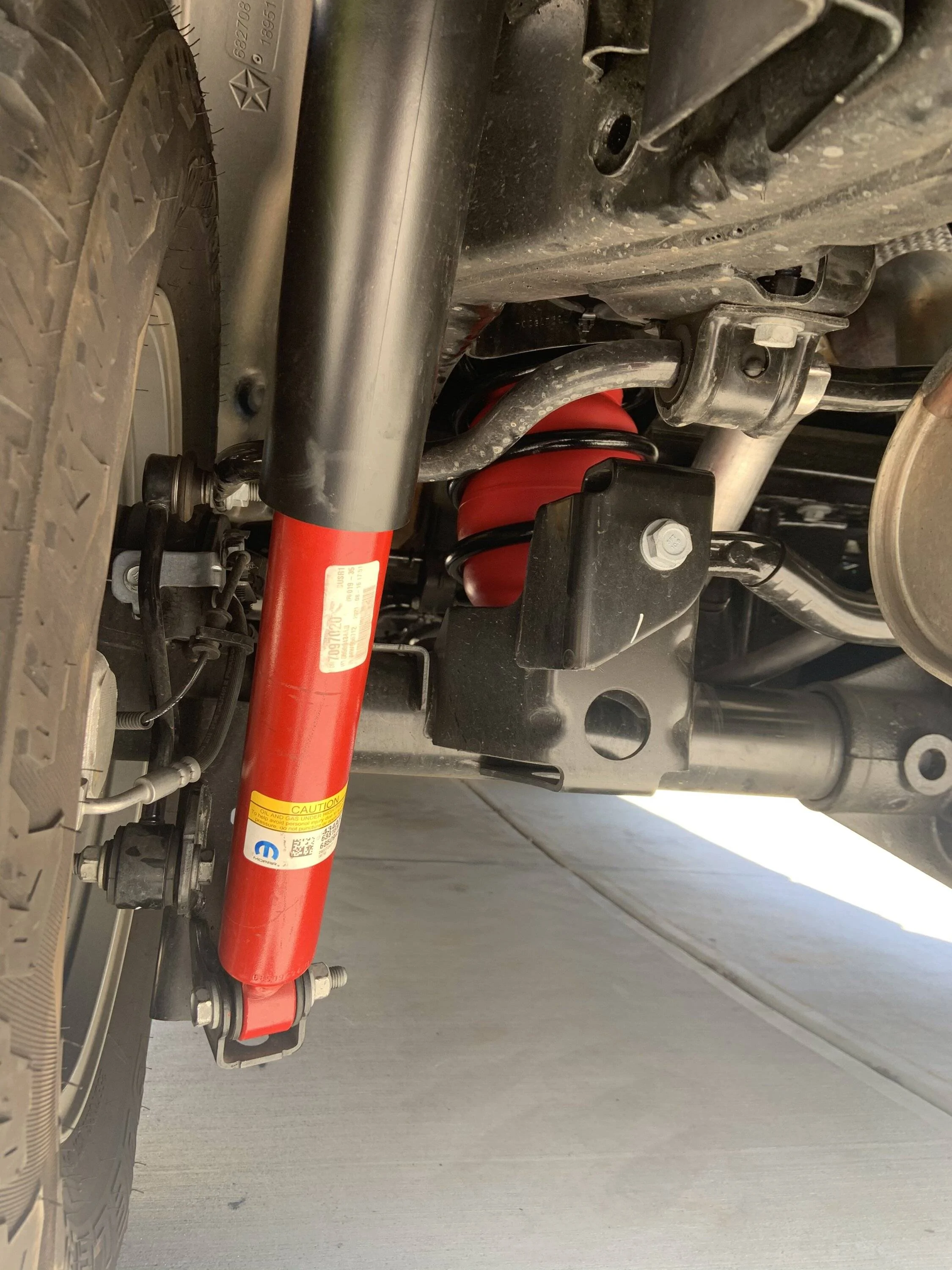

I have them on my Jeep and like them so far. Not expensive and only took me a few hours to install. Im also pretty sure the bags have a lifetime warranty.
The only use I’ve really had is with a few hundred pounds of mulch from Home Depot and they held up well. I ran separate lines so they can be inflated independently, but you can connect them together and use only one valve.
Im picking up a pontoon this or next week that is about 2800 pounds with the trailer, so that’ll be their first real test.
I have an ARB compressor under my brake booster to make inflating super easy.

Yep. They’re kind of a pain to put in the hotdog shape to squeeze between the coils, but just jack the rear end up so the rear axle sags a bit and expands the springs.
