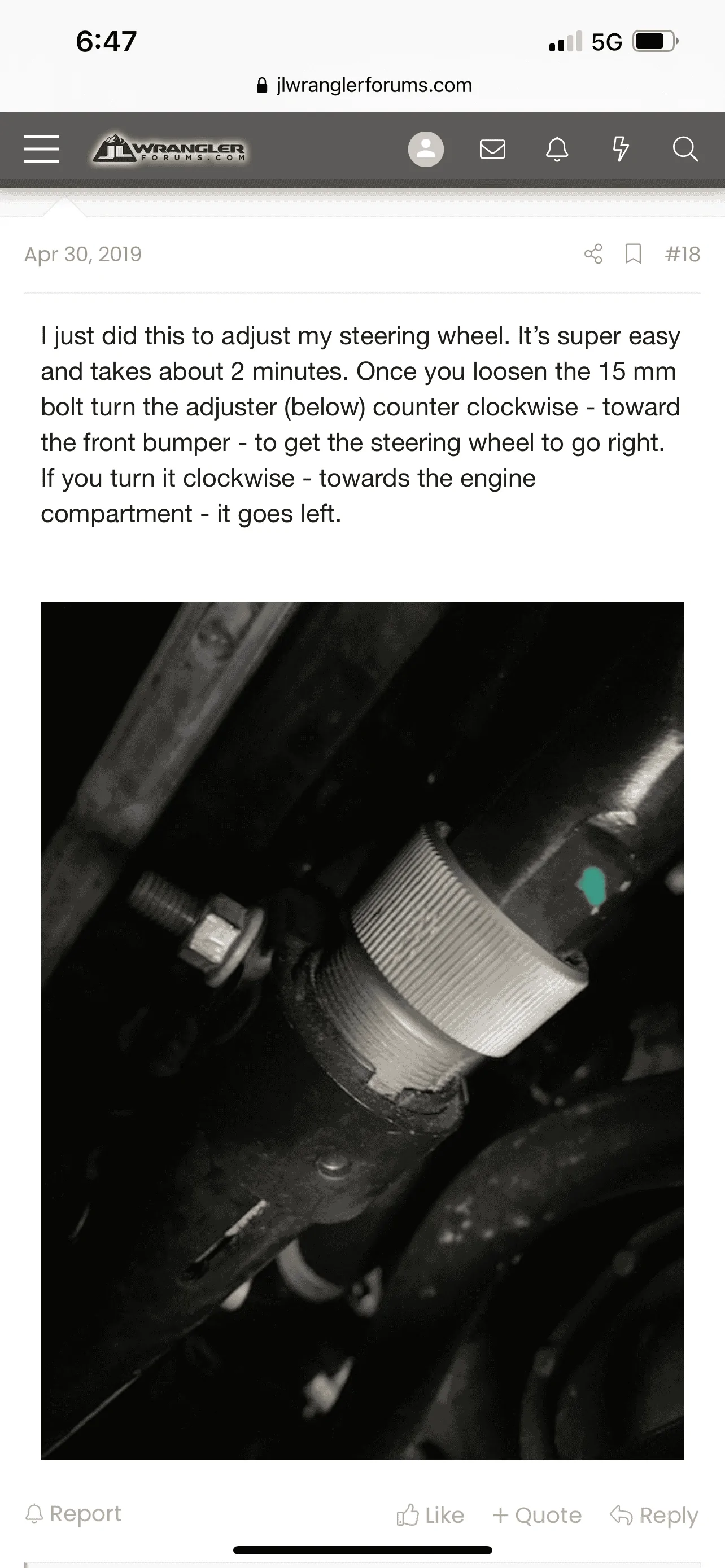

If you have tools you can definitely try adjusting the steering wheel to your liking yourself. Here is a screen capture I have saved on which direction to turn the sleeve to turn the steering wheel left or right.
I second this, Jeeps are not like your standard IFS car that can have a million different alignment variables to adjust and screw up. There's almost nothing to a solid axle front end. Just loosen the one bolt, screw the silver part a little at a time and keep checking your steering wheel for proper center.
