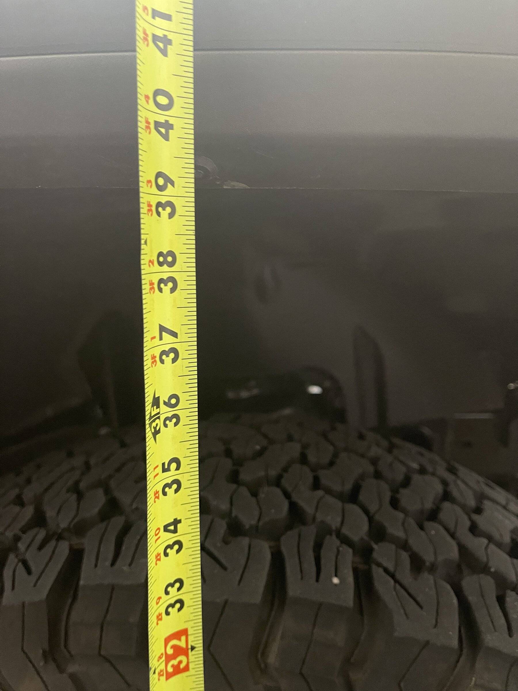

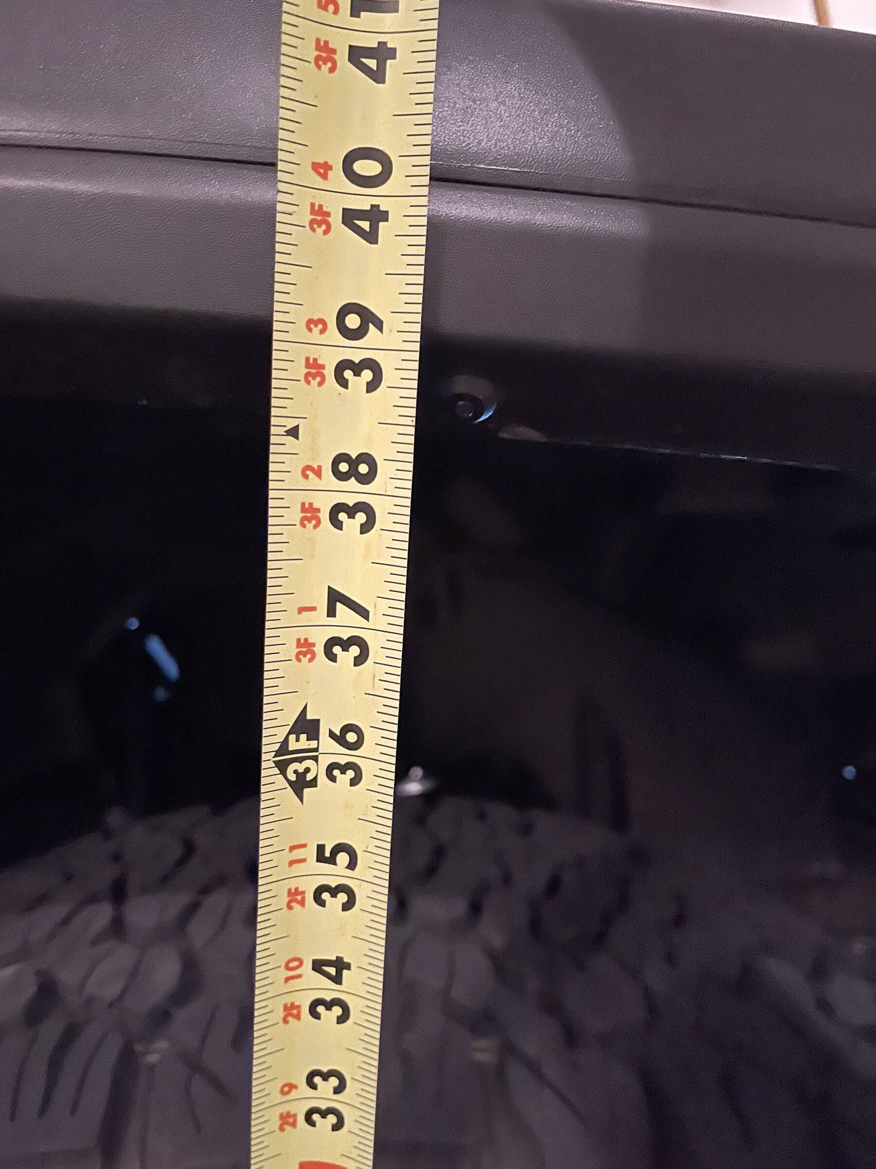

I just installed the apex badlands 12k with rockhard winch plate on my steel bumper. Sags .75” in the front now… rough country .75” front coil spacer on order now
Before
Jeep Wrangler JL Sag when installing bumper and winch on 4XE? DD80481D-BA44-4371-8419-CD8864E651D9
After
Jeep Wrangler JL Sag when installing bumper and winch on 4XE? FB86110C-47DC-4422-BBFE-A3D951726D98
