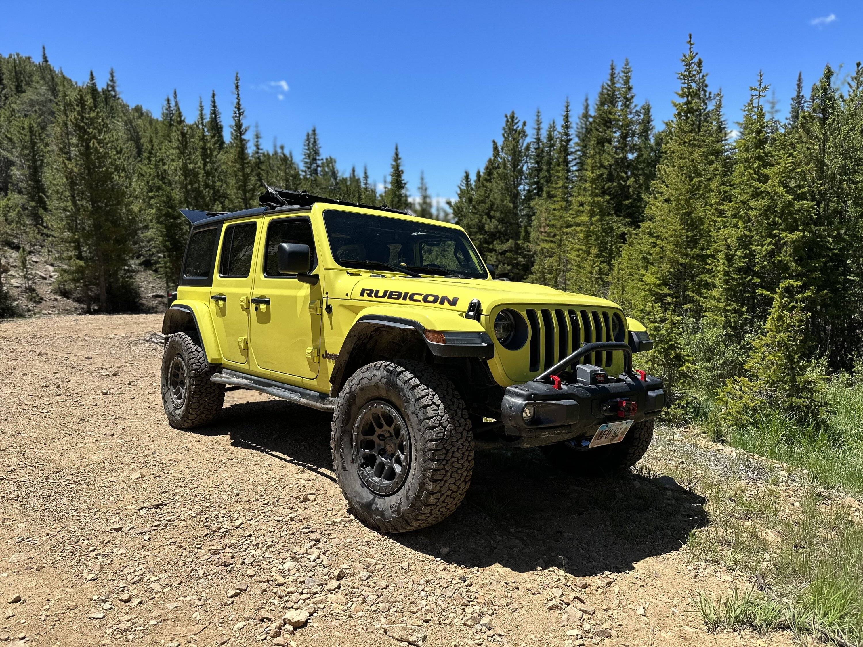

Mine came from the factory with the front steel bumper and had a bit of rake to it already. I added a Warn Evo winch which dropped the front a bit more. I went with the Terraflex 1.5" leveling kit. With a average tool bag in the back and a full tank of gas, It sits perfectly level when measured with my good eye;
